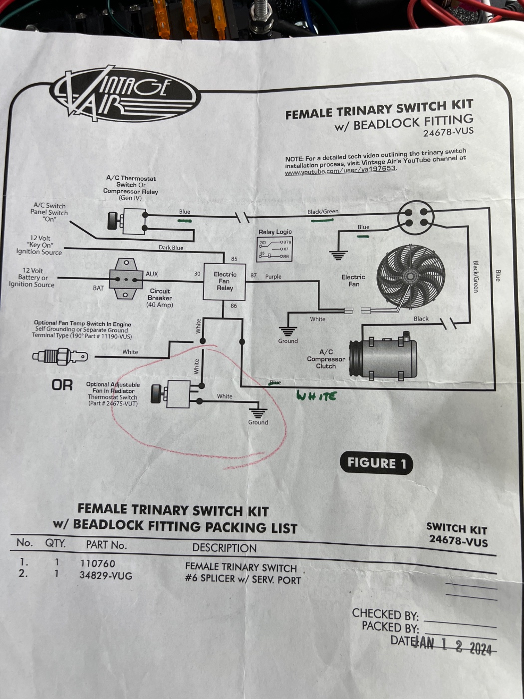

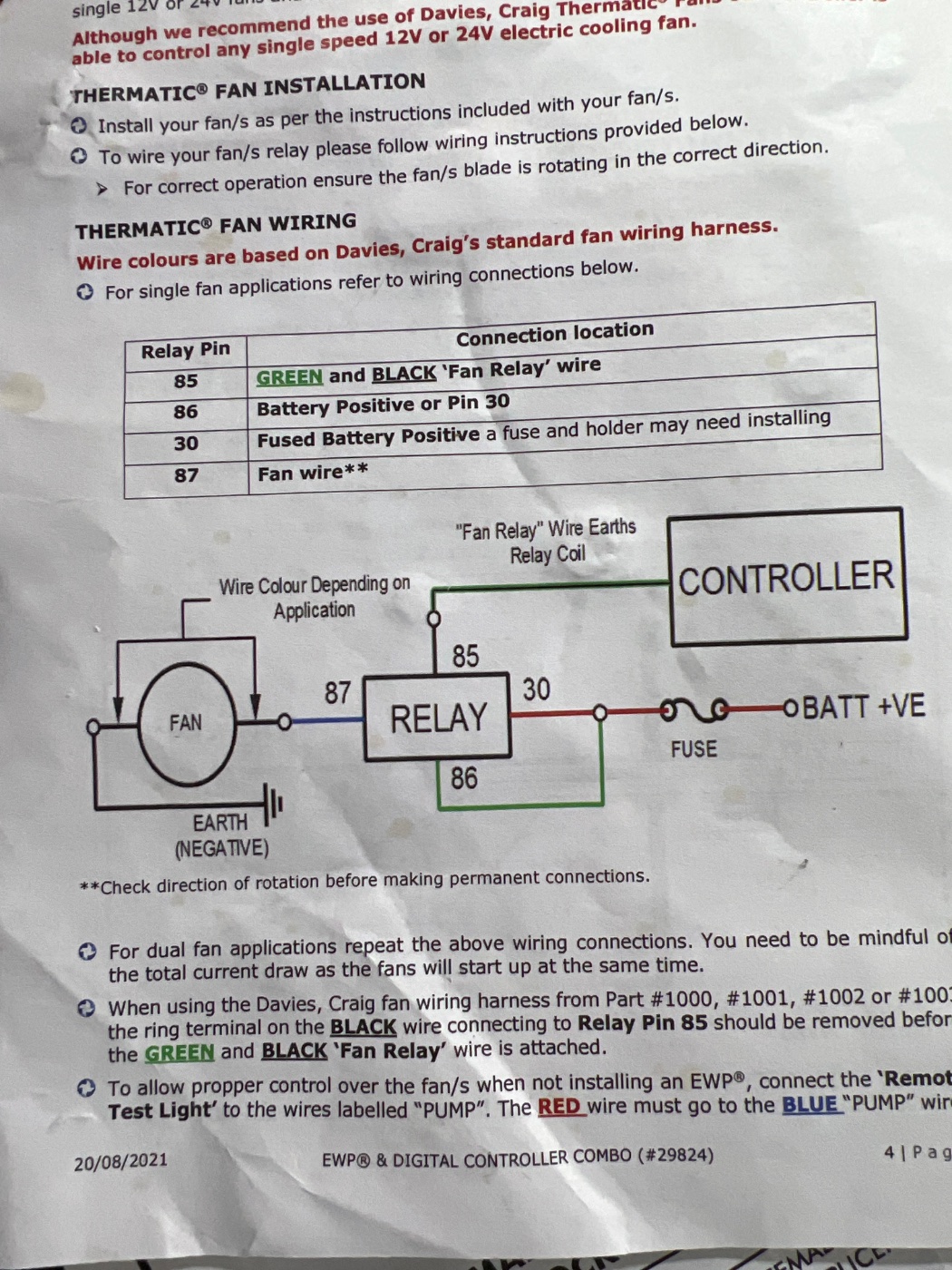

Wiring question:
The Davies pump uses ground to activate the fan relay. This uses pin 85. They suggest jumping pin 86 to 30. Which brings 12 volts thru pin 86
The problem I’m having is the diagram for the vintage air wiring uses 12 v thru pin 85 and I think ground is 86 via the trinary switch.
How should this be wired? Should a second relay be used and run them in parallel?

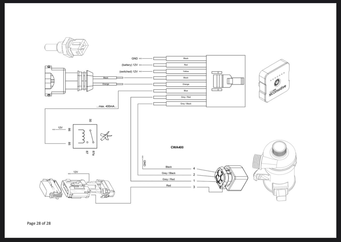

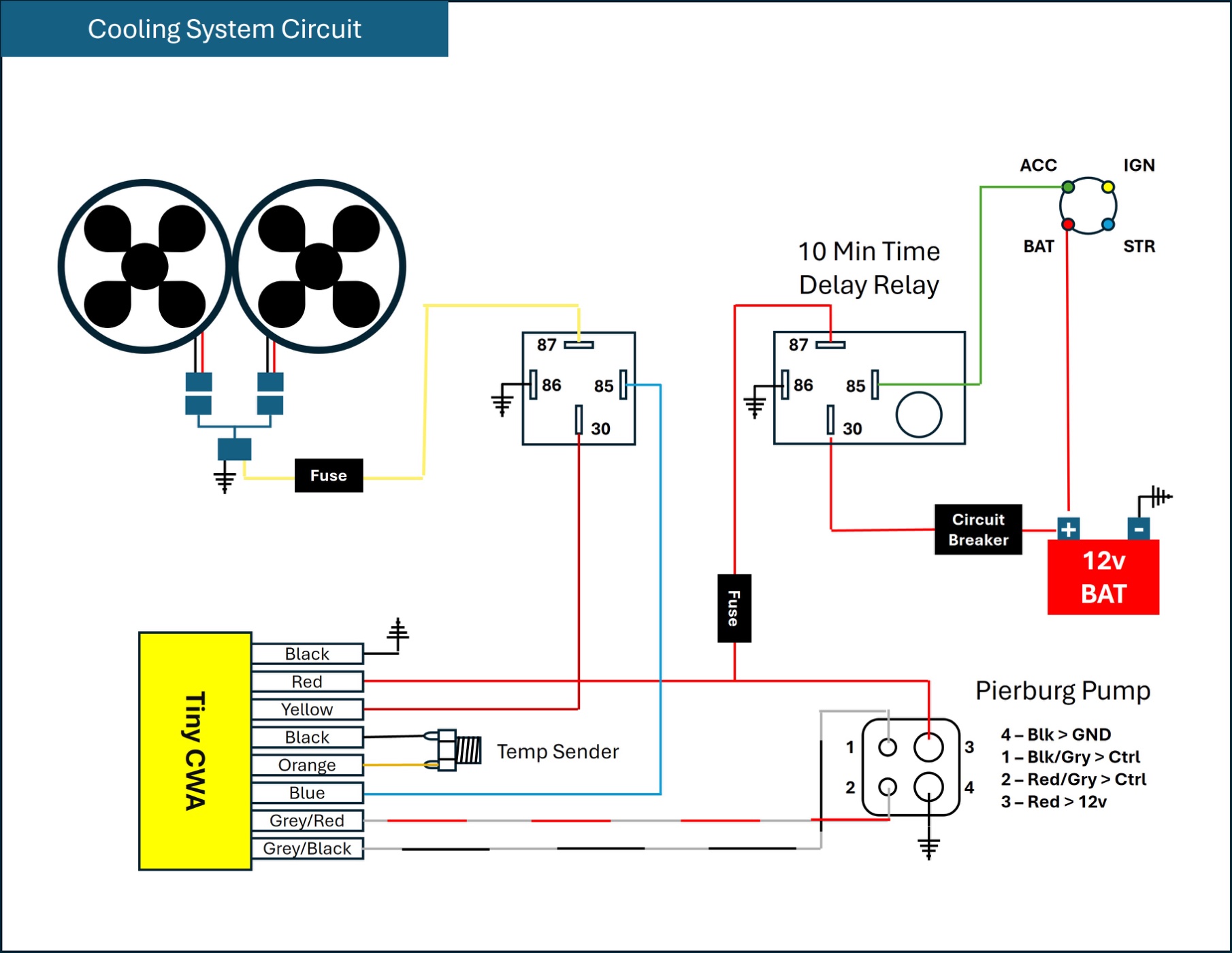

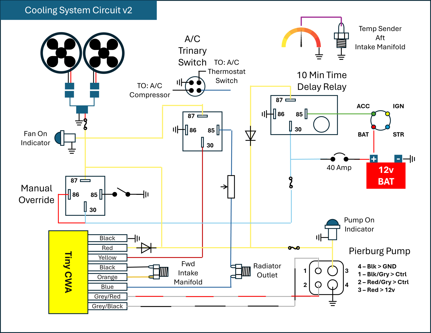

I have been trying to figure out the EWP coolant system electrical setup. Below is my first attempt. I am not any sort of wiring wizard so there are bound to be issues or concerns.
I am using the Pierburg CWA 400, the TinyCWA controller from Techmotive and a relay with up to a 10 minute delay to keep the system running after the car is turned off.
The fans will be turned on and off by the TinyCWA controller, but when on the highway, I would like to override the controller and turn the fans off since there should be plenty of air coming through the radiator.
My thinking is to put a thermo switch at the output of the radiator that will cut power to the fans when the coolant is cooled sufficiently. I don’t know what that temperature is.

Ian Clark
Hi Randy,
Have you checked in the instructions for hi/low temperatures settings for the fans? If so (most likely it does) then you have no need for a fan off over ride switch.

Ian,
Thx much. I am new to EWPs and rear engine cars with the radiator up front so please bear with me. I don’t know where the high/low temp reading is coming from that you referenced. I am guessing a temp sender in the intake manifold. If so, then I assume the fans will run when the engine is hot regardless of how much cooling is done by ambient air at the radiator. If there is a temp sender on the radiator, I am guessing it is located in one of the radiator’s side tanks. That water should also still be hot. My thinking is to place the sender on the output since this should be after the water has been cooled by the radiator.
Howard Jones

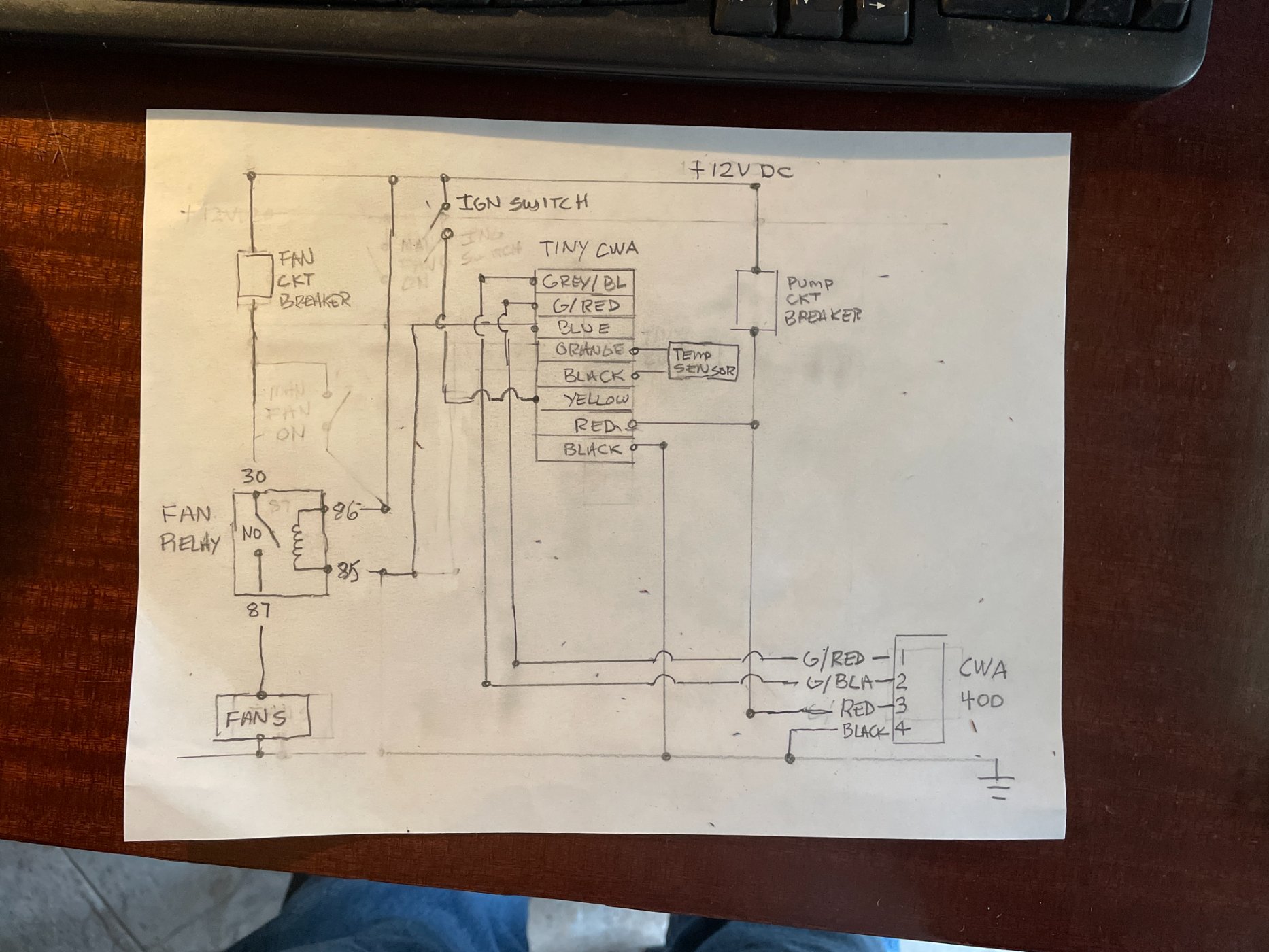

My advice would be to put all the temp sensors in the intake manifold. The coolant temp target is the coolant temp at the hottest location in the complete system. That's the top of the engine, heads, and by extension, the intake manifold.
The fan on temp would be selected to be about 10F above the system target nominal temp. So if you wanted the coolant in the heads to be 185F, for example, then turn on the fans at 195F and have them go off at 175F. This way at normal running speeds airflow will keep the coolant at the target temp (185F) and the fans will not come on.
I would like to see an override switch so that the fans can be manually turned on at the drivers discretion. Lots of good reasons for this. I also think it would be best to split the protections between the two main loads, The fans and the pump, separate the circuit breakers of each, Power the controller of the pump from the pump circuit breakers, and the fans from the fan circuit breaker. Place your override fan switch in the fan relay control circuit.
I'll read up on the tiny controller a bit and see if I can draw you a circuit diagram for the whole system.
Ian Clark
Hi Randy,
The Hi\Low temperature setting is a function of the Tiny Waterpump Controller and responds to the temperature input from your sensor(s) on the engine, radiator.
Additionally the A/C pump relay can to trigger your rad fan relay. It does help the cooling system to stay ahead of engine temperatures due to low air flow through the radiator, much like an override switch would do if you were stuck in traffic with A/C on.
On re reading my reply above, and in agreement with Howard, a manual override is required. Modern production cars don't have one but the original GT40s did.

I left out the run on controller. If you have a manufacturer document on it I can look it that and include it if you like and it will work. Frankly, I don't think you need it. Just let the car cool down a bit before you turn it off.

Randy Folsom

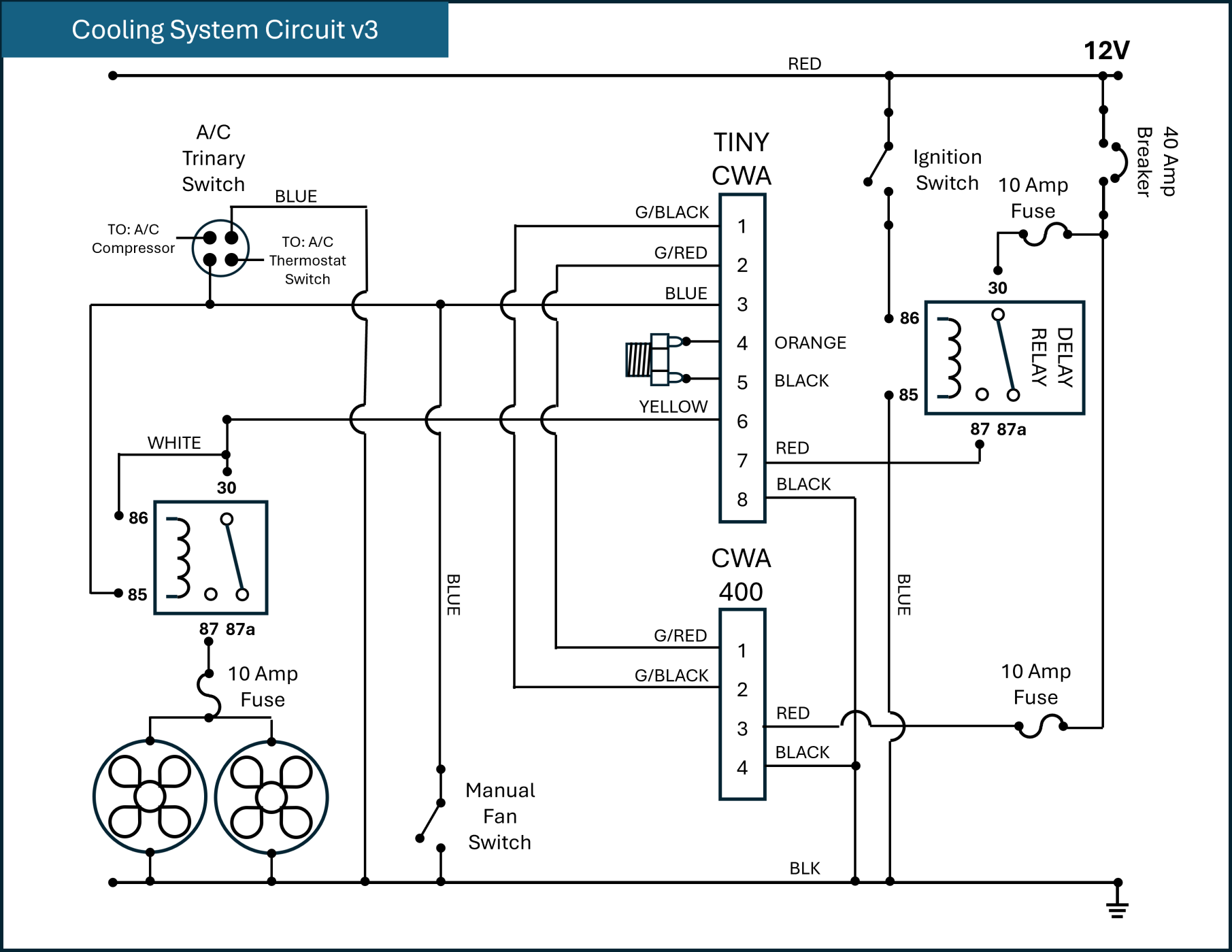

I updated my Cooling System Circuit diagram before I saw John Howard’s drawing so will likely update it again.
I added the A/C Trinary switch, pump and fan indicator lights, manual override, and radiator outlet temp switch with a potentiometer. The Tiny CWA has to go to Pin 85, while the delay relay and manual override go to Pin 86, so needed to add another relay.
The primary temp sensor is the one on the manifold connected to the TinyCWA controller
The overrides that force the fan on are the A/C Trinary switch and the manual override switch.
My hope is that the radiator outlet switch will only cut off the fan when the A/C is not running and the coolant temp coming out of the radiator is low enough to not need the fan, i.e., driving on the highway on a cool day. I will likely move the radiator outlet temp sensor as described by John Howard.
For sure John Howard’s diagram is easier to follow :)

Wiring question:
The Davies pump uses ground to activate the fan relay. This uses pin 85. They suggest jumping pin 86 to 30. Which brings 12 volts thru pin 86 View attachment 144407
The problem I’m having is the diagram for the vintage air wiring uses 12 v thru pin 85 and I think ground is 86 via the trinary switch. View attachment 144408
Not an expert, but my understanding is it doesn't matter if 85 or 86 is grounded. Likewise 30 and 87 are interchangeable. Convention is grounding 85. Some signal inputs are positive voltage so if you're trying to stay with the conventional pin 85 input, then 86 is ground, but you can just as easily connect your positive input to pin 86 and use 85 as ground. Not sure what to recommend, but I suspect there are standards to make future trouble shooting possible.

Randy Folsom
Another attempt. I used John Howard’s drawing as a starting point. This one is a bit less complex. I have not figured out how to turn on the water pump without going through the controller. I think need to apply 12v to the grey/red and ground to the grey/black wires on the pump. I am going send an email to Technomotive. I also did away with the idea of a separate circuit/temp sender to turn off the fans. I think it best to rely on the controller. I still need to add the status indicator lights.
