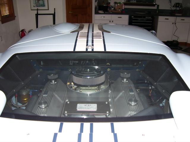

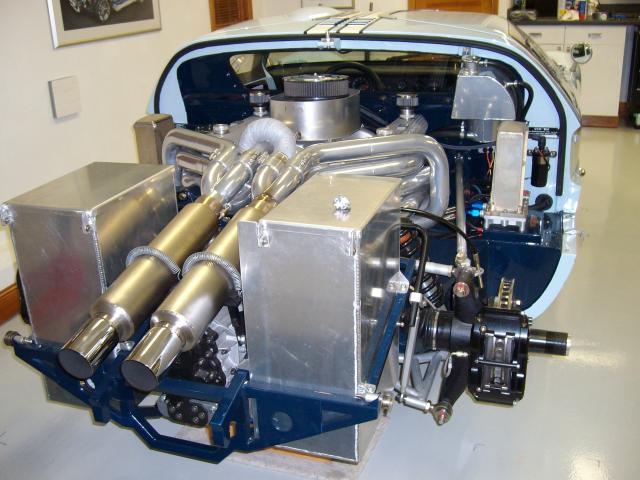

I like the way the full sized engine fills out the engine/transaxle bay.
Shelby aluminum 427 FE (now 481ci)
