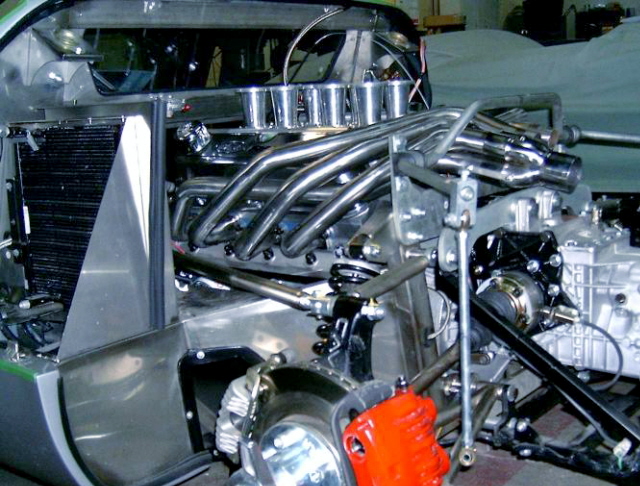

The biggest cause of your clearance issues is the Getrag transaxle. It requires the engine to sit higher as the input shaft on the transaxle goes in above the diff rather than below as in the ZF application.
On our 302/347 Weber or 8 Stack EFI units the heat sheild doesn't protrude through the rear deck so no clearance issues.
Of course changing to a ZF is a tiny bit more costly than sanding off some material:) Car looks fabulous BTW.
Here's a pic of a 347 EFI/ZF sitting at correct height. Sorry I don't have a pic of it with a heat sheild on but you can clearly see how much lower the engine is in the car. Food for thought...
