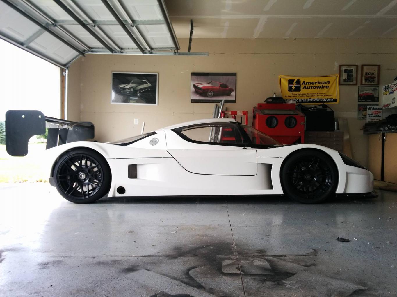

ACK!! I just noticed the rear-suspension has sagged a bit since I last set it.... SON OF A DIDDLY!

Hey Eric, Love the video, nice job. Yes the sound protection for the drivers compartment will make things much nicer. When you were autocrossing I heard some scraping. Was that your tires in the fender wells or your front spoiler? At least you didn't hit any cones......
That was the front spoiler, I had the RF coil-over log collar come loose and it was maybe 1" off the ground. I fixed it in later runs.
Other than that, the car performed well. I have some issues to work out, which is pretty standard with any build of any car... testing, refining, testing, tweaking...testing... etc...
