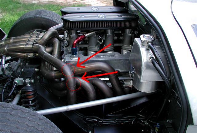

Currently building headers...
Out of interest, when you have pipes passing within 1-2mm of each other, is it better to route them to the point of touching each other and weld them together? Or leaving them apart.
I might add that there is no room to separate them any further...
The pic shows an example, however my layout is giving 1-2mm clearance between similar pipes.
I would leave them separate, as the tubes need room to "move" as they heat and cool. Welding them together(especially at one tiny point) could lead to cracks.
That's what I would do............
Dave d.
I agree with Dave...
