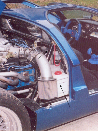

Here is a picture, although the expansion tank is somewhat hidden behind the roll bar brace. The "puke tank" is rather obvious. Some tracks insist on these puke tanks, btw. Anothere thing that is not real clear in this is the bleeder valve just above and to the left of the header tank (swirl pot.) There is a line that comes off of the intake manifold, rises even higher than the tank, connects to a brass bleeder valve and then connects to the line coming from the top of the radiator before dumping back into the header tank. I believe that this releases a lot of air that would otherwise be trapped during the fill.

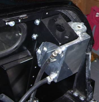

Thanks all for your posts, Following your input, I had a small tank made locally.
We enlarged the size of the GTD filler pipe from 1/4" TO 5/8" and also put a connection in the tank for the bleed tube from the top of the radiator.
There is also a connection for a puke tank, but I haven't decided where to put it yet.

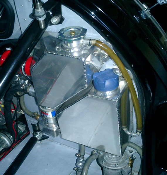

Rob,
The Header tank came from the factory (Bailey Edwards Cars) and I had the overflow tank custom made to match.
Rob
I figured..... Looks to good to have been purchased.
Nicely packaged..well done.
Ron,
The header tank (upper/left tank) is pressurized and when the coolant expands it overflows to the bottom of the expansion tank (lower/right).
car guy said:
Ron,
I understand that, but, you have a fitting off the bottom of the header tank that is pressurized and I was wondering where you teed it into - outflow from block, inflow from block, water neck bypass, etc.
Ron
Ron,
Sorry, I misunderstood...you wanted to know how I plumbed the header tank not the expansion tank.
My header tank lower hose tees into outflow from block, the upper hose comes from the back/rear of my intake manifold (I drilled, tapped and plumbed the intake to allow any possible steam to bleed-off so as not to block coolant from flowing). I hope that is now clear.
