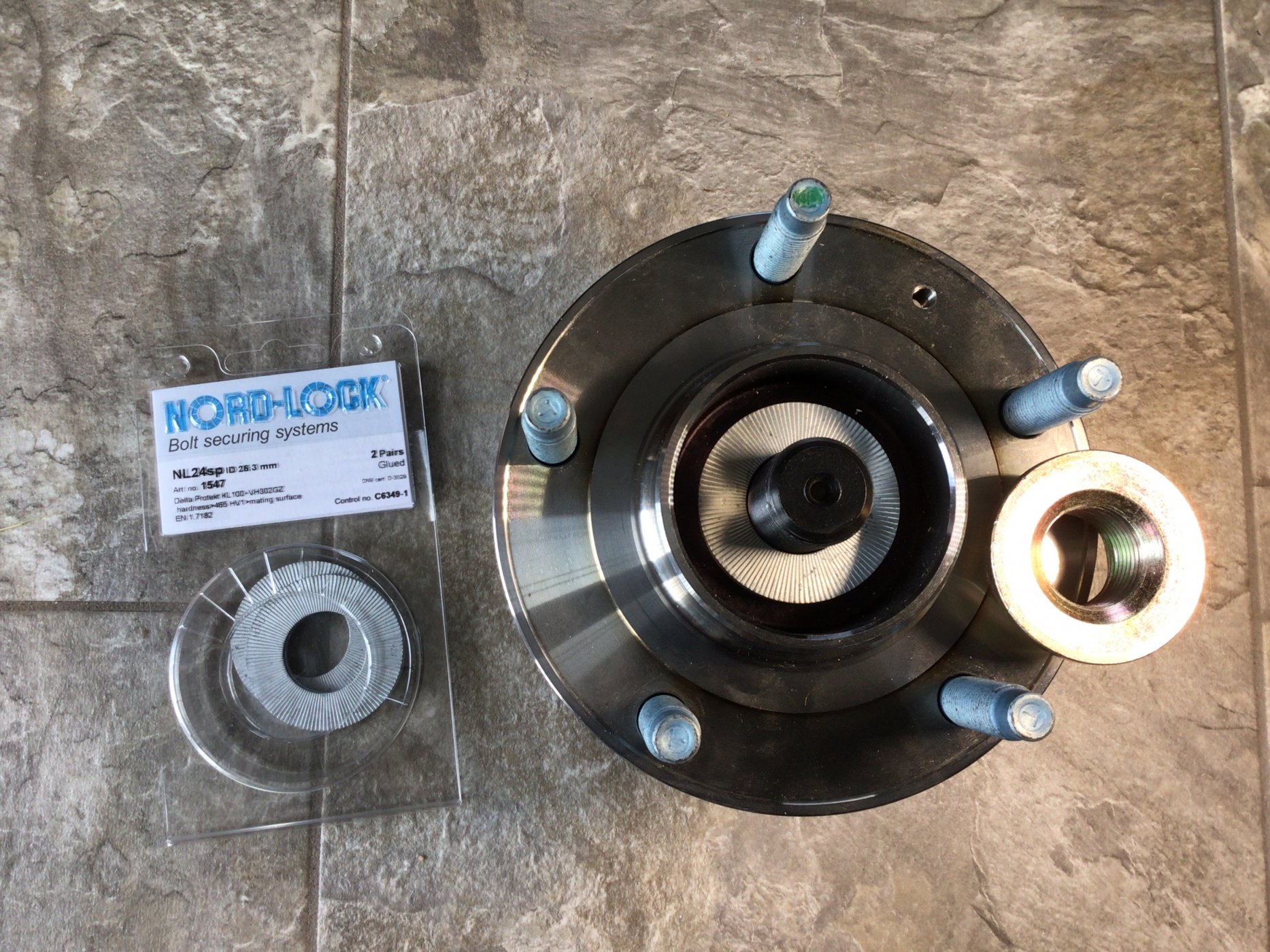

Ken Roberts
It all depends whose axle stub shafts you are using Howard. The difference is in the size of the nut. I think you are using the same stub shafts as me (DSS 33spline C7 Corvette). If so….the following pictures shows the part number and fit up.
For anyone else using the upgraded factory rear uprights with the C5 Corvette bearings and accompanying stub shafts I could tell you which ones to buy at McMaster-Carr if you told me the outside diameter of the threads on the end of the stub shaft.
Same with the original C4 Corvette rear wheel bearing/stub shafts as supplied by RCR. Give me the outside diameter of the threads on the end of the stub shaft and I can tell you which Nord-Lock washer to buy at McMaster-Carr.
Ken Roberts
Howard here is the McMaster-Carr part number for your application if using the same stub shafts as me #91074A353. They are $13.96 for a pack of two (One pack does both rear stubshafts). They are reusable as well.
