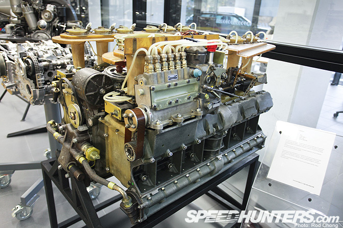

To finish a shot of my favorite car engine of all time....

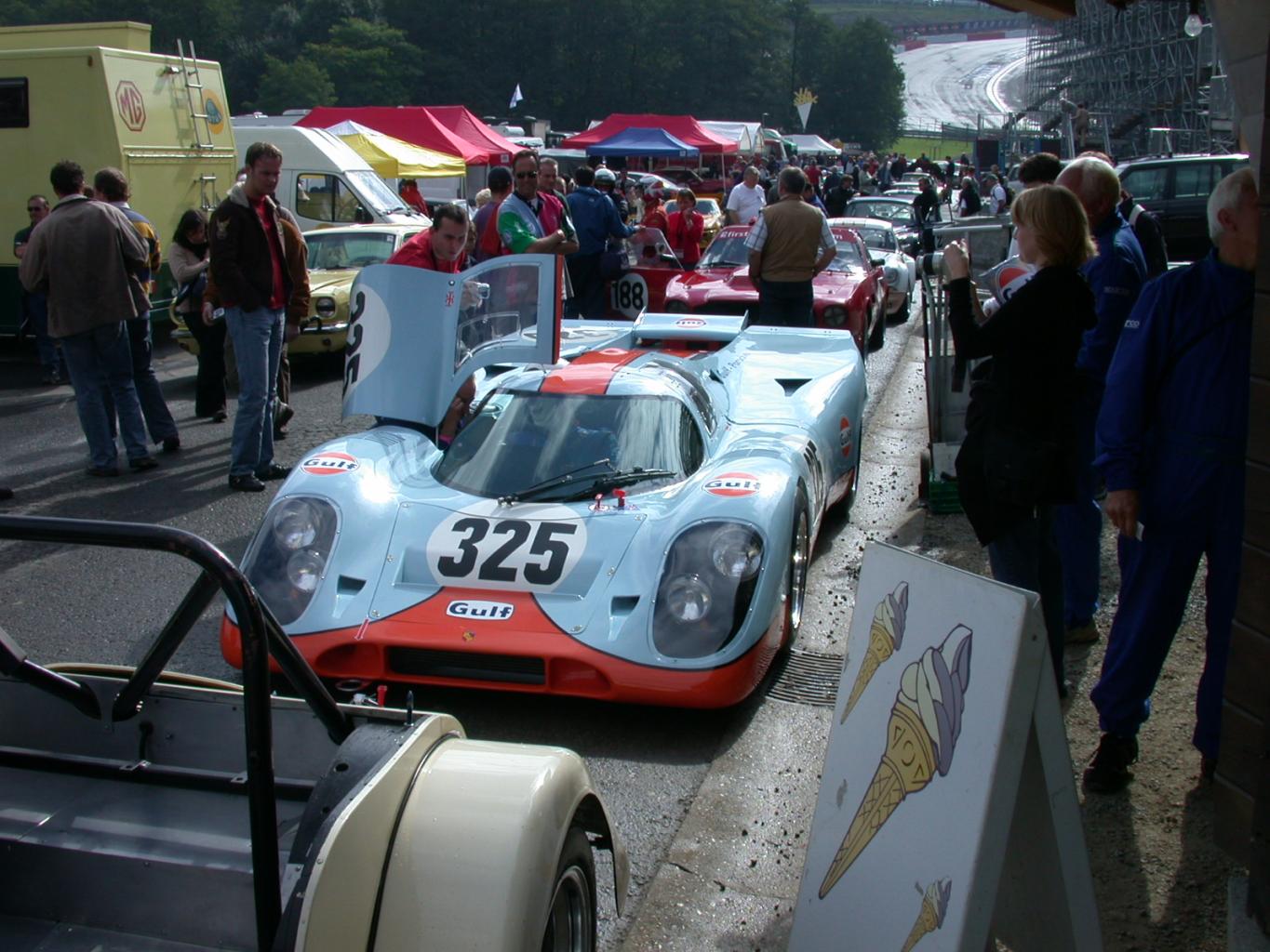

Well Doc,
This is the truth. Thrilling, exciting, awesome ................ but initially for my 1st lap there with the 917 way back in 2005, somewhat concerning.
In the 917 the seating position is in a lying down position, very forward in the car, with as you said, ones feet ahead of the front axle line. Very comfortable, but despite what appears to be a large area windscreen from the outside, when looking out, the viewing is a little more restricted. Going into the dip and then the right curving bend is fantastic, vision perfect, but as you start the climb and the track begins its roll out, i lose ALL site of the track for a second or so until you near the top. From that 1st lap, onwards I knew what to expect, but in traffic you just have to drive with "confident caution" !!!!!!!!!!!!!!! It is a phenominal feeling going into it flat out, but then at that speed you are trying to keep it on the track as it is trying to throw you off to the left as I,m sure you must have seen many times in YouTube footage, etc, etc. It does catch a lot of people out, especially in damp conditions, and believe me Spa enjoys four seasons in one day on a very regular basis.
Spa is quite simply wonderful and until you stand at the bottom of Eau Rouge you cannot really comprehend what a steep climb it is.
The picture I,ve attached shows some of the assembly area and a few of the 82 cars waiting to go out for official practice, and you can see part of that famous bend climbing up in the distance.
A definite "to do" for anyone as a trackday or race meeting. When you eventually finish your 40 and have it sorted, it is a track you must "taste" !!!!!!!!!!!!!!!!!!
To think that back in 2003 I was offered two of those engines. The first was just the engine, and needing lots of work @ £250,000. The second with a gearbox, also needing work at £300,000.
Needless to say I did not have enough change in my back pocket to purchase at the time. Had I have had the balls to sell my house and taken the gamble, I would be sitting on nearer to £2 million now !!!!!!!!!!!!!!!!!!!!!
