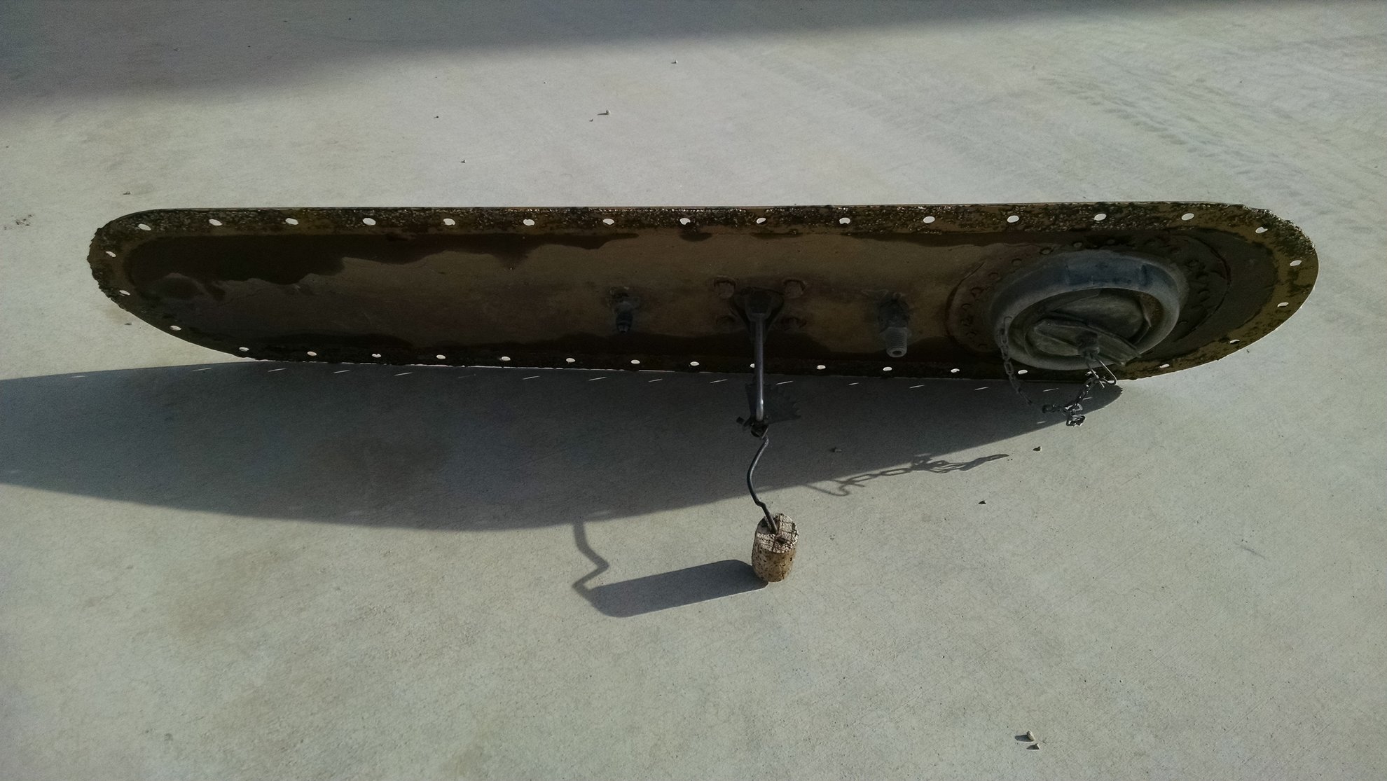

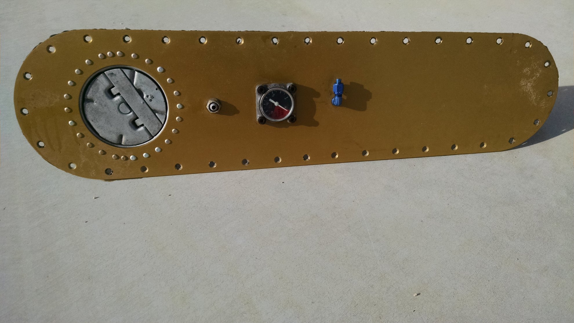

I had the same concerns with a small mid-engine Sabel sports racer that I built. I found two mechanical float level gauges and mounted one on the top cover of each tank. Watching the gauge needle as the tank filled was far easier than peering into the dark filler neck to see the fuel level. The gauges were an aircraft part but I have no idea which plane it was used on.
