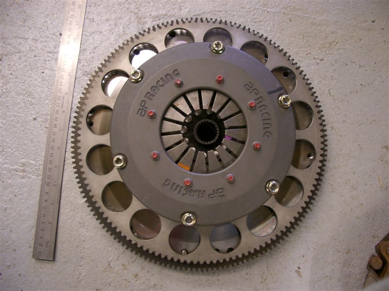

this picture shows a 'GTD sized' (V6?) flywheel laid on top of a stock 302 flywheel. The difference in dia is not huge.

Sorry, no pics and I'm out of the country at the moment. The reason I'm not sure is that I bought the car part completed so didn't source the parts myself. The clutch is large size (unlike the pics of the racing types) with a deep cover and has FOMOCO stamped on it. I assume the weights act under centrifugal force to press the pressure plate harder to the clutch plate as revs increase.
I think the mating ring was supplied by Hi Tech Welding (or similar) in the North East. I had to mill it down to bring the bell housing and first motion shaft closer to the flywheel.
