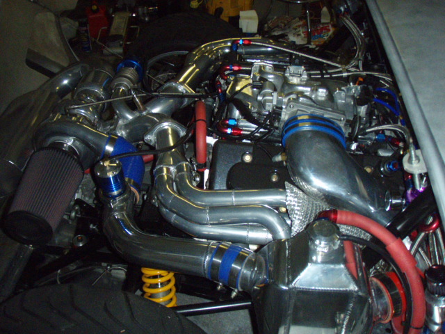

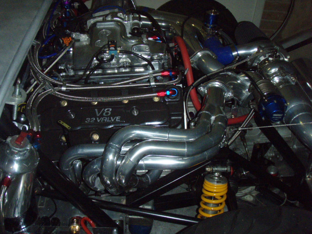

Here's a couple of shots.

NICE!! - VERY Nice indeed.....:thumbsup:
Not sure I'd want to put a warranty on that trans though although the hit from the turbo will be softer despite the torque... talking of which, what sory of figure did it achieve Bob??

Awesome effort Bob - guys this is a fantastic example of a very Individually Constructed Vehicle and shows what people can do thinking outside the circle. Even the parts Bob bought directly from RF were customised in some way to make this a very unique car. Now where's the warranty paperwork on that trans.....
congrats on a great vehicle Bob, Regards Paul
