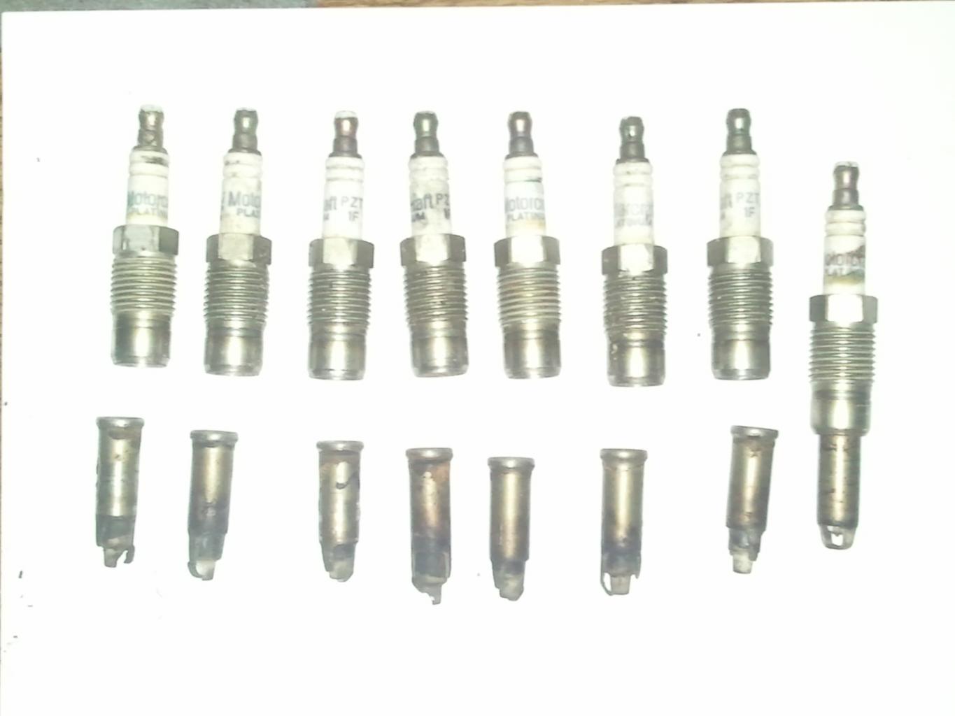

The good news is that Ford says the spark plugs in the 5.4L 3Valve engine should go 100K. The bad news is that when you try to remove them they break off. For me it was 7 of 8.
There must be an easier way to do this or an alternative spark plug...

Ford dealerships have a special tool that allows for the spark plugs to be removed without breaking. It has been a significant problem on the rear-most spark plug on the drivers' side.
I don't know if the dealerships sell the tool or not...I broke that "problem plug" while trying to change the plugs in my daughter's pickup truck and believe me, it took a mechanic two hours to figure out how to get that thing out. He was ready to admit failure when the stars aligned correctly and it broke loose.
IMHO it may be related to the length of the threaded portion of the plug...I know that anytime I change plugs I put a dab of anti-sieze compound on the threads. I haven't had to change the plugs out again, but when I do I have high hopes that the threads will not have "frozen" into the heads again. After looking at the photo you posted, though, it looks like the threaded portion had nothing to do with the part that broke off...mystery to me!
Getting those 7 threaded portions out must have been miserable....how did you do it?

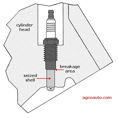

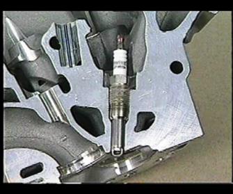

Apparently the problem isn't the threads but below that where the extended tip goes into the head. Carbon builds up to the point the tip becomes impacted with carbon and the ceramic of the plug breaks when the body is loosened with a wrench.
The job at the dealer was quoted as $780 if the broken plugs can be extracted with the dealer kit. He added they break more often than not. If they are really fouled, they need to pull the heads and the bill gets really ugly. In addition, the dealer charges $21 per plug for the part but I'm told some will discount to as low as $12.
The dealer suggested next time change them at 60K (vs 100K) after running lots of Sea Foam through the intake per the instructions on the can. If you look at the pics you can see the issue. Ford revised the design for 2008 so only the early 5.4L 3V are affected.

So, does the shell/sleeve transfer from the older plug to the newer one?
I can see that the design is significantly different from the one I faced with my daughter's plugs...on that job, though, the "hex" on the plug broke off so some sort of extractor was used to grip the remnant of the plug and get it out. I was truly afraid the head might need to be removed...and while $200 seemed a bit high for 2 hours of rather strenuous physical labor, I was glad to pay it rather than to have to resort to the Ford dealer with their "highly regarded" labor and material fees.
So...when you replaced the plugs, did you use any form of lubricant on that sleeve to eliminate the possibility that the new plugs might get frozen into those holes?
What an awful design...why not just a regular spark plug with an extended tip? Some of the OHC design motors use a plug with a VERY long body...but not a sleeve to get frozen onto the hole in the head. Just curious if anyone knows why they went to that design...it seems to me that they didn't give it enough R&D attention to see that the problem could occur only after significant miles were put onto the motor.

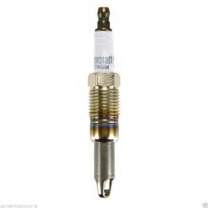

Doug, the new plug is all one unit. The bits of the broken old plug are throwaways.
Once you extract the plug body with the wrench (assuming it breaks) you need one extractor for the ceramic and another (like an EZ out) for the plug shell. The new plug is a complete unit. The problem is that it would be impossible to lube the tip as it's subjected to the cylinder burn and the carbon residue. The issue is to keep the carbon at bay or change the plugs more frequently before the build up seizes up the plug tip.
Fortunately, the newer heads (Late 2008 on) have corrected the issue.
Here is a new plug.
