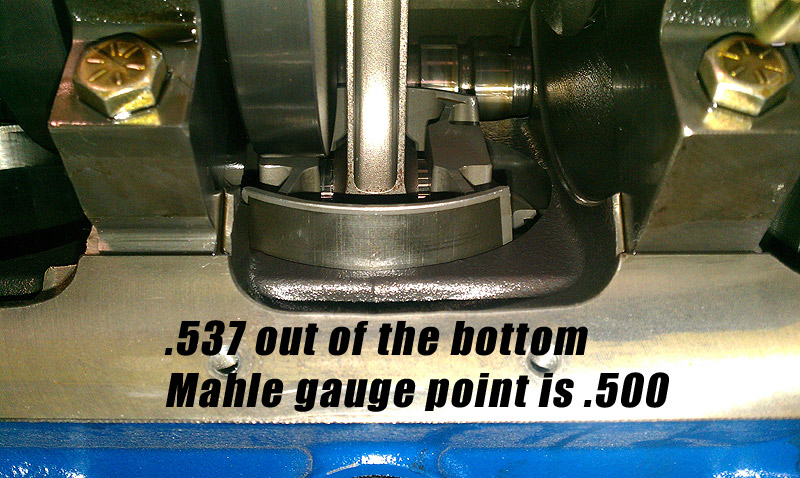

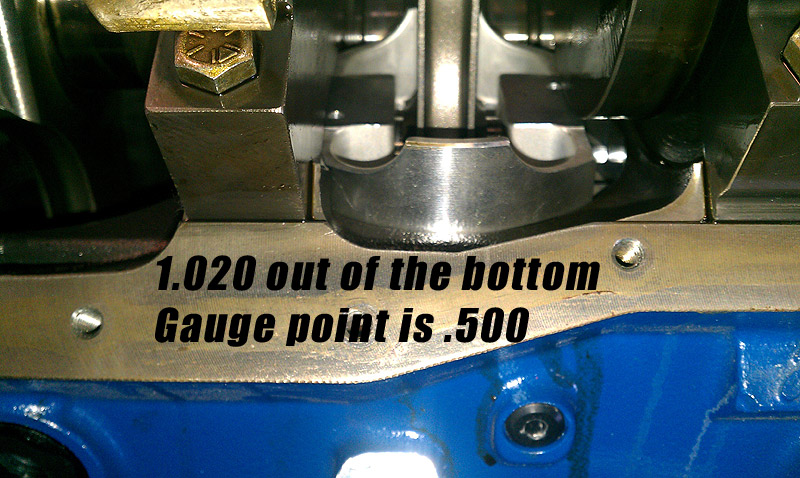

I will freely acknowledge my areas of expertise. Building engines is not amoung them. So I cannot vouch for this information. But here are links to some threads discussing the issue of the Boss Block, short bottom cylinders and the reason it is not well suited to a 3.400 stroke.
http://forums.corral.net/forums/94-95-tech/1345187-boss-302-block-dart-shp-block.html
<?xml:namespace prefix = o ns = "urn:schemas-microsoft-com
><o:p><A href=
http://forums.corral.net/forums/5-0-5-8-engine-tech/1309648-dart-vs-boss.html</o:p>
<o:p></o:p><o:p></o:p>
<o:p>http://forums.corral.net/forums/5-0-5-8-engine-tech/1096651-boss-347-crate-engine.html<o:p></o:p>
Here are pictures from the first link. The first is a short Mahle, the second a Probe. The issue seems pretty clear to my non expert eyes:
</o:p>

Good to hear. Sounds like the issue with the 3.4 stroke in the new Boss blocks is not across the board, as your engine proves.
