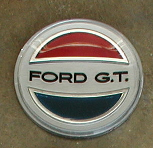

Anyone out there know what font was used in the design of the steering wheel center cap? It's not the same one they used on the side of the car.

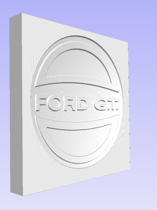

Thanks for the reply. I've worked off and on for some time to do a few things. First I'd like to make a reasonable center cap for my car. I know I can buy one but at $250 ouch. Second maybe make some CNC or 3D printed plaques. My current CNC router can do about 1' x 1' and my printer will do about 8" x 8". On the original center cap the top clear part is convex but the lettering and graphic is concave and the lettering is slightly shorter than the surrounding moon shaped parts. Without an original cap to measure or 3D scan it becomes difficult to model in CAD. What I was hoping for was a font I can just insert into my drawing.
I could also reverse the image to make molds but I'm not there yet. This is what I have so far.

I don't know if these images will help, I did them when iÍ had to have a cloth patch for my racing suit made. I produced it in Photoshop, and I remember I found a font that was close, but I had to reshape the letters a bit to make it look right. I would have uploaded the Psd file, but the system does not allow PSD files.

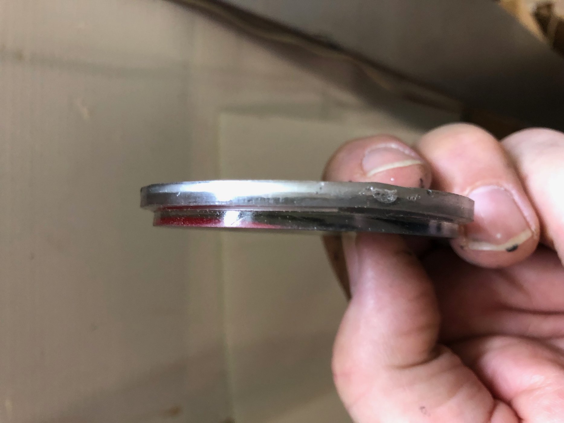

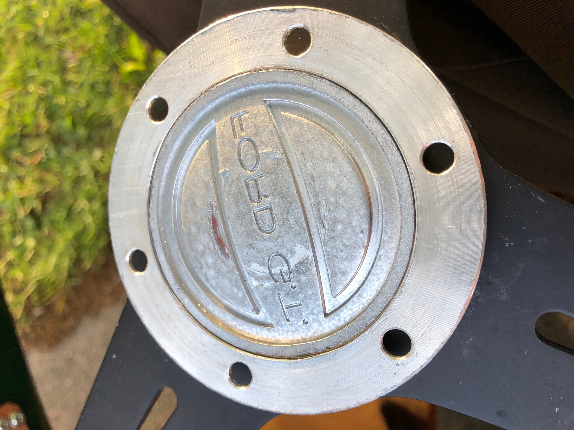

I measured the center cap. Outside diameter is 65mm and inner diameter (see picture) is 60 mm. Total thickness is 7 mm and the thickness of the outer diameter is 4mm. I eclose a couple of pictures.

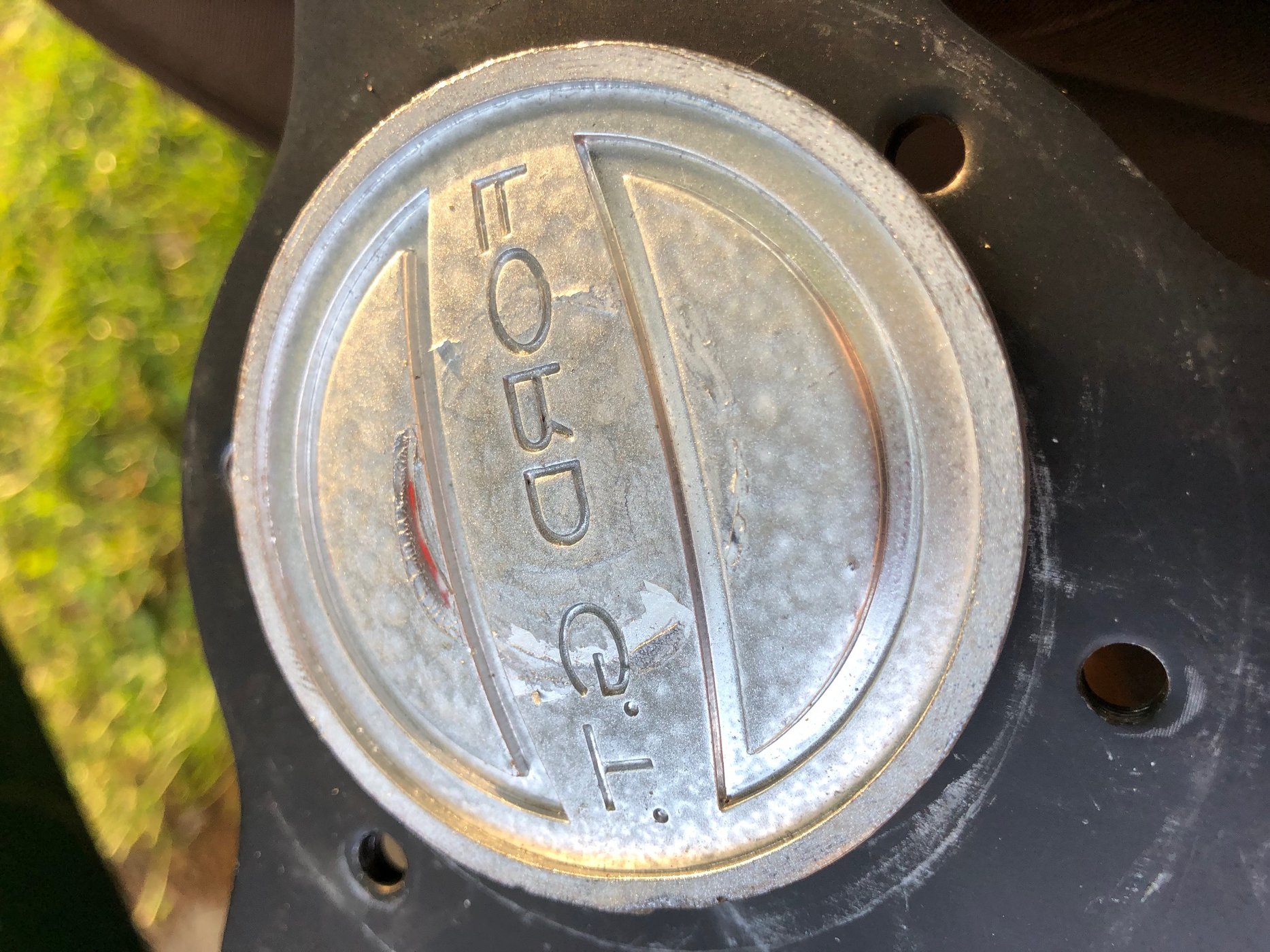

I took a photo from the backside. It looks like the letters are engraved into the plastic and the different colors are painted in layers afterward.

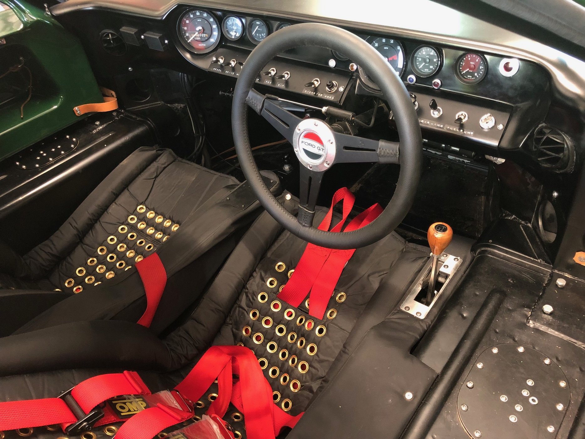

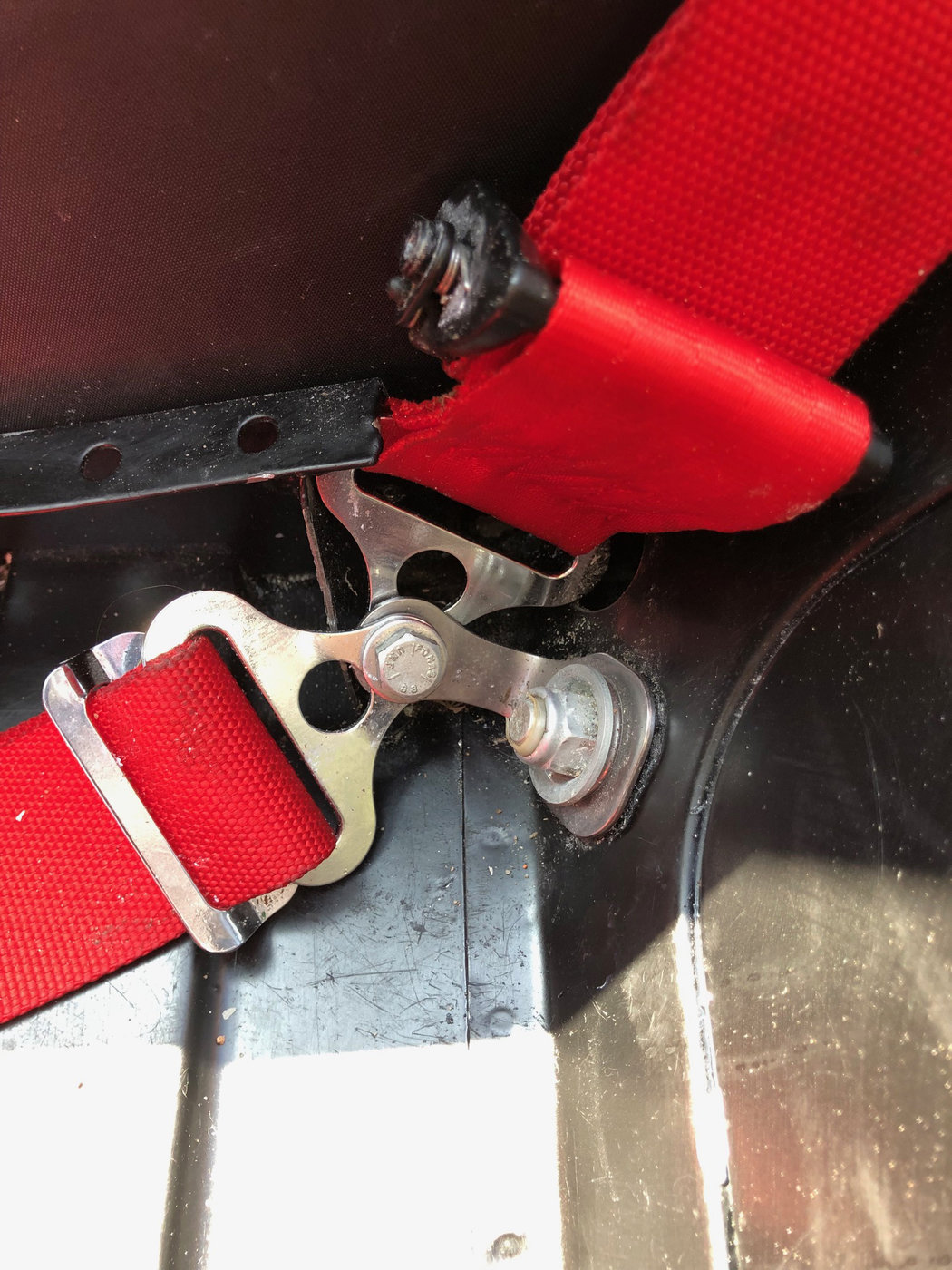

I also include a photo of the seatbelt, of sub belt arrangement for Cameron. Both belts are attached to the same place in the chassis with a bracket you can buy from the racing harness suppliers.
Again thanks. The sad part is somewhere on a shelf sits the mold for these or in some landfill. I wonder if these were made by Ford or sub contracted out to someone in England. Is there anyone that has enough of the paperwork from back then to tell? In the before time I was a tool and die make and know how expensive plastic injection molds are to make. A lot of money for for such a small run of parts. Maybe 200 were ever made. Enough for the cars and a few spares IMHO.
