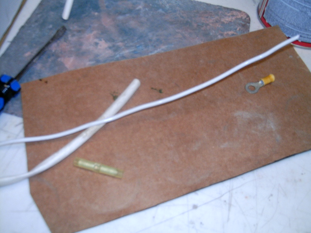

Alex, with all due respect I'll could have gone out in my garage and made one quicker than I read through this thread. It's just a ring lug crimped onto a 10" length of what looks like 12g wire....... Splice it onto the chassis wire and attach it to the terminal on the starter.
Your over thinking this my friend. Radio shack, any electrical parts store or even home depot has both wire and ring lugs. Buy a cheap crimping tool and be done with it.

Here........ I can't stand it.....do this.

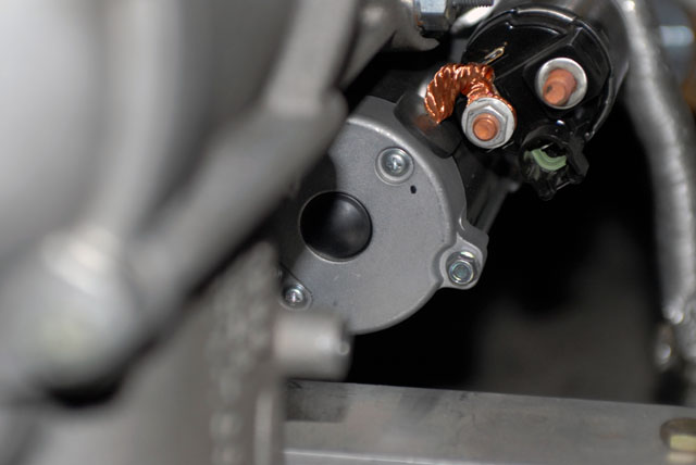

Here you go Howard:
Sort of a "D"-shaped plastic female portion and the single small spade.

Just to further Doc's post I circled the weatherpak connector on the starter
It's basically horse-shoe shaped, deep, with a single prong connector at the bottom
