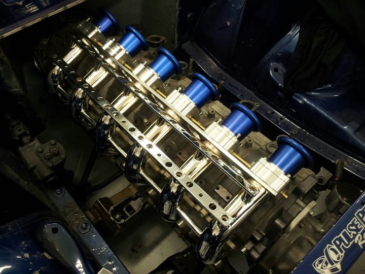

FRAN!!!! I need a longer wheelbase!
So I can fit eighteen combustion chambers in there :D

Man...I would love to hear that thing run :thumbsup:
No. You wouldn't...
Mankind has never made anything that exceeds the level of sound emitted by those engines! Top Fuel Dragsters hang their lowly heads in shame around these!
I saw a rotary at the PRI show that looked similar in concept...I know Dave knows about the engine but I forget the guys name that built it...
Dave????
This is a 6-rotor engine. First of its kind and a one-off custom job from the rotor fanatics in New Zealand. If it is successful, I'm sure there will be e-shafts (rotary version of a crankshaft) available for whoever wants to build one and we will see more of them.
The 6-rotor engine is a naturally aspirated peripheral port engine and with the exception of the e-shaft, is made entirely from factory Mazda 13b parts, some of which have undoubtedly been modified to house additional center bearings. I'm sure it will run on 91-93 octane and perhaps even the cheaper regular gas. P-port 4-rotors make 550-650hp so this could make somewhere in the neighborhood of 900hp naturally aspirated...but that remains to be seen.
Regardless of the naysayers and haters, naturally aspirated rotaries are some of the most reliable engines out there, period. For all you old farts who remember the early RX's from the early 70's....times have passed you by. Turbocharged rotaries....well, now that is a different story ;)
The engine Fran referred to is an offshore racing boat motor and is a 12-rotor engine that is made up of 3 banks of 4-rotors that combine through a gear drive into one output shaft. Those reportedly make anywhere from 1200 hp to 3000hp depending if n/a or f/i. They are designed to replace one or two (depending if n/a or f/i) 572 c.i. big blocks ( of which are the same size and weight), get more hours between rebuilds and be easier and cheaper to maintain. Search 12-rotor if you want more info.

So with 6 rotors, I can only imagine the BANG it would make when trying to start it in a flooded condition!!!!
