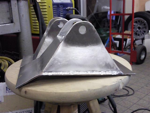

Hi Dave,
yes by the time i'm finished i'll be able to weld everything together you name it
finished the mount today unfortunatly didn't take a picture will try to do on sunday
frank
he're the pics of the mounts

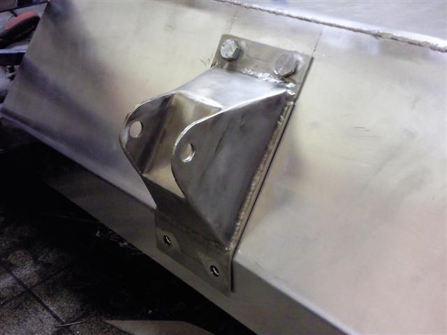

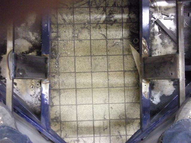

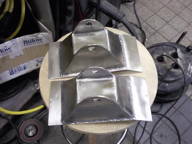

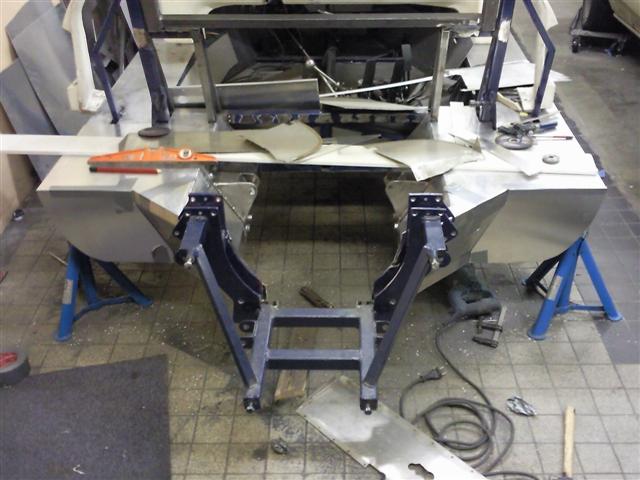

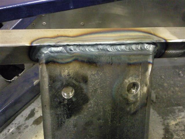

finished the chassis mounts put the alu back and put the enginemounts into place
i´m realy pleased with the result it was a bit of work but the result shows

hey frank, I was looking at pic of your rear uprights on the first page on you build logs and noticed that your uprights look remarkably similar to the ones on a pantera. are they the same.
Frank:
Looking good on the welding job. Those mounts look plenty strong to me. Soon you will be able to weld everything but the crack of dawn....keep up the good work.
Phil
Steph they are heavy but strong and they came with the car so i just worked with what i got and i think it´s not for racing so ... should be ok
Phil thanks i´m realy pleased also with the results and it´s getting better everytime

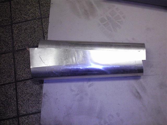

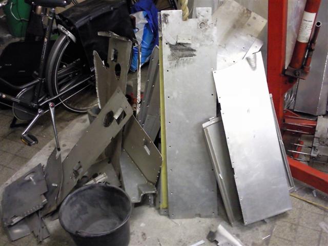

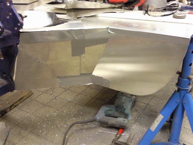

worked on the panneling of the back again thats an advantage that the pieces are resonable easy so quick results only needs welding and some holes (easier sad than done i know )

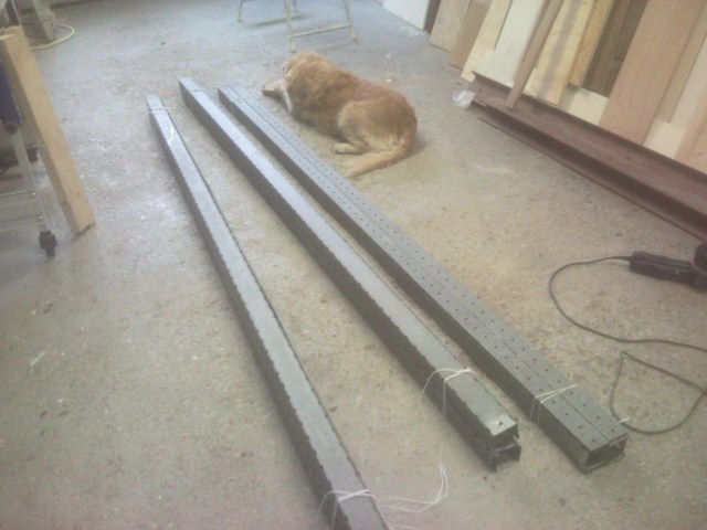

and a picture of the pile of alu witch came of the car

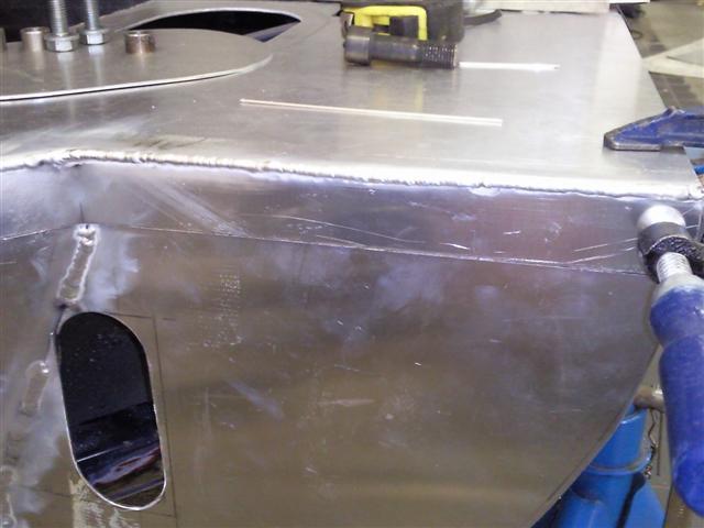

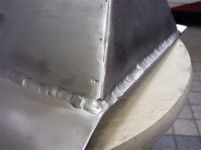

Frank:
What filler rod are you using, I am assuming probably 4043. Try some 5356, you might find the welds a bit nicer looking. Also I forgot to ask if your machine has square wave capability.
Phil
I'll have a look next week on the fillerrod
and i don't know what you mean with square wave
here's a picture
frank
Frank:
5356 a good filler, 4043 reacts with anodizing, and the welds don't look as nice but I use it sometimes with castings as it seems to flow better.
Square wave is generated by some machines, and the purpose is to be able to control the arc profile. I see you have a high frequency output, that is an arc stabilizer. Aluminum tends to buck about 40% of the current in the negative cycle of the ac wave almost like a diode, this means that at a fixed current you are getting 40% less current half of the time, the solution for this is to jack up the current, not good with thin materials. The High freq multiplies the number of cycles to about 600 to close those peaks and give a smoother arc. You hear it as a hiss coming from the machine.
With a square wave output the voltage polarity jumps almost instantaneously from positive to negative without sloping through zero volts as in an AC waveform, the power source has a balance control to increase the time the arc spends in the negative cycle and equalize the arc allowing you to weld very thin materials, and better control at lower arc currents like below 35 or 40 amps.
Its hard to see your machine in the photo, but it would be a control that was labeled "Balance".
Otherwise your welding is "Lookin' Good"
Phil

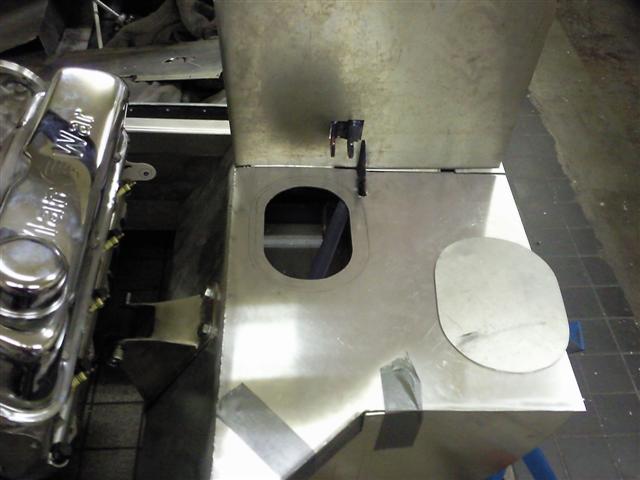

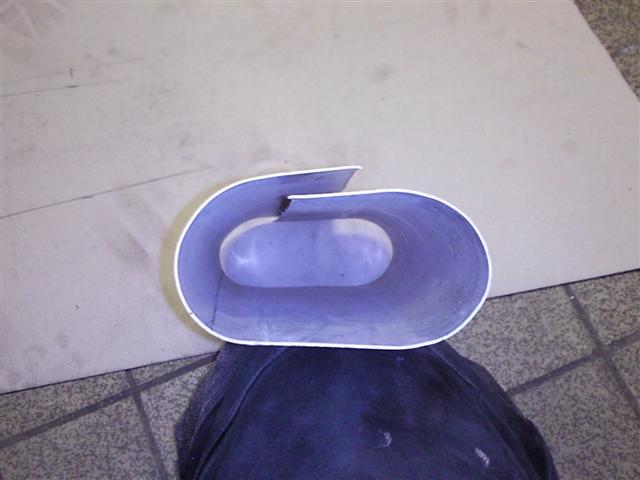

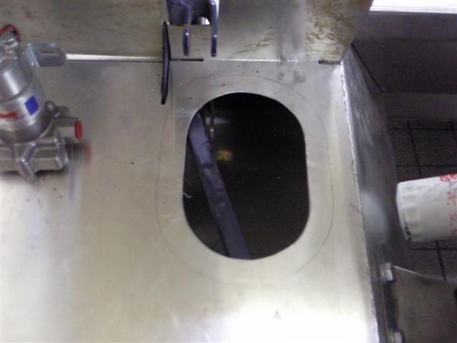

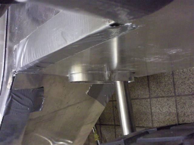

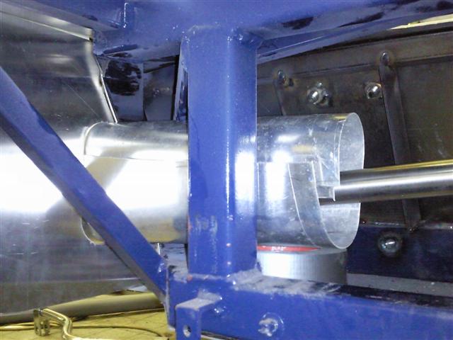

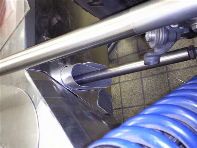

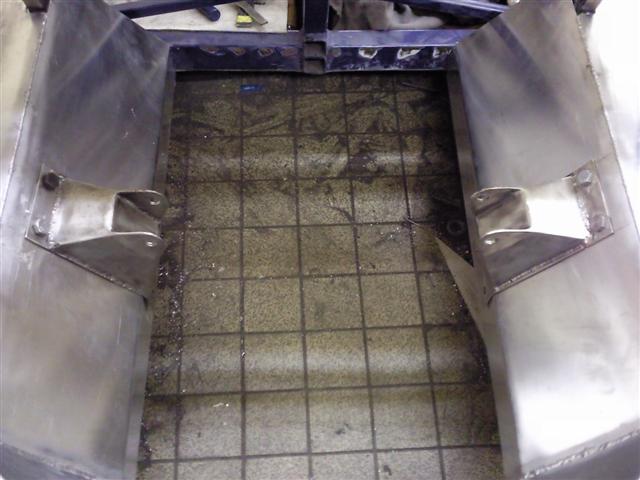

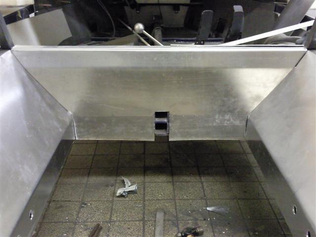

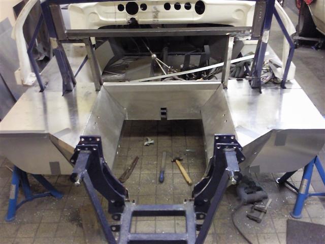

worked on the firewall
and made holes for entering the chassis

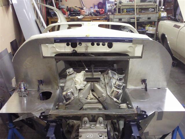

last progress

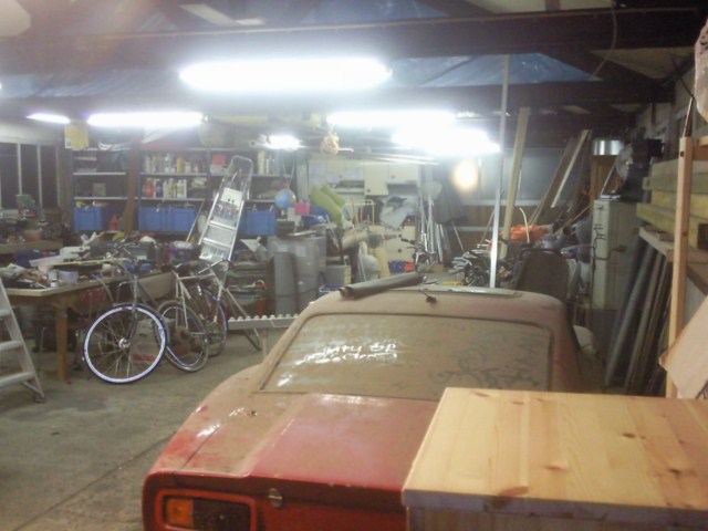

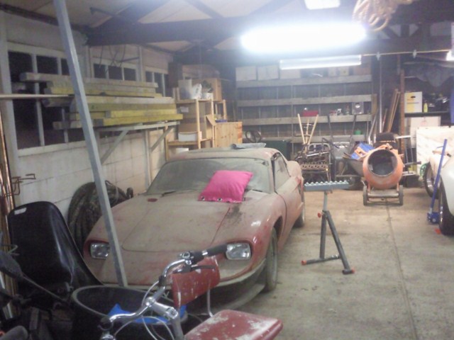

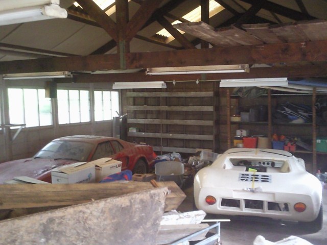

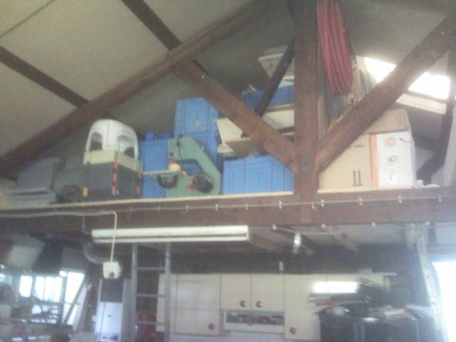

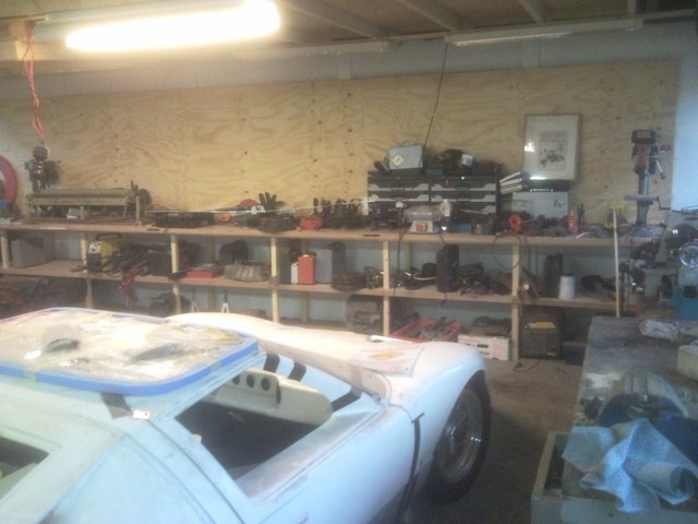

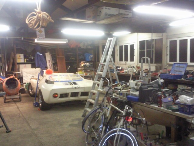

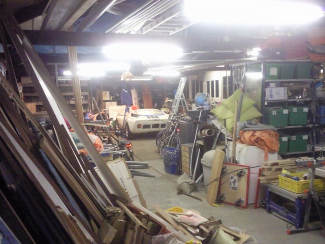

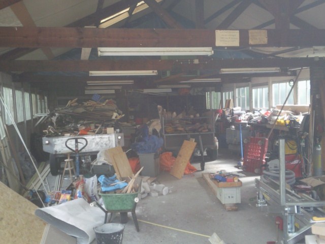

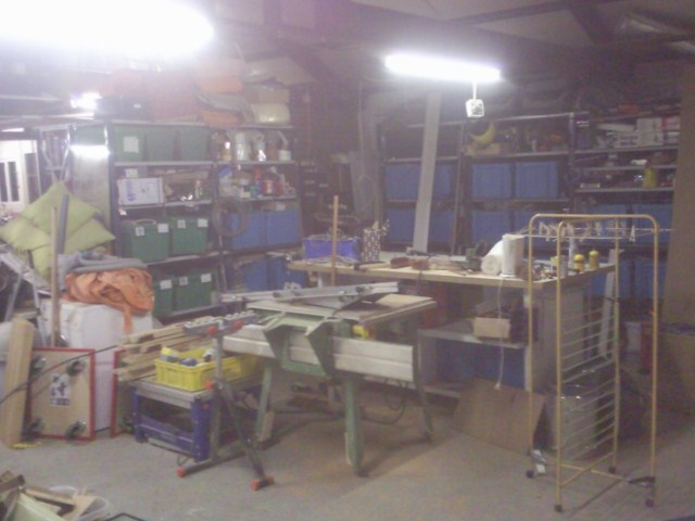

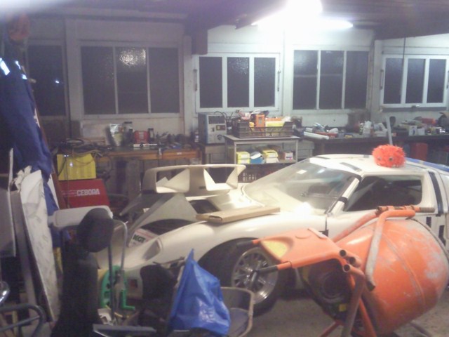

It's been a while since I posted here.
've had some time to work on the garage
First some pic's before
then during finaly after

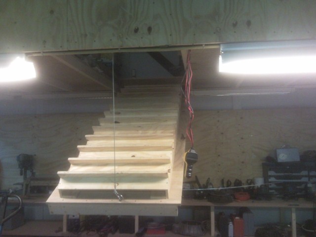

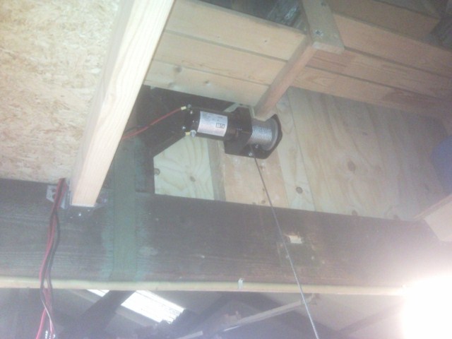

Made a workbench and storage above with a staircase which i can close
Bought some second hand metal cabelgutters (hope wrote that right) and attached a few allready.
I'll try to get in the electricity next week and a appointment to get the floor leveld .
don't know how long that will take.
Well at least i've made a sort of a start again
