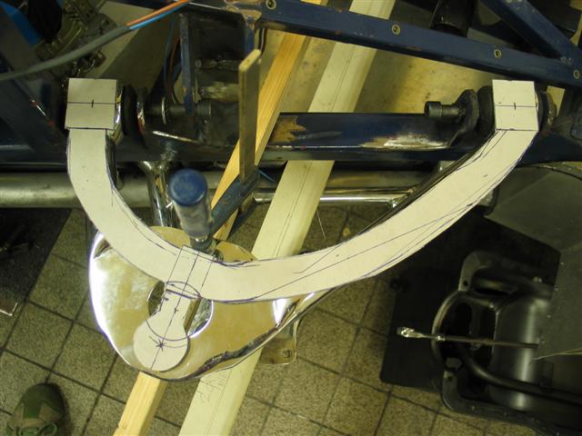

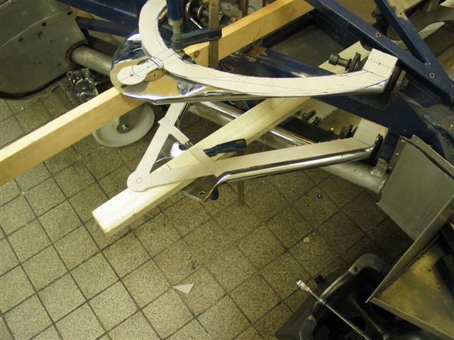

working on the front suspension creating templates for new upper and lower arms

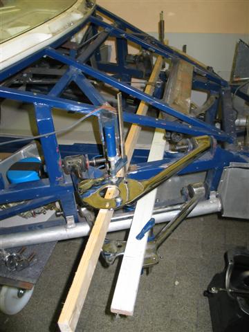

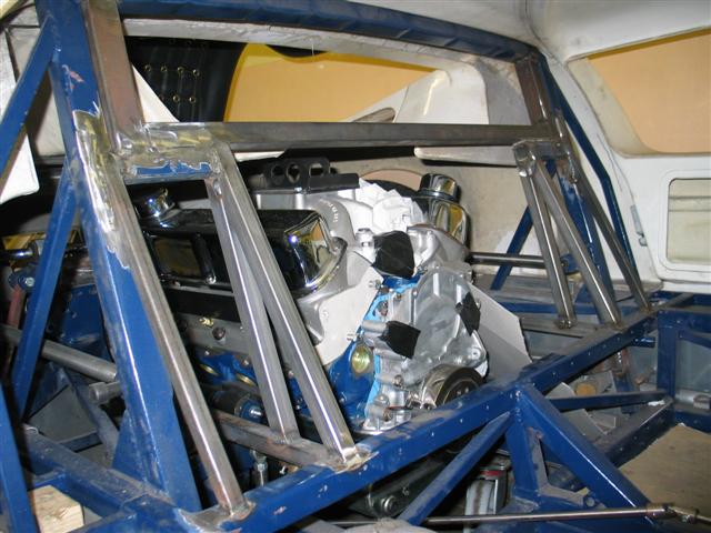

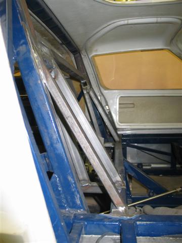

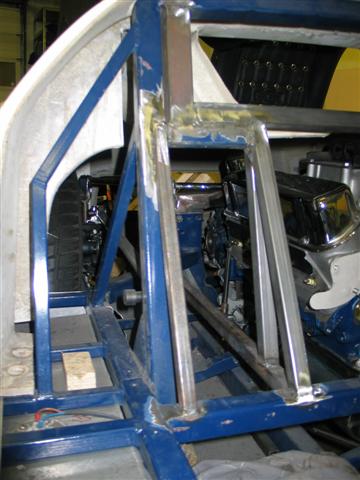

also the underarm cutout
and pictures of the changed firewall
hallo frank,mich würde interresieren welche stahlsorte (ST37 ?) du für deine neuen dreieckslenker verwendest und wie groß ist der durchmesser dann ist.
gruß meinolf
Frank
I don't fully understand your exchange in German but I have just ordered a pair of the Brembo rear callipers for my RCR40 from Andy Burrows at GD cars in England. His price is £220.00 (+ VAT) for a pair at gdcars.com. Sorry for butting in if I missed the point.
John
Hallo Meinolf ich wurde der stahlsorte uberlassen an der specialist ,ich wurde nur der zeichnungen machen unt nicht die metalwerken unt die durchmesser wird etwas wie 25mm
I just told meinolf that i'm not going to make the upper and lower arms myself also because they will be brons welded and i'm going for about 25mm in diameter I'm sorry for the german but i'll translate as much as possible in to english

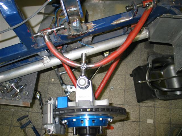

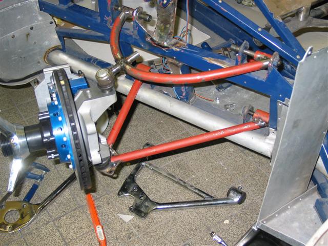

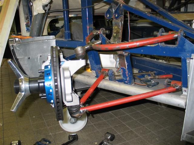

made a test setup from gaspipe looks neat
Ian Anderson
Frank
Looking good - very good
Possibly worth suggesting you consider how the skinning will work, that will allow you to remove the bolts holding the front suspension once it is a "whole car"(If the bolt goes with the nut on the rear portion or the front portion - and how your hand will get in there to hold the spanner.)
I wish I had your fabrication skills
Thank you for the compliment i'm also learning as I proceed
butt not bad for a gardner don't you think
about the skinning ,the nuts are welded and i'm going to make a hatch to remove the bolt's
Ian Anderson
Frank
The welded nuts sound like a great idea - only problem I see is most setups use Nylock nuts to stop the nut / bolt coming undone.
Saying that it may still be possible to use the welded nut - use bolts drilled for wire lockng and wire lock the bolt to stop it turning and coming undone.

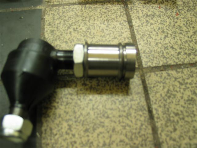

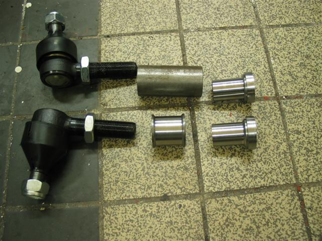

started on making the parts for the upper arms
the most right piece will be made with a hexional head so i can alter it minimal
