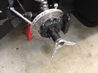

Hi, I'm in the process of running-in my SPF MKII, with only 330 miles on the clock so far. I've noticed a sensation of "looseness" from the front of the car, and some new mechanical noises in time with wheel rotation, particularly on applying steering lock at low speed. On axle stands, there is considerable play in both front wheels on rocking at the 6 and 12 o'clock positions so I'm thinking the front bearings need adjusting.
Now, I'm keen to learn, but my enthusiasm exceeds my knowledge and experience when it comes to things mechanical! I have built and maintain a Caterham, and front tapered bearing adjustment involves removing the brake caliper and adjusting a castellated nut, being careful not to apply too much preload - I am fine with this. However the GT40 setup seems rather different!
Are there any "noddy" guides to doing this on the GT40 or similar cars? I've read all the threads on the rear bearing adjustment (this is definitely beyond me), in which there have been comments that front bearing adjustment is "straightforward", so I'd like to have a go if at all feasible, otherwise i will take it to a local mechanic.

Adjusting the front bearings is easy. Unfasten the 2 button head allen screws, remove the slotted lock plate and tighten the adjuster ring. You probably can tighten the adjuster ring without the Olthoff tool, but it does help. No need for the Olthoff axle pullers on the front bearings.
Are we talking from the inner aspect of the upright? - can't see anything to fit with the description above looking at the outer aspect of the upright/hub. Excuse me if this is blindingly obvious! - I did say may enthusiasm outweighs my knowledge (and maybe my common sense) - the Caterham bearings are accessed from the outer aspect on the stub axle.
Just one more thing to add, I don't have the standard wilwood brakes, I have Wortec 6 pot calipers and discs, not sure if this would make any difference ( as per photo which is hopefully attached to this post!)

Inside. The retaining ring is held on with a couple of Allen heads. You could do it with wheel on so the "remove" wheel is for ease of access, not because the adjuster is blocked by the wheel. Your calipers and discs make no difference.
