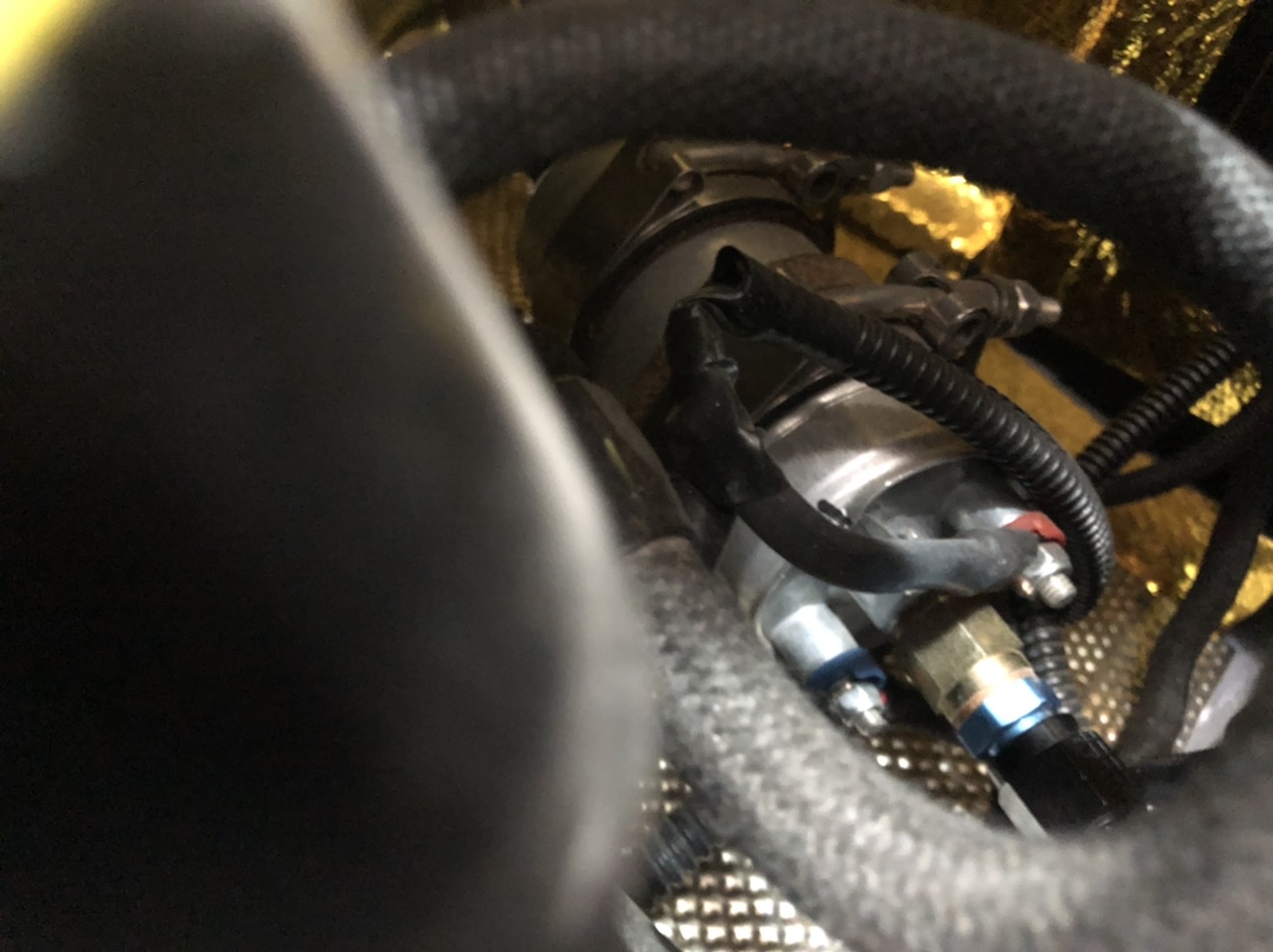

Good morning, I’m running an external fuel pump and noticed that with fuel in the tank And the car sitting idle the pump is very hot.
I'm using the RCR supplied fuel system that was shipped with the kit.
Any insight to the issue would be greatly appreciated.

Mark. I didn’t use the RCR solution, but does it use two pumps? One to fill the pot and the other to supply the engine? On my system I have two pumps and purchased a pump regulator so the pumps only worked at 100% when needed (controls heat). I also added a return line in case the lift pump was working faster than the primary pump. I’ve read that not enough voltage can cause an overheat.
Again, not familiar with your system, so just a thought.
If it’s the standard RCR setup it uses a Walbro low pressure pump to feed the swirl pot and a Bosch 044 high pressure pump to feed the rails. That photo shows the Bosch pump.
