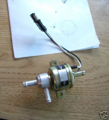

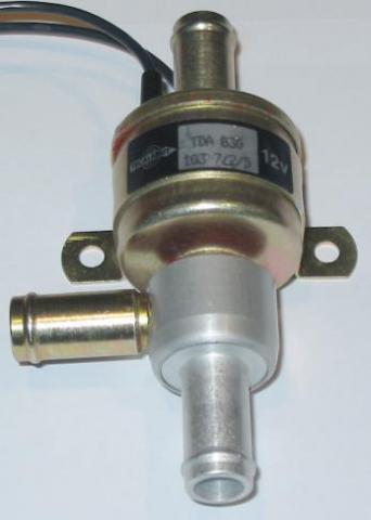

Perhaps the solenoid valves from a Jag.
I cannot remember off hand if they need power to open or power to close - but they are made for this application
We always use the electrically oiperated JAGUAR units, they come in either normally open or normally shut with power off, so you have choice. We have used these on SPF systems. Frank

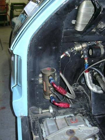

Tecalemit solenoid operated valves are usually fitted on the bulkhead.
Here's one in an original car.

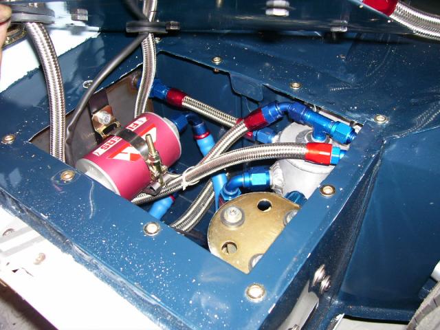

Richard,
If your only reason is to allow fuel filter change w/o worrying about stopping flow of fuel from the fuel tank why don't you keep it simple and do what I did (see pics of my left sponsoon) and just make the line in and out of the filter long enough so the filter and lines can be raised out and above the sponsoon and above the fuel tank top and you won't need the valve. If you do it your way you will still have leaked fuel from lines downstream of the fuel tank anyway, my way all those lines stay filled and very little gas lost.
I also recommend a large Canton filter as in my pics (better filtering and lot's of capacity).
BTW...I don't have any problems with filters plugging up now 3,000 miles. Did replace filter element at 1,000 miles just in case and all is well.
Steve P2125
