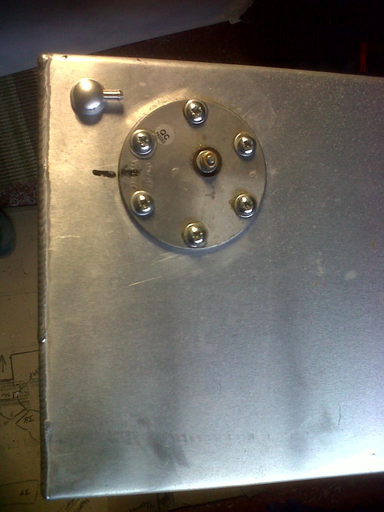

Pat, one of my rear vents is pictured here. I positioned the valve on the tank beside the gauge, to I could get a hold on the internal nut to tighten.
The vent pipe comes through the horizontal panel and up the back of the 'A' frame and is terminated at about the height of the water vessel, I may put some charcoal canisters on at some point. I'll post some pix tonight. K
