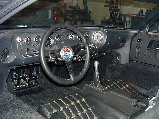

I've decided that I want to go with a horn button on the steering wheel, instead of using the Lucas button on the dash as shown on the RF construction manual. I feel that having a horn on the steering wheel is safer than having it on the dash, plus, I plan to use the existing hole in the dash for an engine start button. :)

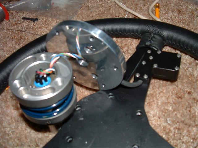

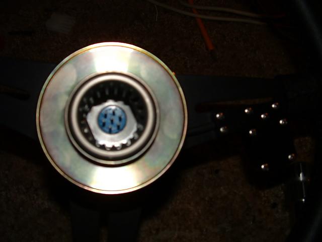

I used a different approach to the problem by putting a Lemo plug in the centre of the quick release and the Steering wheel is the male half of the plug, with the steering shaft as the female half. From there I mounted a 'button' plate behind the steering wheel so now I have the possibility of up to six buttons for anything I choose. The Lemo plug is obviously low current so everything through the plug has relay/solenoid actuation. For the six buttons that I plan to use, they will operate Horn, L.Ind, R.Ind, Flasher, maybe a Mic on/off for Nokia phone via OMP intercomm, and a spare.

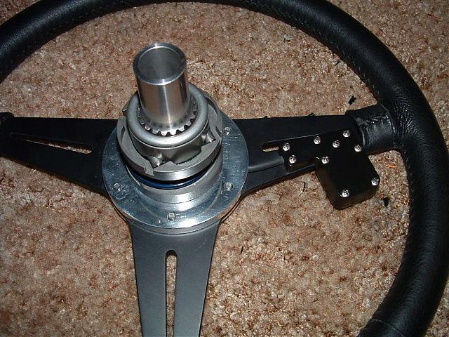

Mark,

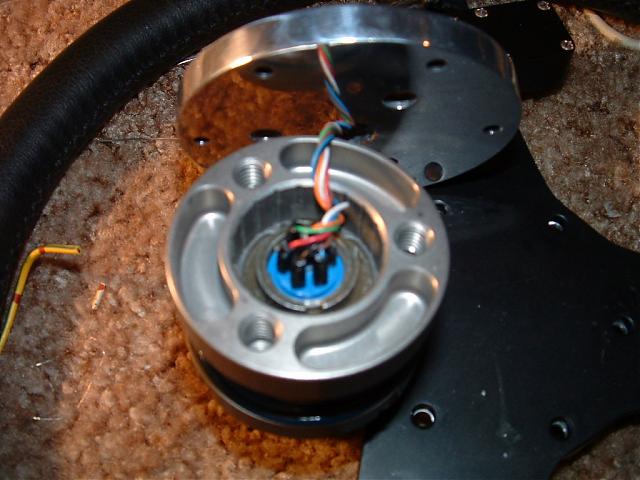

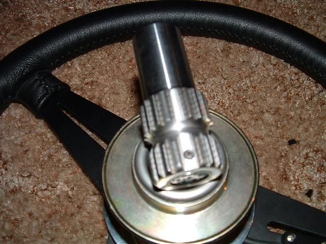

I did a setup similar to I think what David is describing. A little module mounted on the steering wheel where the left hand thumb can actuate the buttons, has a rocker type turn signal button, horn, and headlight dimmer button. The wiring from it goes into the steering wheel hub and to an Amphonol male disconnect. The female is in the steering shaft. A tooth on the male Sweet quick disconnect steering hub is milled off and a setscrew put in the "valley" of the matching female part of the Sweet disconnect. That keys the wheel so it can only be put on in one position....the pins in the Amphonol connector always line up correctly.

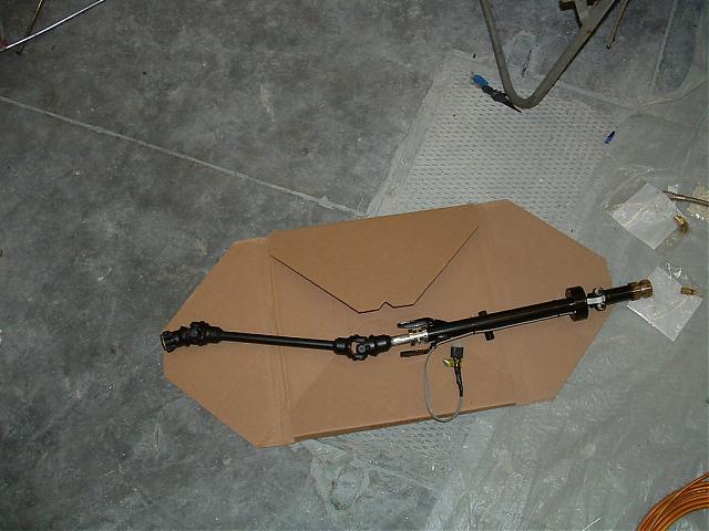

The female Amphonol plug wires onto a flexible ribbon cable that runs down the shaft and is formed into a loop around the shaft in a small housing. The loop of ribbon is like a watch spring that allows the steering shaft to turn. A stationary wire exits there to a custom electronics unit I made that contains a PIC chip programmed to recognize the various inputs and turn on/off the proper relays to perform the function of the button pushed. Also on the steering column is an aluminum cam assembly that has two IR sensors on it to provide self canceling of the turn signals. Makes a very neat installation that isn't really noticed unless you're looking for it.
Works great.
Something similar to this should be somewhat easier to do if only 1 wire for the horn is needed.
