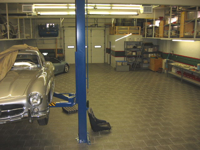

At home I use Tenemic 2 part paint which works very well. In my shop we have tile which is beyond super.

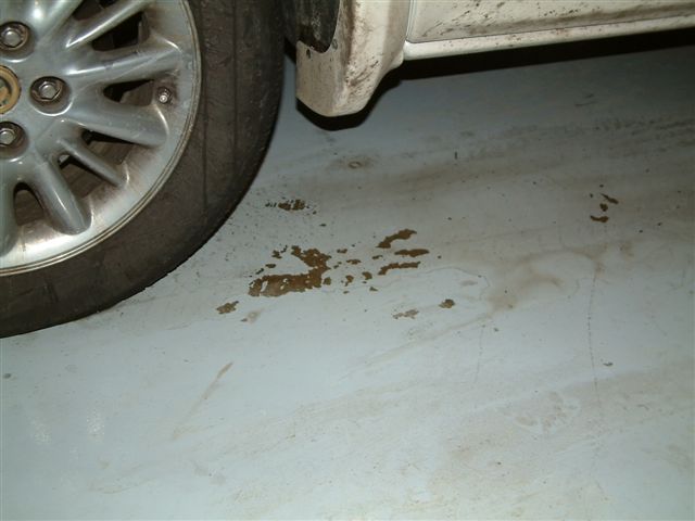

Here's a pic of the peeled area of the garage floor. The rest of it looks pretty nice.

If you used a two-part epoxy, solvent base prefered, and it's a quality material, you usually see this if the floor is not acid-etched enough. Acid etch-ing one time may work, but after you acid-etch it should feel about like 120 to 150 grit sandpaper. Hot wet tires are a mother, and some of the additives they are putting in tires these days has made it even more important to use high quality material. Does the concrete feel slick where the paint has peeled off?
