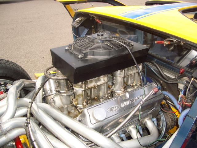

Try this idea, just slap it on after a hot run and the temps are reduced in just a few minutes, preventing fuel boiling over from the float chambers through heat soak.

Neal
Interesting idea Frank. Worth a shot.
