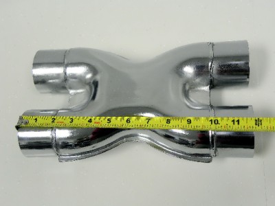

Well there isn't a whole lot of room from the end of my headers to the back of the car (about 18 inches or so to play with) so I was planning to go with an H pipe connecting around the end of my collectors. The thing is I know that an H-pipe just isn't as efficient as an X-pipe and that was really bugging me. All of the X-pipe mufflers I saw were WAY too long to work for me, so I thought, why not. I'll make one (with the help of a good welder I know).
So, I just placed an order for a stainless steel X-pipe that's about 12" long total (see image). I'll cut some stainless sheet to go around it, drill about a bazillion holes into the X-pipe, fabricate oval ends about 9" wide and 5" deep to weld the sheet metal to and put some sound deadening material in.

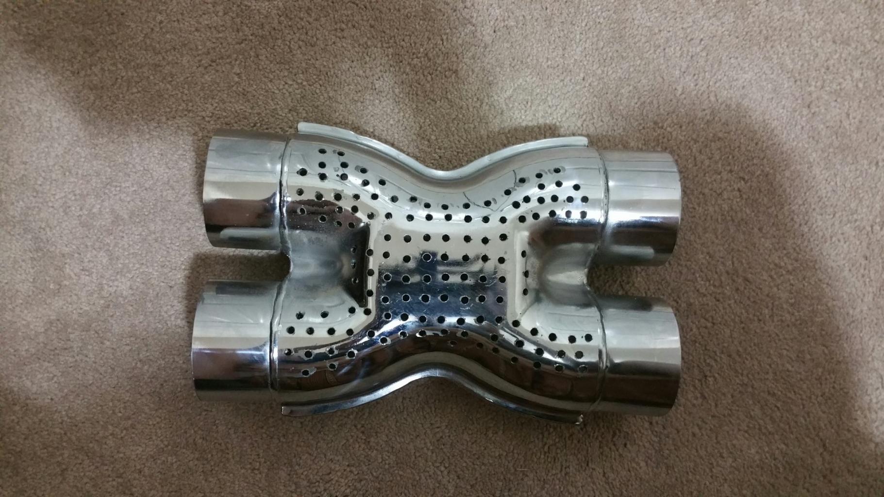

Step 1 complete. Drilled a few hundred holes into the X pipe. Monday or Tuesday I will pick up the pre cut stainless steel sheet. I already have the high temp ceramic mat for the sound dampening.

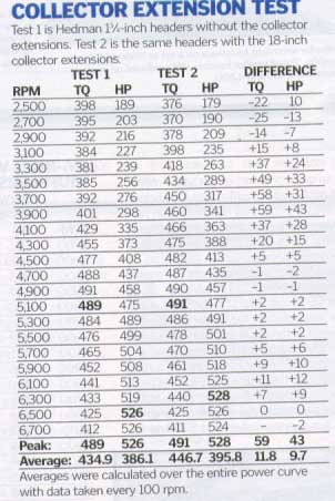

So, I was doing a bit more research about collector length. As a kid, I always heard about the "cut where the metal turns color" with respect to collector length. Well, it turns out that is probably not all of that accurate. What also turns out though is that just about every GT40 I have ever seen has the exhaust set up wrong based on the research I've done. What we all could use is a much longer collector! In my setup, and probably everyone else's, that would necessitate two 180 degree bends...one to go back toward the engine after the collector and then one to turn the other way into the exhaust then into the muffler.
What is all boils down to is that we are losing a lot of torque running little, if any, collector. What is needed is an extension the same diameter as the collector added in at least 9" or so and preferably closer to 18". If you don't believe me, here is a little chart showing how much you pick up. Run 1 is without a collector and run 2 is with one. Note that simply having an exhaust system on the end is not the same as running a collector extension. Due to the resonance of the waves (who's intricacies into the mathematics I did not get into), the collector needs to be of the same diameter. Most exhaust systems will neck down...and that just isn't the same thing!
Anyway, here is the chart of one test. There are many others out there that show similar results. Long story short, I'll be running a long collector at 3.5" (OD), necking down to 3" (OD), doing a 180, routing back a bit, then do another 180 and into the X-pipe with 3" (OD) inlets/outlets.
