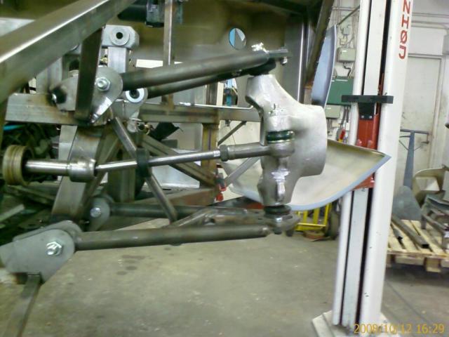

I wonder if these angels are a good start for My GOX front suspension geometry...??? This picture show when the car is in ride height.
If that is really set at ride height, then you might have a bump steer issue as you travel through the range of suspension movement.
Also, most designers use the unequal length a-arms to get camber gain on roll, but surely the GT40 is stiff enough that you wouldn't need to try to compensate for too much roll? It almost looks like a production sedan design.
Just noticing-- perhaps there is an explanation I'm missing.
