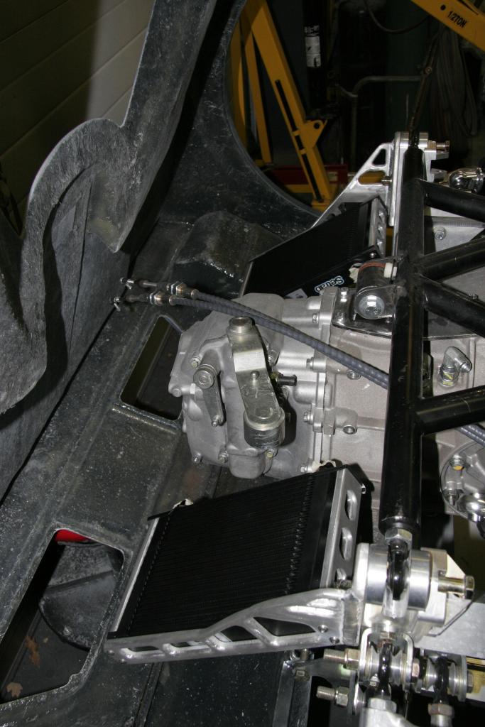

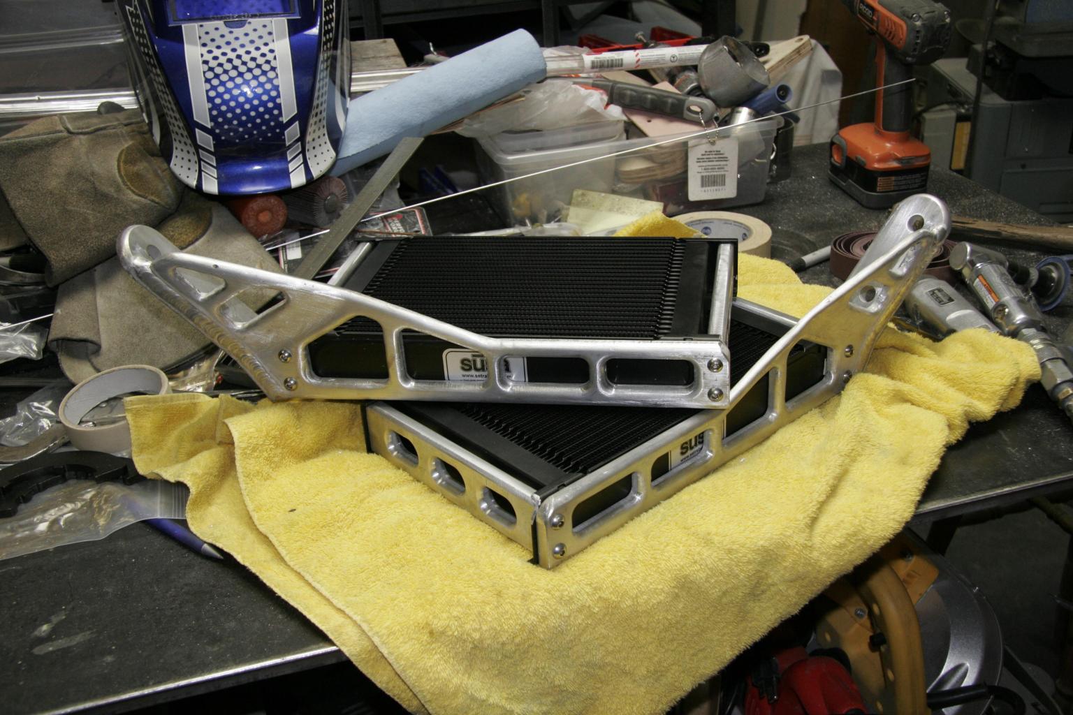

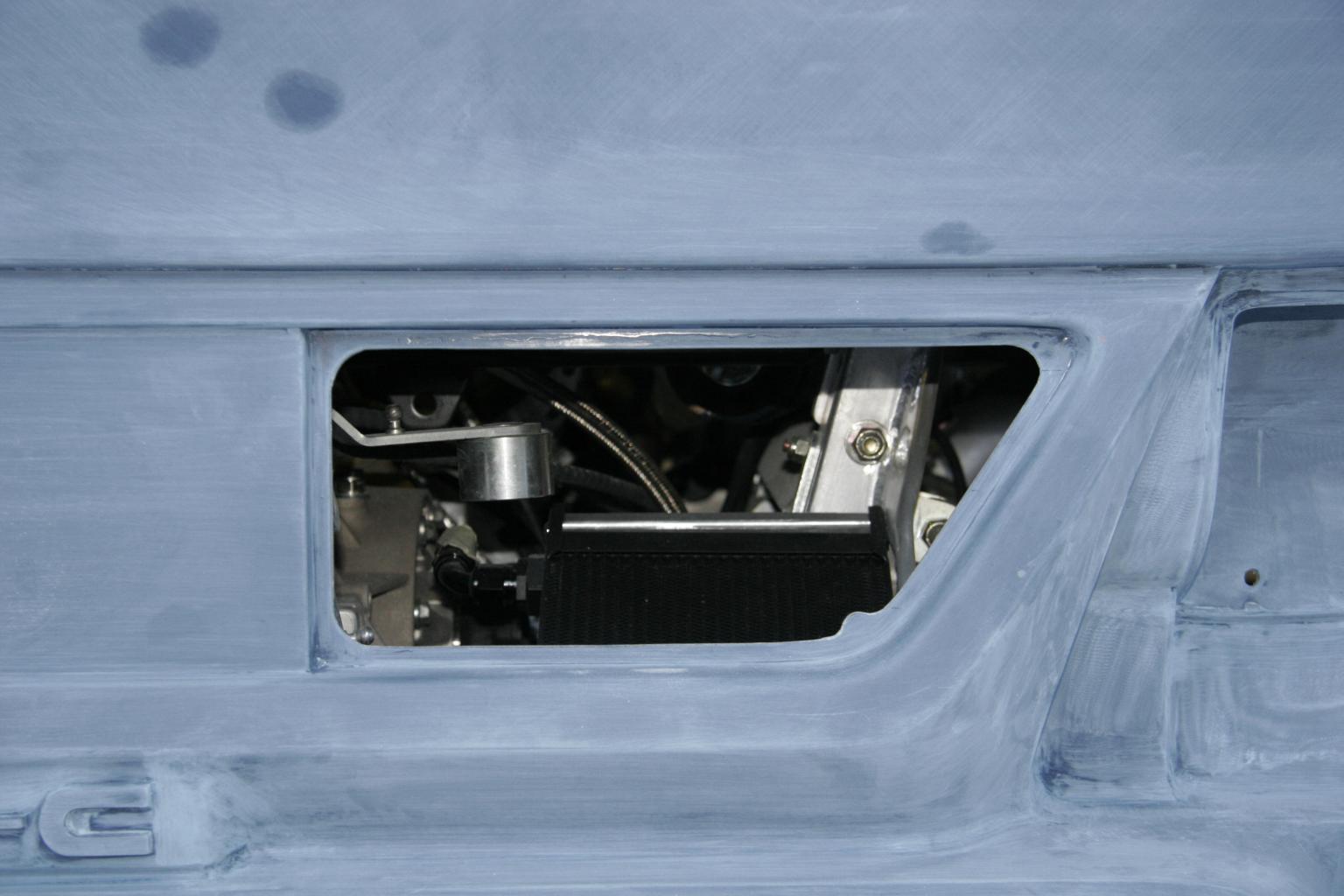

Here are some pic’s of the oil cooler brackets I made with two Setrab 625 coolers. I drew these up in CAD and had them water jet cut then welded them together they worked out quite well. Fran had mentioned in a earlier post it would be wise to rubber mount them. So I got on Ebay and found some Vibration isolators that fit the bill perfectly. I spoke with the Tech’s at Setrab to see if there could be any other issues with the way I installed them as I don’t want a catastrophic failure that will take out my motor. So they wanted pictures of the car, some details of the engine and some showing how I had place them. Here’s their reply “ Very cool car never seen one before what is it called, please send us pictures when its done, we want to use it for a newsletter.” Hmmm So Im guessing they should be ok, LOL.

Thanks for sharing Grant. I'm using the same style of Moroso coolant tank and overflow tank as you in almost the same areas.
Don't cap the heater outlet 10AN fittings on the water pump. They must be hooked in a loop for correct operation of the coolant system.

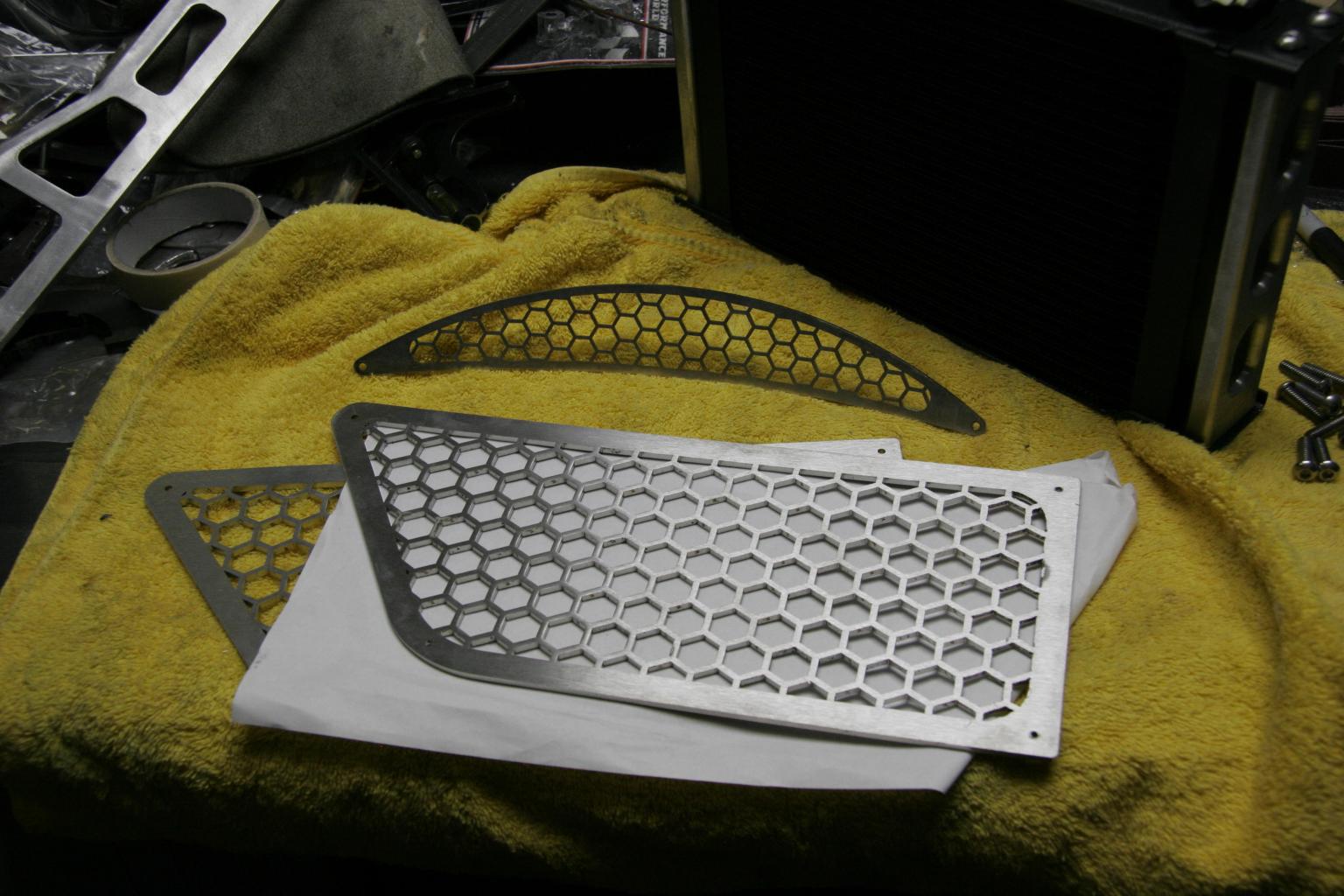

Here are some air duct screens I had laser cut they will be fitted later in the build.

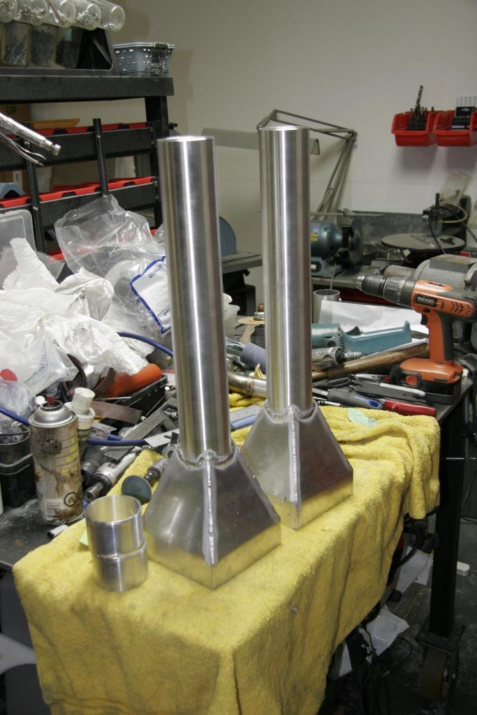

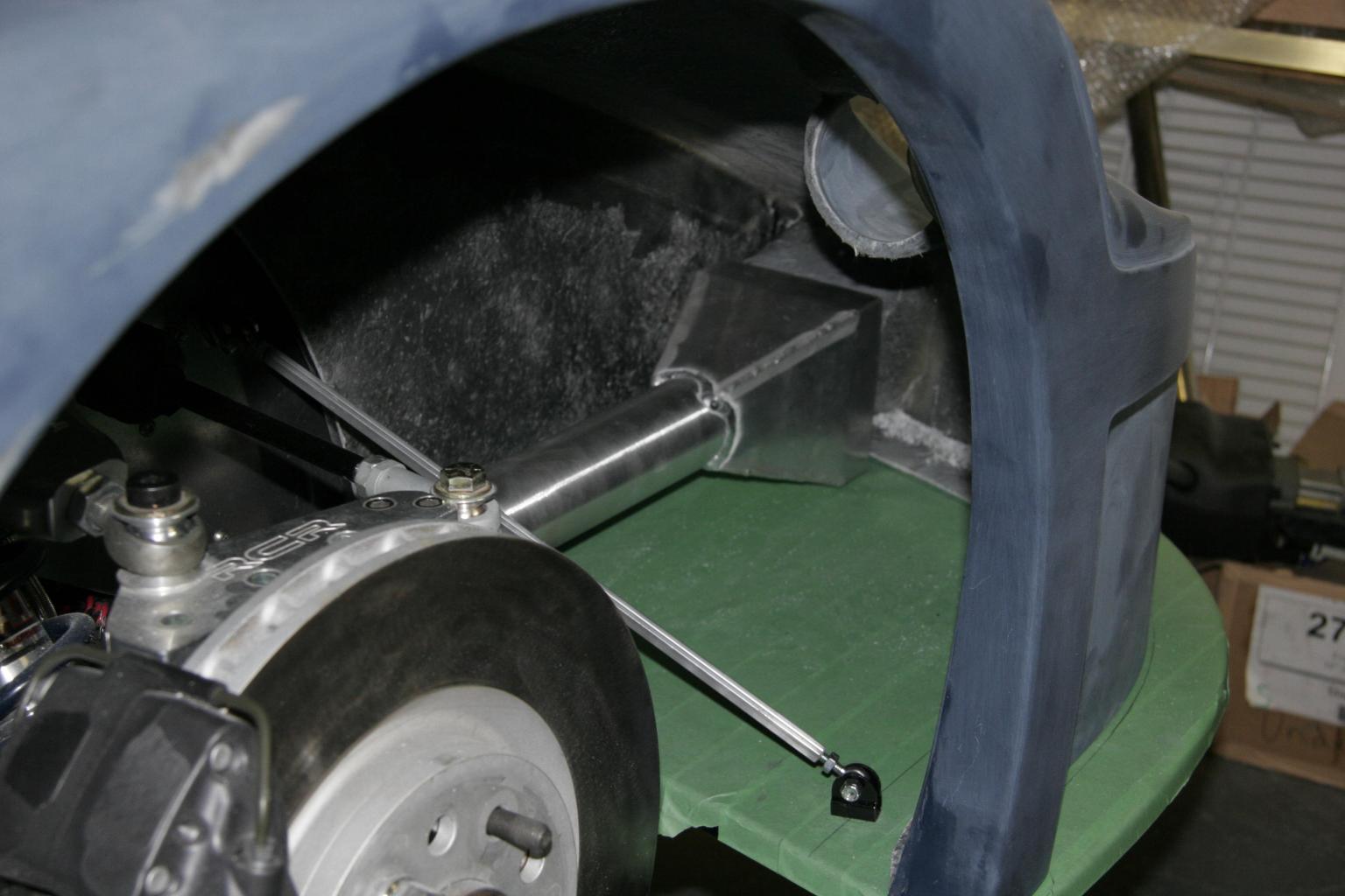

I made some Alum. Sq to round tubes to direct the air flow from the front clip to my front Calipers, these will be a two piece deal when completed. The long tubes will be permanently mounted into the front clip and will terminate flush with the inner wheel well. I will have second short stub tube mounted to the rear of front splitter in line with the long tubes where the Flex hose will be attached, so I will not have to disconnect the hoses when I remove the front clip. I will post more pic's of this when I receive the Brake ducts from Toby at CRC He's made a few of them, knows all the angles and where to put the holes and the price was right so what the heck I can't have all the fun.

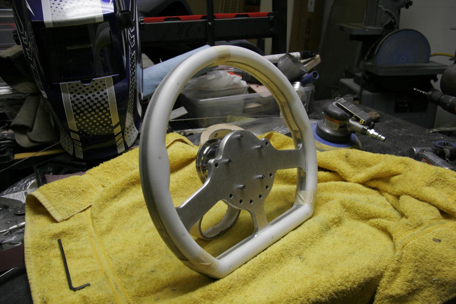

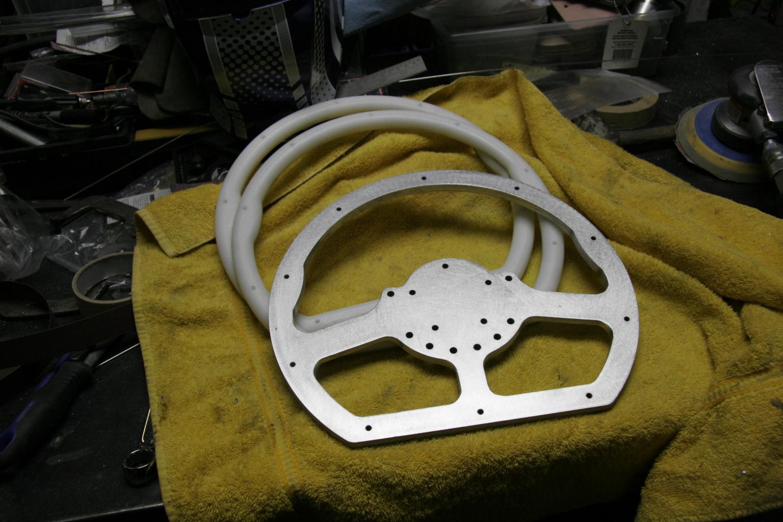

Steering wheel this has been a hot topic lately on the forum. I like the old school race wheel look and could not find anything that suited my needs I wanted it to have a flat bottom for leg room and it needed to have eight buttons, horn, start engine, four for the digi dash, one for lift up and one for down. I didn’t want to have go searching for those buttons on my dash or console.
So eventually I gave up looking and just made one, here what its looks so far but it will get the buttons soon as I just received them from China a couple of days ago, good old Ebay, then I will sew some leather on to it and wire in the relays with a quick disconnect coil cord. And Hopefully everything will work as it is a Sh*t load of work for a steering wheel LOL.

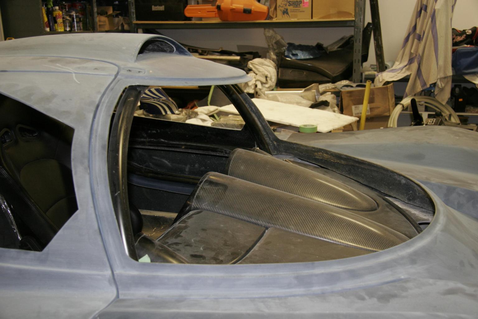

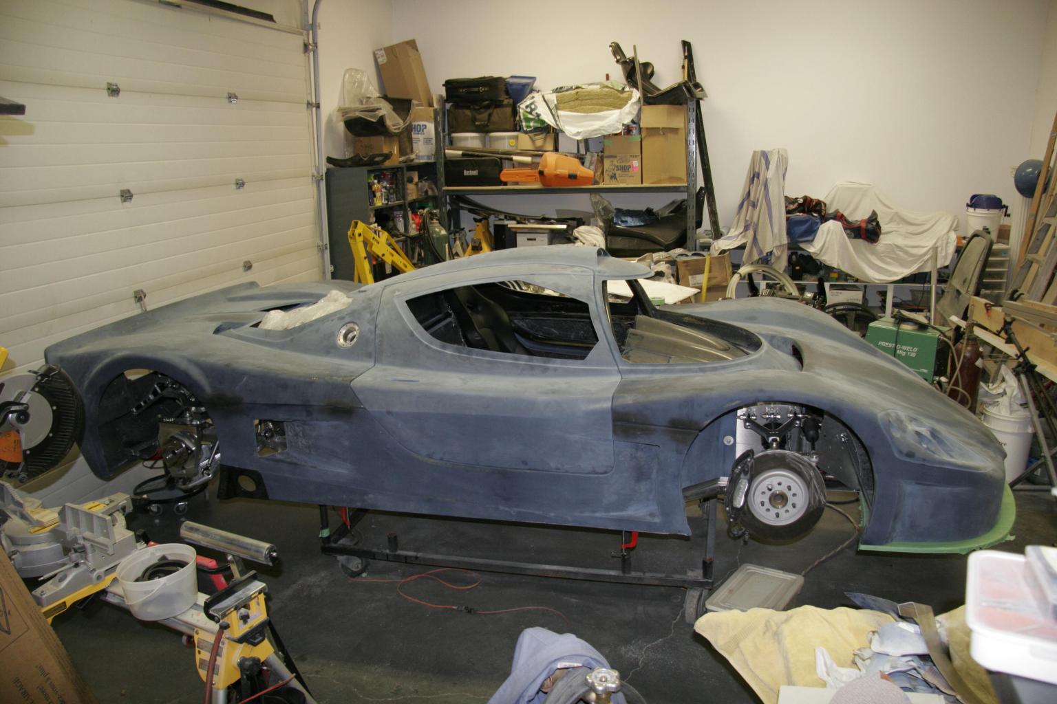

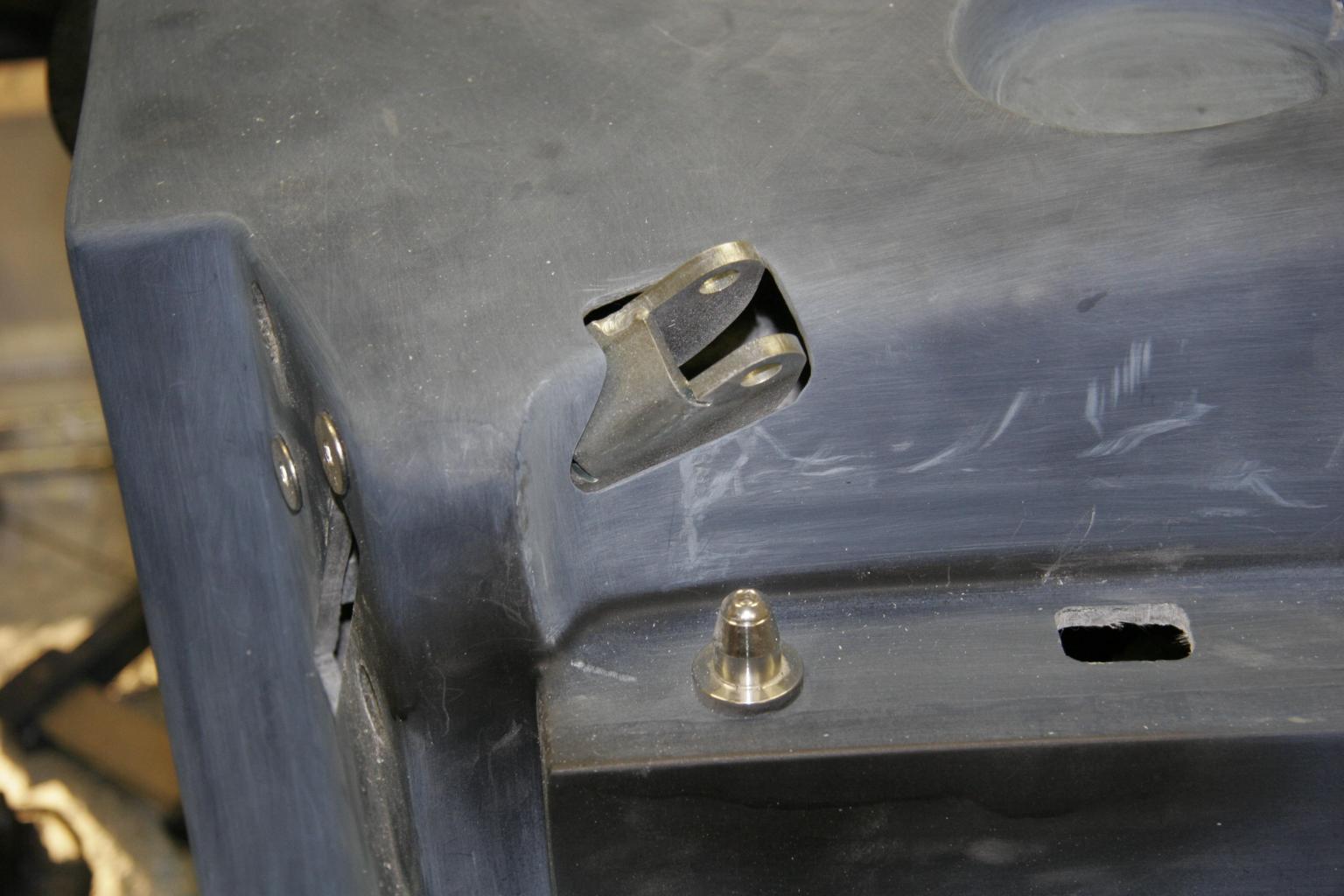

Body work, I choose to do this work myself but while I was doing It had wished I left it for Fran’s guys, I still Etch from time to time. but now that the hard parts are mostly done I am glad I did it. It made me have to do some thinking, not ever seeing a SL-C in person before made poking the hinges in a bit the challenge, and the Aero latches are time consuming but doing this work does give you more control over the way your cut outs are done and lets you radius all your corners. We had some very hot days here in the summer which helped very much to see if there were any air pockets in the gel coat. Pretty hard to find an oven that will fit a car and waving a heat gun around for hours isn’t much fun. After that, I blocked the whole car out with 180 grit and yes I blew through the gel coat numerous times. I was not worried as I will be coating it with an epoxy high build primer and blocking it out a few more times before I paint it. It will be flat and I am hoping not to have any fiberglass telegraph through the primer into the paint as I want a glass like finish.

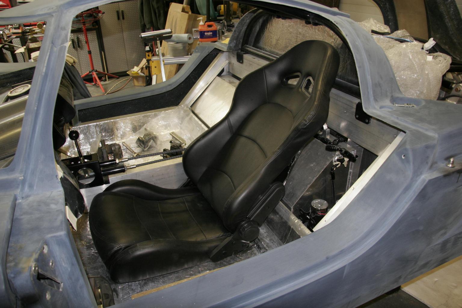

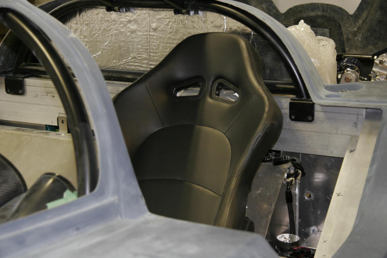

Seats this is still an issue for me. I couldn’t fit into the factory seats even if I lost 100 lbs, it just the way I was made. I am wide, not fat, just wide. I did find a seat that fits into the car. Its a World Performance Pro car seat. They are nice and are about as big as you can go and still fit it in there.
I had the bottom of the seat scooped out so your just off the floor and as much off the sides as you could go without chopping into the actual body. I don’t know if I am still quite happy as I have over a hundred G’s into this and I wanna be real comfortable, I am thinking this may be another custom deal where I am going to have to build my own. I am still looking as I don’t really wanna have to do this if I don’t have to. I will use these for now and who knows what may come along. If someone is interested in them I may let them go and I just get started on some XL gentleman seats. :cry2:

Hi Ken I am not doubting you but could you elaborate on this ? I wasn't sure myself and had asked if I could do this before I did it, and was told it should not be a problem, But that doesnt mean they were right either.
So what will happen slow warm up ?? or does it need this to bypass until the thermostat opens ???
Grant
Grant
I forget why now, but he's right - on an LS loop them together. There's a common hose part # available that will do it.

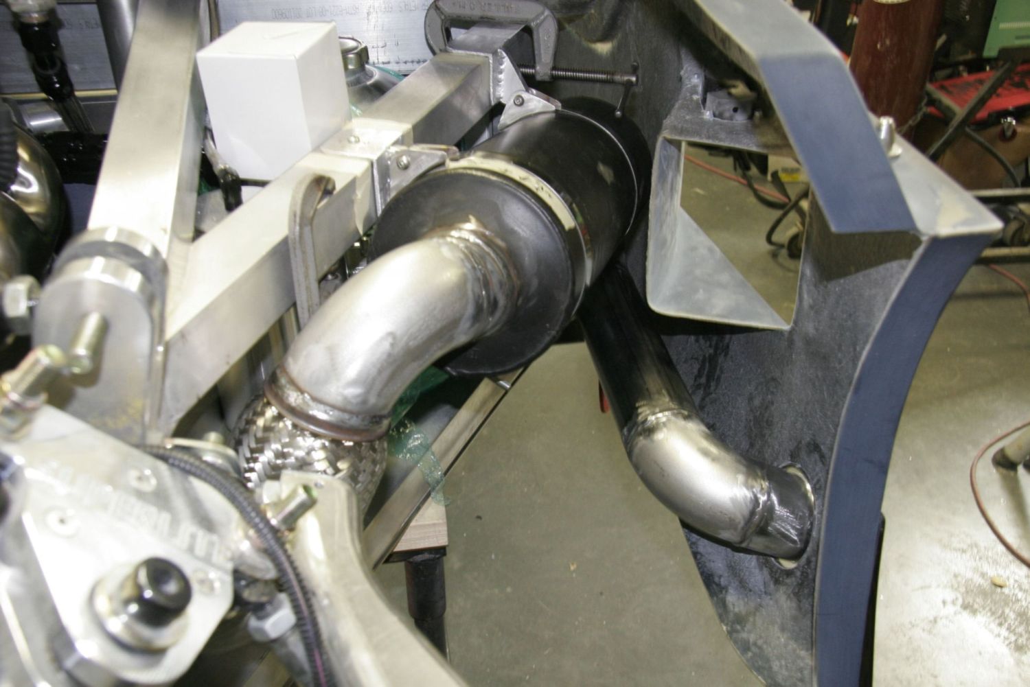

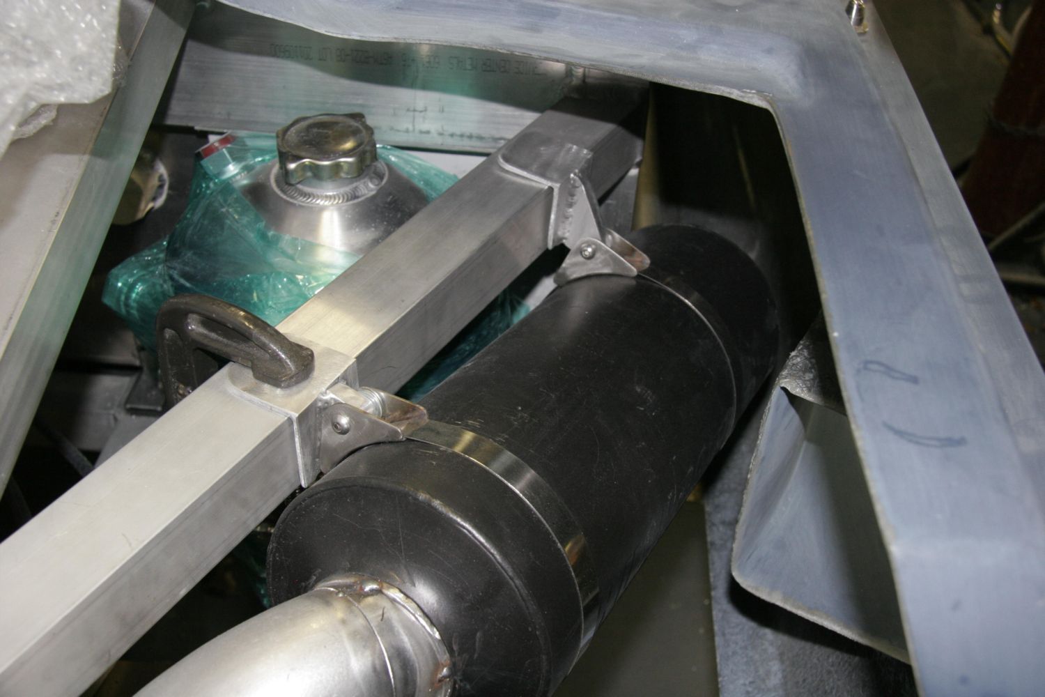

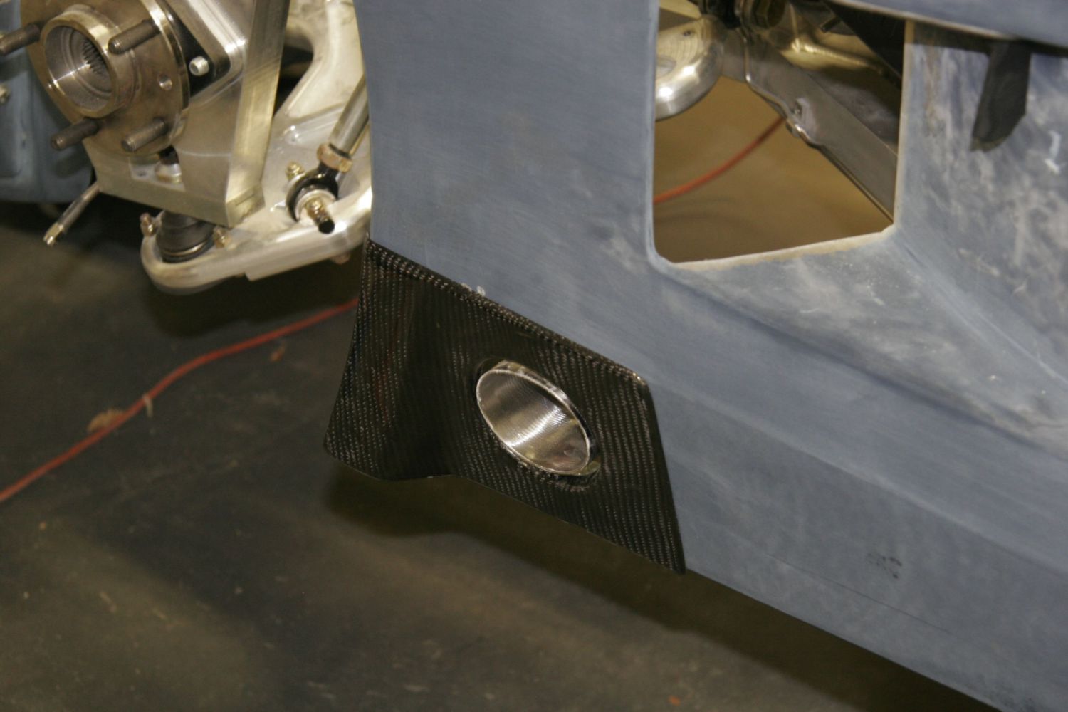

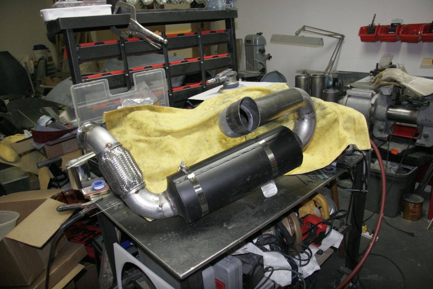

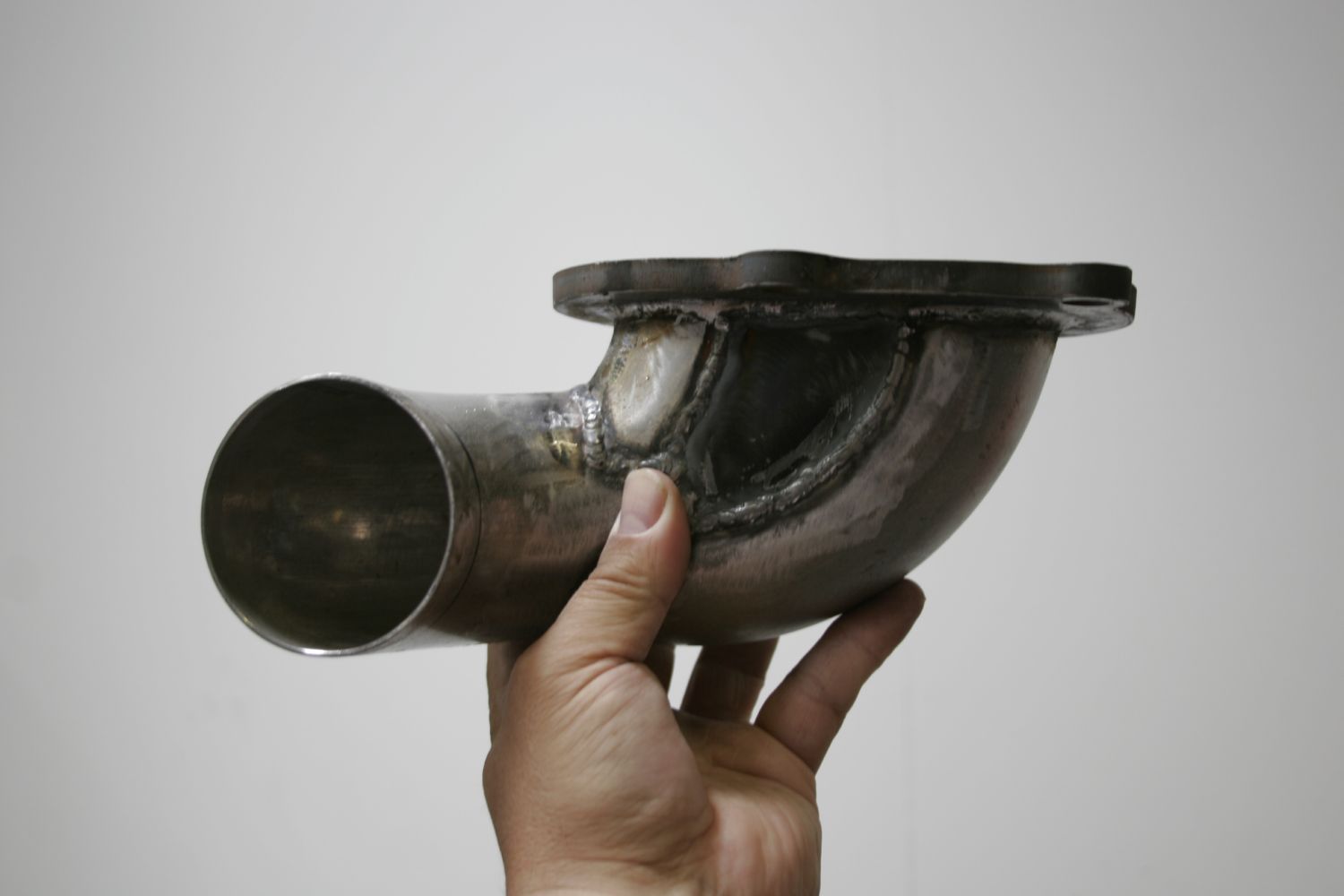

Exhaust I wanted something quiet, So I looked around for a long while searching for something that was quite yet wouldn’t kill HP and decided on the Hush powder from Flow master I made some cardboard mufflers of there largest muffler. Here’s where I am with it so far. I used the factory LS7 manifolds, 16 pc’s 3” 90 degree short radius mandrel bends on a 6” CLR I couldn’t get 180’s
Two Stainless exhaust flexors and two 3” flange couplers, Four 6” HD SS hose clamps, 7’ of 3” exhaust tube and some custom made clamp brackets. After the first start up if there are no rattle issues they will then be sent out for the ceramic coating.
Also with these Flowmaster mufflers they have a cool can technology so they shouldn't be much heat radiating from them.

Perfect for side exit exhaust. Well done
