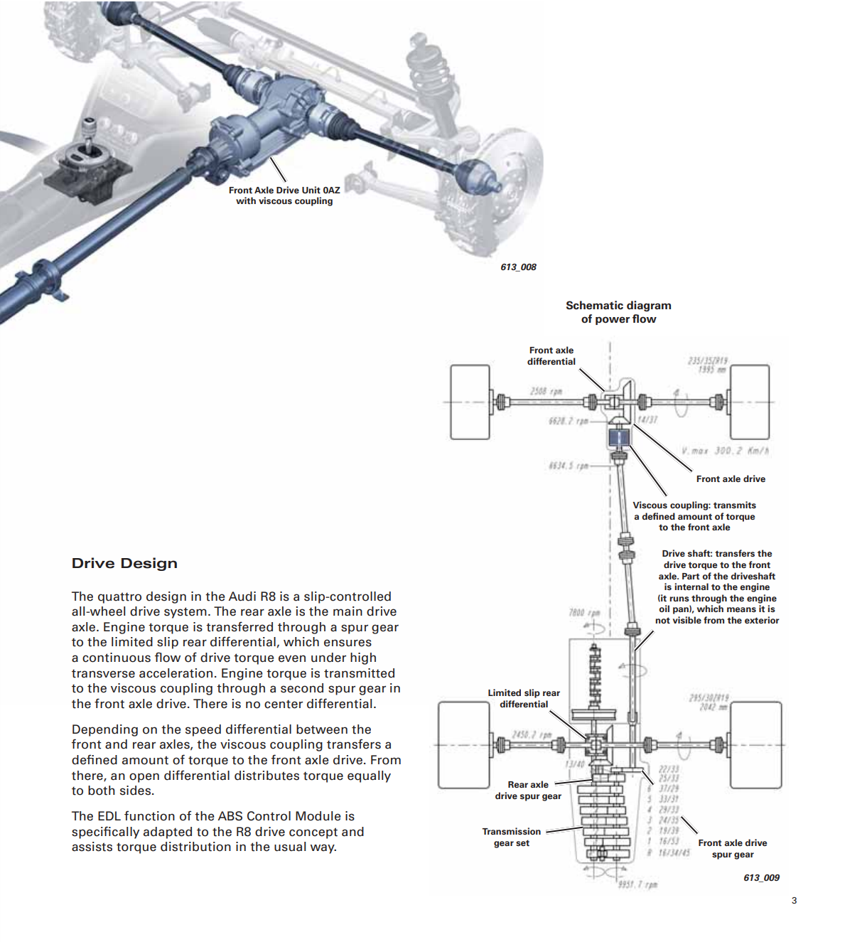

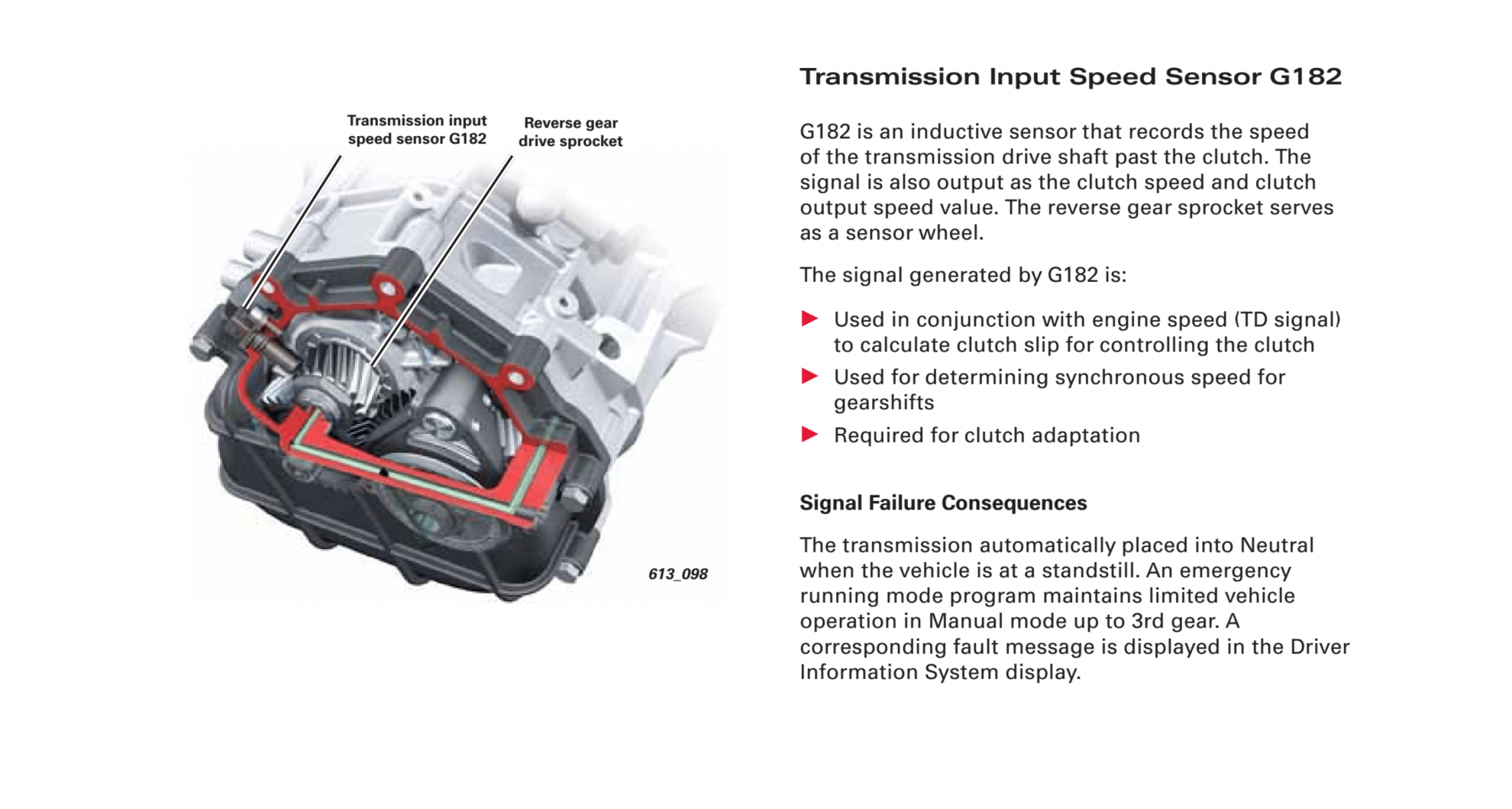

not to dig up an old thread but i did some digging thru the r8/graziano service manuals and found some very useful information. First of which, the speed sensor on the back of the graziano cannot be used as a VSS. It is of the appropriate type sensor (inductive magnetic probe sensor) so it will physically attach and read signal to the GM ECU, however the sensor is reading off the input shaft (reverse drive gear to be exact) so regardless whether the vehicle is stopped or moving, as long as the clutch pedal isn't depressed its going to be sending a speed signal. The signal is used in the Audi as "clutch speed" to detect clutch slip if clutch isn't depressed and its seeing different rotational speed from the engine rpm. Pretty neat....not very useful lol here's the documentation from the manuals....also included is some really cool information and diagram on the r8 drive train (gear ratios etc...)
