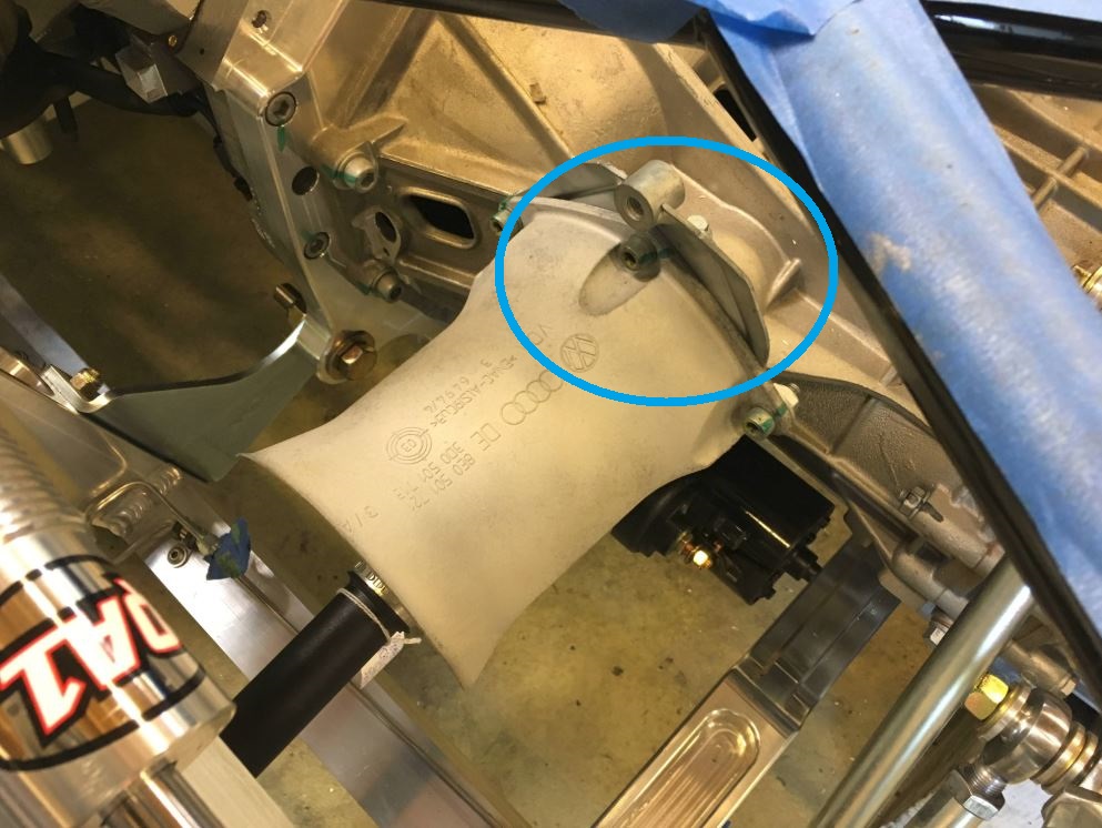

Anyone happen to have a part number for the driver's side bracket that attaches to the transaxle so I can attach the heat shield? I've searched and search with no luck at all finding this part. Barely found the shield on a n online microfiche.
Borrowed Cam's pic of said bracket.
