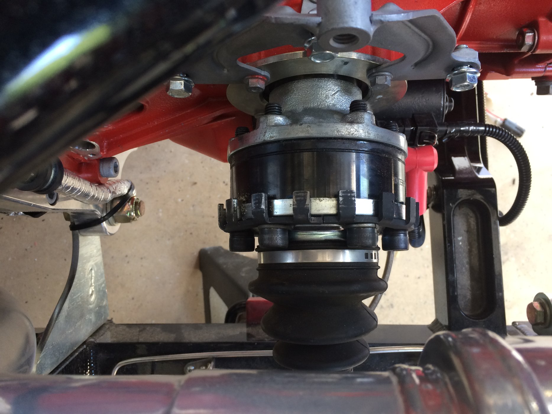

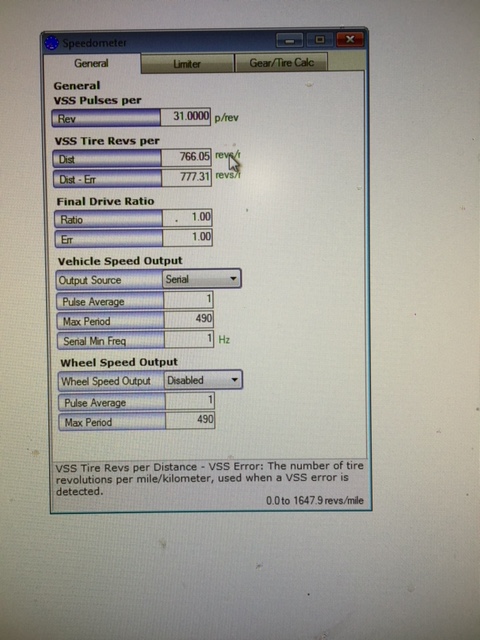

I'm running the LS3/480 with the GM hot cam. I also changed out my drop gear to the .903 set. In lieu of a dyno tune (which failed me three times with three tuners), I opted to use Allan's tuner Ed Gomez of Pro Edge Tuning (Wallingford, CT) and we street tuned it. I can go about 1400 RPM before I feel any cam surge. Street driving is actually not too bad at normal legal limits.
As for the VSS signal, I disconnected my DD system. I'm now using a Porsche reluctor wheel (see picture) and a sensor from a freight liner. I modified the heat shield as shown to mount the reluctor. The GPS speed signal (I used Speed Hut gauges....I like needles) to my speedometer and the ECU speed are within 1 mile an hour of each other. I connected the senor to the two VSS wires. As I recall it didn't matter on the hook up, but I cant find my notes to confirm.
The first pic is the data needed for the GM ECU. The second is the Porsche reluctor wheel mounted. I cut it in half then simply used the mounting bolts for the axle to secure it. The last is the final mount for the sensor. It all works.

Del, I am not 100% sure about this but based on my understanding if you go with a reluctor ring I believe you have to account for the right amount of pulses. To do that there are two solutions, DD makes a box to convert the number of input pulses to output pulses to match what the ECU expects. Or there is a field/variable in the ECU that a tuner can change to match up with whatever is coming off of the reluctor wheel.

I initially had the DD hooked to the VSS and ECU. The ECU wants to know the car is moving. We discovered the DD was not fast enough feeding the ECU at slow speeds. So we disconnected it to the ECU and went mechanical via a ring to feed the ECU. It’s a very simple process of data entry to the ECU if you have access to that specific data entry window. Since feeding the ECU reluctor data, we have not had any throttle or stall issues. I no longer use the DD.
