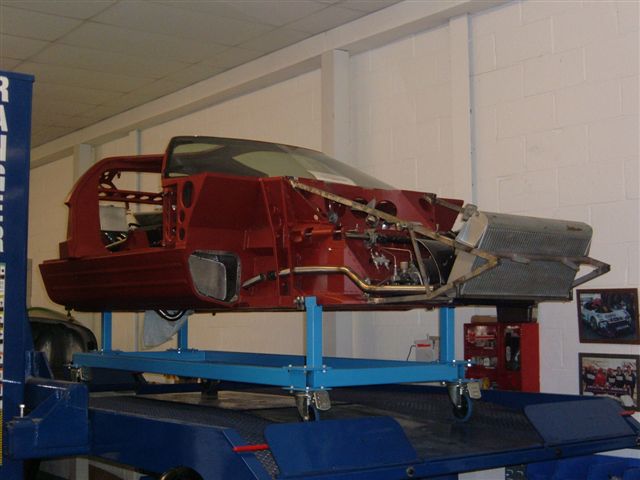

question: on the mk3 the gearlever is in between the seats,and handbrake.
If the mk3 is based ont he mk1 chassis, where is then the "big" central tunnel, and where are located the cooling pipes on this car?
How are the seats fixed? Are the seats in "fixed way" or on rails?
Has anybody perhaps a picture of a naked mk3 chassis? to see how the chassis was build in the interior.
Any reason that the full filler caps where put 180°around compared to an mk1?
Many thx upfront
Paul

Hi Paul,
There is no central tunnel on the Mk.III and the cooling pipes run down either side of the car. The seats have some adjustment backwards and forwards as the pedals are fixed.
As for the fuel fillers, I'm not 100% about this but I would guess that as the front wings are higher on the Mk.III, the fuel filler cap probably catches on the bodywork if opened forwards so was turned around to avoid this.

Mk3 water pipe position for you.
Regards Steve.
