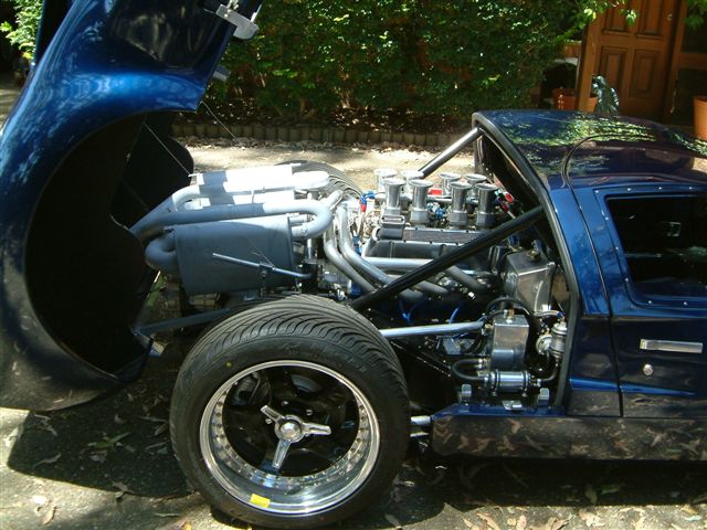

I'll try to post a few updated pics - not that there has been much change, but they may indicate the pathetic levels we have to go with to meet emissions & noise regs. 10 x Brownie Points to those who pick out the painted (some may call them temporary) exhaust bits. For some strange reason, the concept of having a hugely ugly exhaust system, fully ceramic coated, & just hanging on the garage wall, doesn't seem logical to me !!!

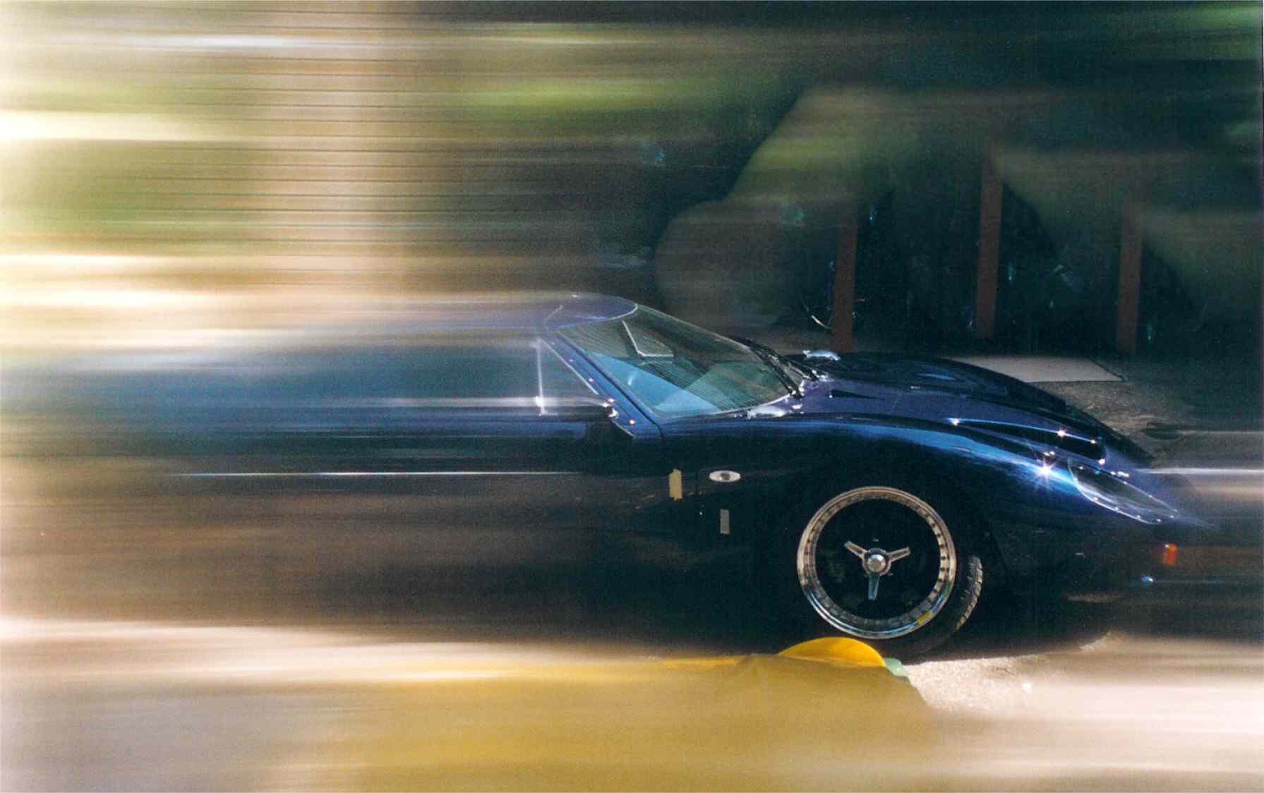

Peter Delaney
No speed limits in my driveway - specially for unregistered GT40's !!
Peter,
WHAT A GREAT PHOTO!!! If it weren't for the BMW under the carport, I'd swear you were doing 200MPH! Your driveway isn't that long, is it? /ubbthreads/images/graemlins/wink.gif

Peter Delaney
Hi Bill - what BMW ?
The driveway is 120m long, so launch speed into garage should be about 100kph !!!

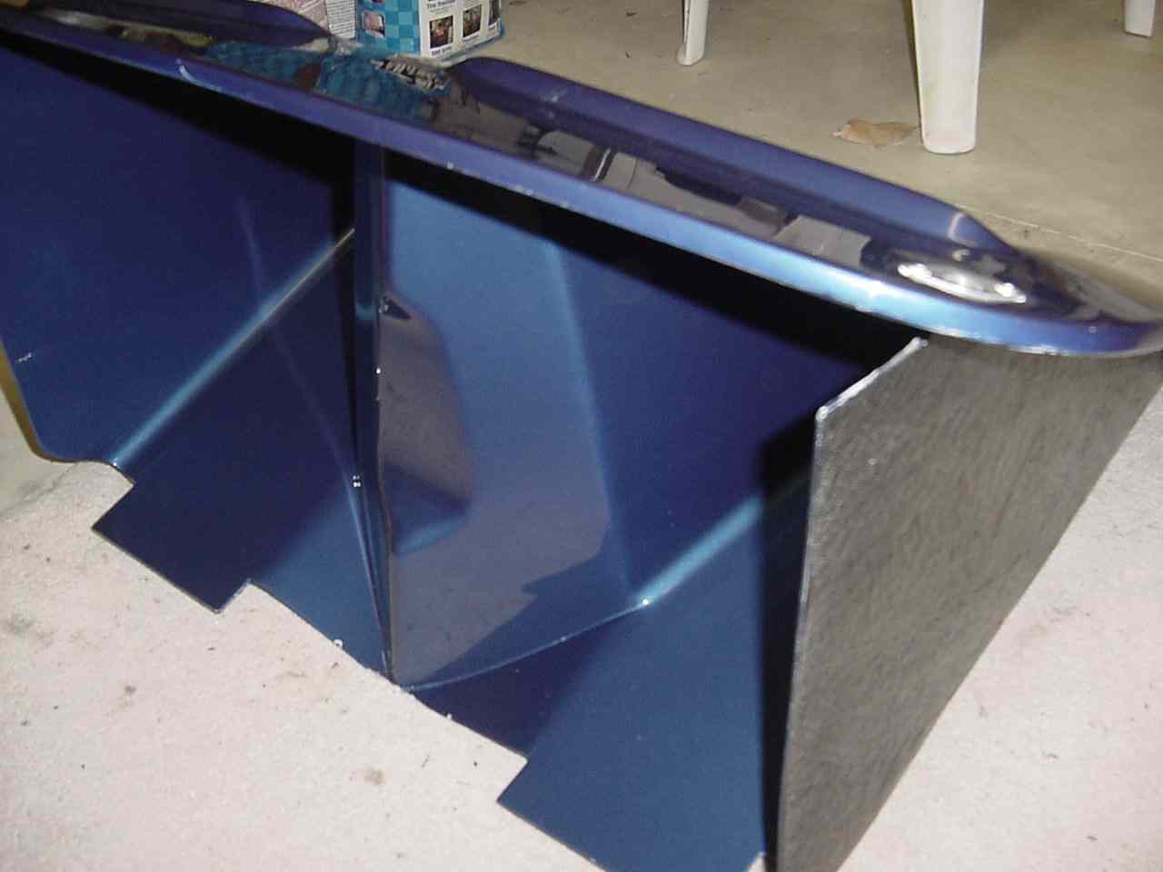

Peter Delaney
This one is Bill's panel sitting on the floor (I hope he won't mind if I post his pic). The long & short of it is that the deep nostril panel really scoops the air out from the whole of the radiator - much the same as a MKII single nostril, but retaining the outside look of the dual MKI's.
My setup runs at 95-98degC for hours in the garage with the fan on, & did quite a few laps of the local area with no fan at 95 or under.
Good air flow thru the rad is one thing, but you still need to sort out the plumbing (bleed from the back of the intake manifold, etc) - this is covered in the thread "Hey Robert Logan" (I think that is the title).
