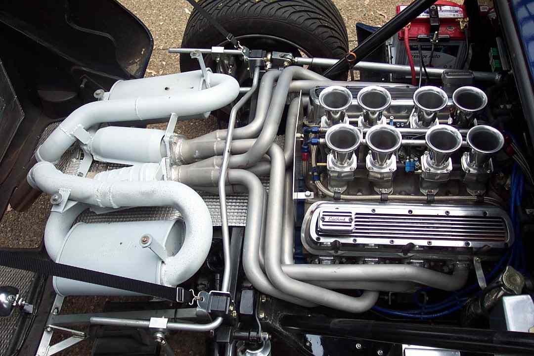

c) Exhaust System : I originally had a somewhat temporary "loop-back" setup with CATS, huge mufflers & lengths of simple "pipe bent" 2" exit pipes - it did the job, but looked ugly & was not too inspiring in the sound department. For a joke, we set up a really basic system where the collectors ran into a single small unchambered muffler - dual 2.5" in, dual 2.5" out - bloody hell ! It was unbearable - rattled all the windows & doors in the house when idling in the garage & was going to get me arrested out on the road ! I went back to the original "loop back" design with CATS, but 2.5" pipes (mandrell bends) & smaller mufflers - this setup seems like the ideal compromise. The house doesn't rattle, I don't wake up any more than the immediate neighbours, & I could probably sit at the lights beside the cops & smile ! However, when it gets some stick over 3000rpm, it is a different story - the famous GT40 howl just takes over ! The attached pic shows the new setup in rough form - once I get it trimmed up & the outlet pipes set staraight, then it will go off to get coated. The headers had already been done in Jet-Hot & after a few hours on the dyno, looked like I had painted them in grey undercoat - not happy ! I am taking my time in looking at alternatives, but a new teflon coating is looking promising (see pics in Gallery - Chezzeris).
d) ECU Tuning : Due to the extreme time constraints in getting the car through emissions testing, we only managed to map the really basic things in up to 3000rpm. Now that things are more relaxed, we have had an initial shot at finishing the mapping & the results are amazing - I reckon that we are seeing at least another 80-100hp up near the top end, but all the low end stuff remained the same, but with more torque. Some time in the next month or two, we'll run it up on the dyno to extract the last few percent !

Chris, I am phobic and paranoid about heat around the engine (specially after melting a perfectly good gear-shift cable a few months ago). The webbing straps are removeable - they just have a hook at each end & they normally live in a door-pocket.
Re the heat, I have little heat shields all over the place :
- between the headers & the back of the fuel rails
- over the exit points for the fuel lines coming up thru the tank cover
- between the headers & the swirl tank
- round the nylon bearing blocks for the rear sway bar
At this stage, they are all just raw aly, but when time & $ allow, they'll get the teflon coating treatment.
The whole of the underneath of the rear clip is insulated with some 1/2" peel & stick high temp foam stuff (done mainly to cut down on mechanical engine noise for the rego tests), & then the area directly above the engine/exhaust has the standard silver RF heat shield sheet as well - its not quite as good a fit as when fitted to an RF, but very close.

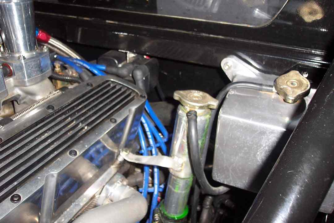

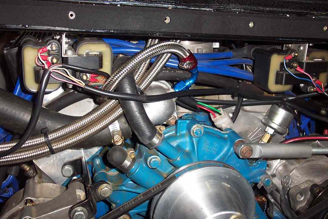

Cooling System Leaks - Right from the beginning, I had an annoying minor leak from the top of the header tube – when the system heated up, the excess coolant dribbled down the outside of the tube, but when cooling, it seemed to suck in fresh coolant from the recovery tank. This meant that the system never actually got pressurised, and I had to keep an eye on the coolant level in the recovery tank. I managed to forget about this once, & was rewarded with air in the system, boiling, bleeding, bleeding & more bleeding !
Check the green goo !
Kind Regards,
Peter D.
Peter Delaney

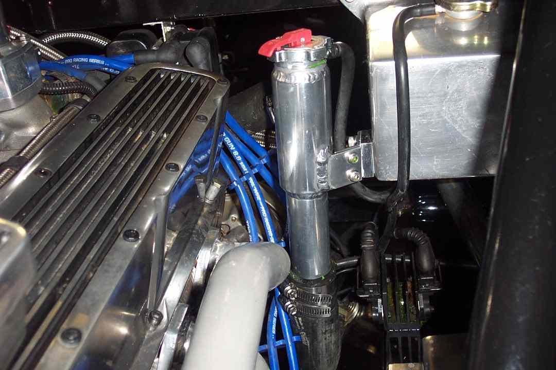

That was it – time to do something. Peter Ransom at GT40 Australia very kindly sent me a brand new header tube which was made from thicker-walled alloy tubing & had a really nice machined billet top for the pressure cap to fit into.
The pic shows it mounted off the recovery tank, as opposed to the old setup where it was mounted to a rocker cover bolt. The green coolant in this pic is just a bit left over from the bleeding process - trust me - it does not leak any more !
Kind Regards,
Peter D.
Peter Delaney
While fitting this, I also took the opportunity to change the routing of the bleed line that comes forward from the 2 water ports on top of the rear of the DC&O manifold. This was originally fitted into a spigot on the header tube, and not wanting to fit a new spigot into the new tube, I re-routed it to an AN spigot on the RF thermo housing (Robert Logan fits these as standard to his thermo housings).
Another reason for this change was that the original header tube was mounted to the engine, whilst the new tube is mounted on the side of the recovery tank & I didn’t want to transmit the full engine vibration down the bleed line to a small spigot fixed effectively to the body of the header tube.
The net results of this little project were firstly, No Leaks ! and secondly, the system runs about 3-4 degC cooler than before – it will now sit on 88degC with no fan when its moving, & much the same when sitting still with the fan on – why – I don’t know !
Kind Regards,
Peter D.

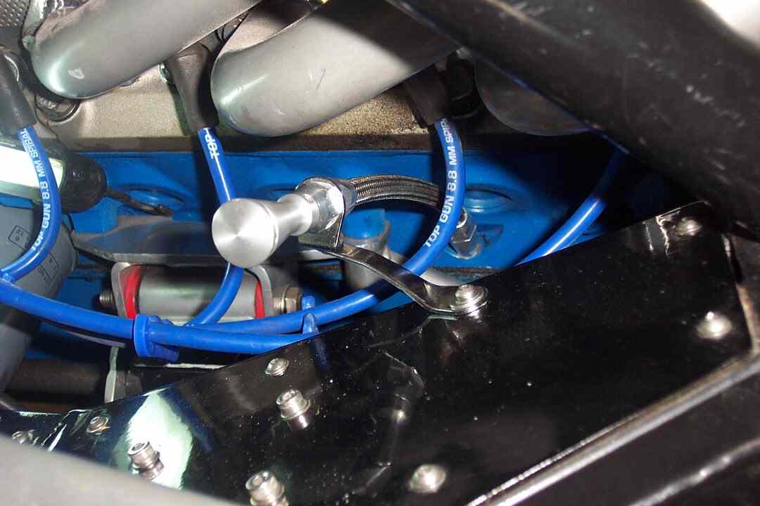

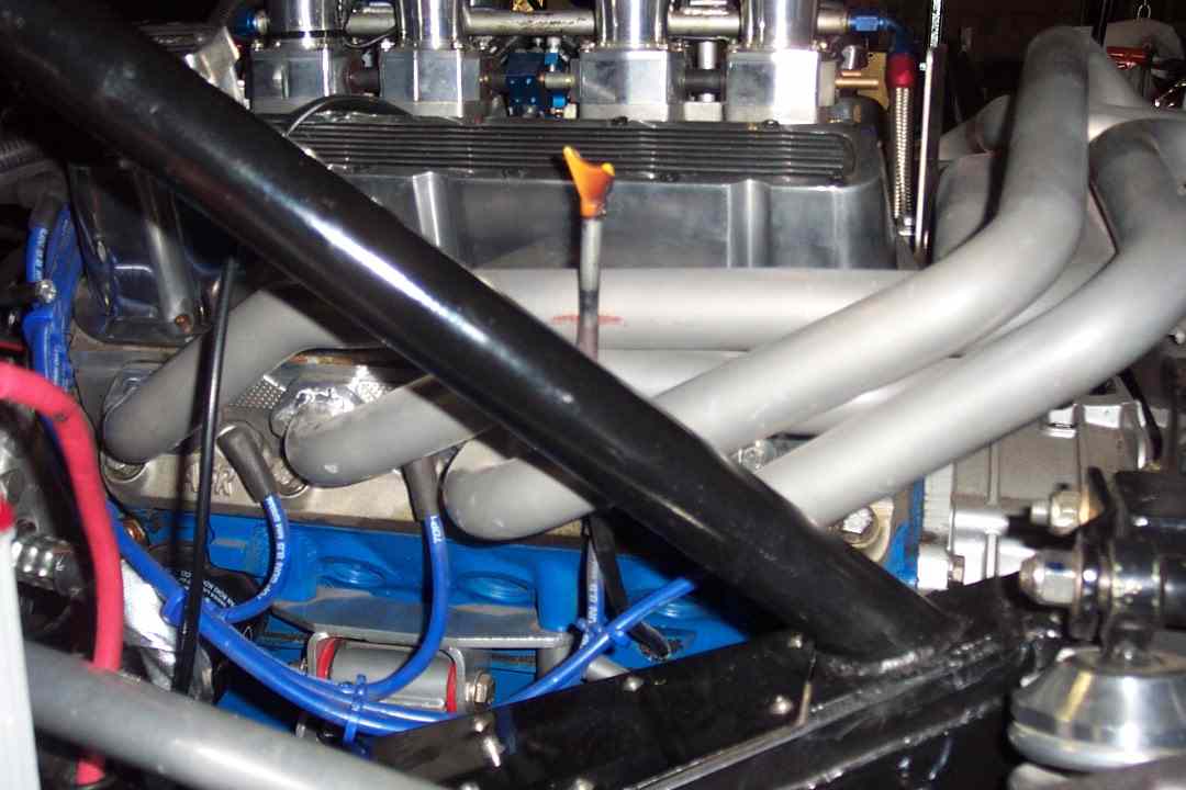

Dipstick Replacement - My original disptick was something from a Fairlane or F100 - stuck up between the headers, no idea of calibration & ended up with a melted plastic handle - absolutely useless !
Peter Delaney
Sorry about my spelling in the last post - what a Dipstick !
Thanks to Colin D, I now have a nice Lokar flexible job that is all alloy and actually reads correctly ! The trick is that if you get the Lokar Part # ED-5004, it is specifically made to fit in the side block entry point of the SB302 - therefore, calibration is unnecessary as the markings are correct for the oil level height relative to the crank, regardless of the size of the sump - you just fill until it is right !
Kind Regards,
Peter D.
