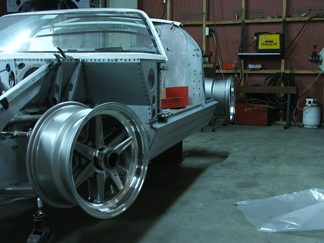

The wheels arrived, however there are some major differences from the origianl BRM's
the spindel length is about 1 1/2" shorter on the front and 1 1/4" on the rear and the spinners are an 1/8 smaller at the taper and thread DAMMM, was told they would fit an origianl car???? will have to think this one through, (make new spindels) but then they wont be correct and I wont be able to fit correct wheels latter?
has any body found the same thing???

Guess it shows just how 'un-original' some replica bits are-- on the CC forum I have noted some comments about differences about this particular dimension also, though not to the amount your dealing with, one thing I suppose, nobody could accuse them of copying the originals dimension wise :).
HILLY
Hi John,
What brand of wheels are these that you are using.
Is it definitely the wheels that are at fault?
I'm curious about the requirement for any DOT certification or other certification for these wheels also...
Pity that they don't fit.. I'm sure you've already thought of spacers and such..
Hi Peter
the wheels came from Vintage wheels, but are made in South Africa by wheelcraft
very nice wheels
I have had a set of origianl BRM's on the car with no problems, looks like I will have to make new spindels and re thread the spinners,
waithing for Bob to come back to me on the situation
and yes I expected some form of approval (dot) hope that does not cause me problems with
certification, may need a form to say they are ok ??
had problems with freight as well, may be I should of gone for the correct thing!!!
HILLY
I agree John,
Sometimes the more expensive option works out cheaper in the long run.
Was there much of an initial saving on these??
It will be a shame to go to the effort that you have and then have to modify the correct items to make the incorrect ones fit.

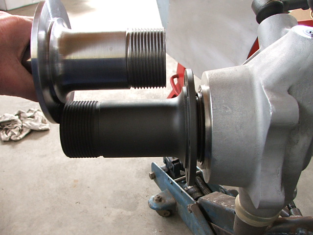

started making new spindels this is the rear one on top the front needs to be shorter again

John, I wonder if the spindles were lengthened to accomodate the increased loads from increases in width and/or offset on the originals, and the aftermart boys have just stuck to the one size fits all to save $$$$$.

Looks like my mistake, I am making to Gulf spec so things are different to std MK1
so a slight setback, nothing that cant be fixed, I should ask more questions when

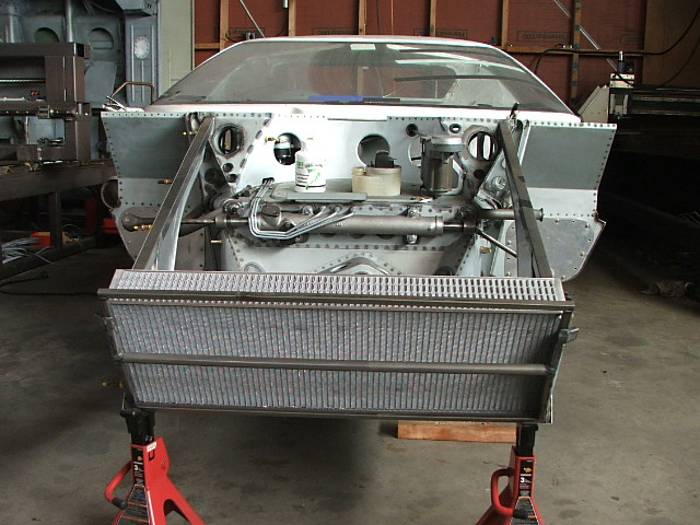

I will be working on the tanks for the radiator soon, if anybody has some good photos of original radiators please forward to [email protected] as you can never have too much info, thanks

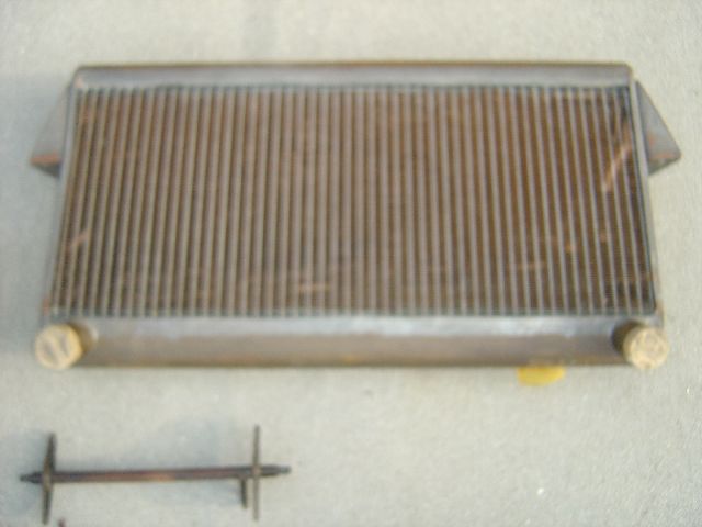

John I still have a NOS original Mk1 radiator and will ge it out and take some new pics for you

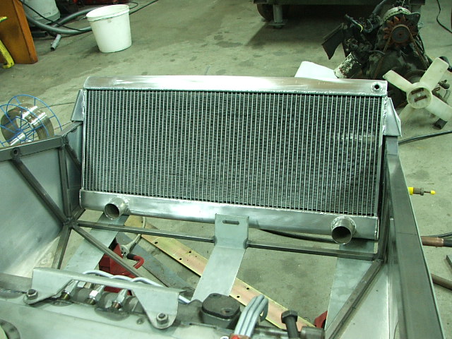

A big thanks to all who sent photos of radiator, they where all different, no surprise!

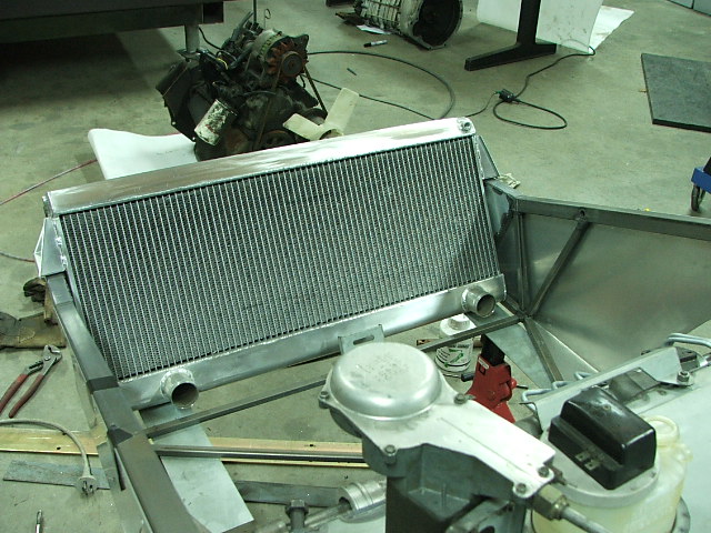

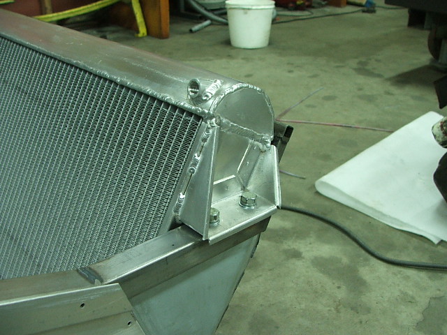

just about all done, can some one advise, should I paint it or just leave as alloy finish?
