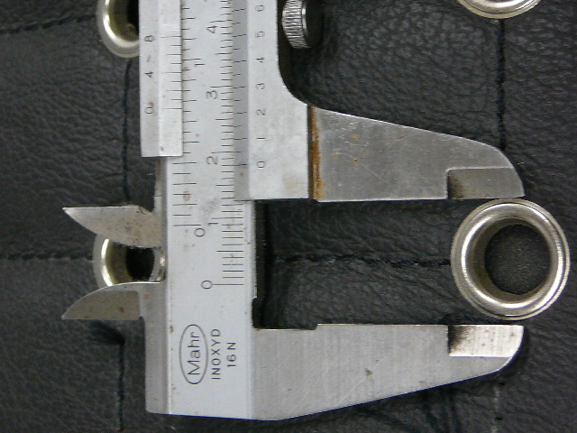

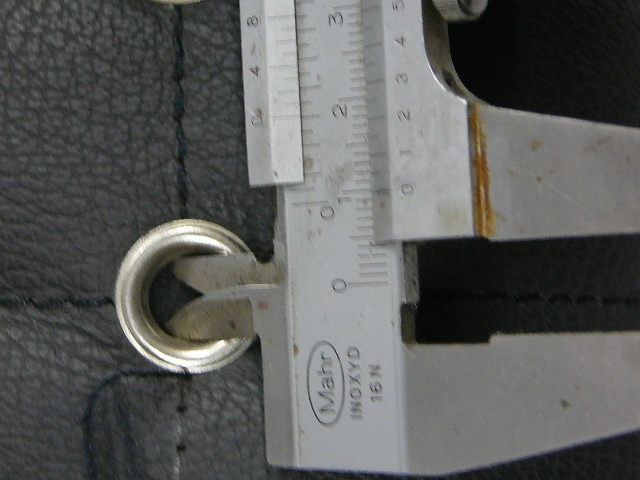

Hi Guys,
I am just looking for the grommets used on the seats.Mostof the ones I found here are too big from the diameter of the "collar".
I am replacing one seat and need the matching ones....Who, where ?
Thank s a lot....
