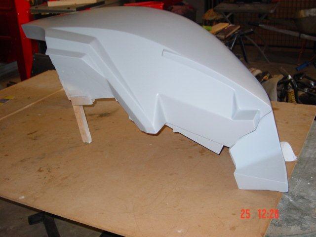

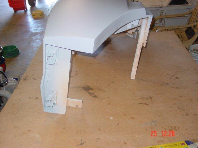

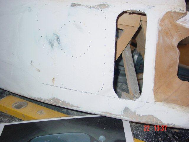

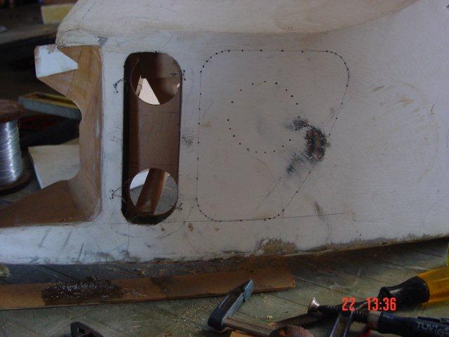

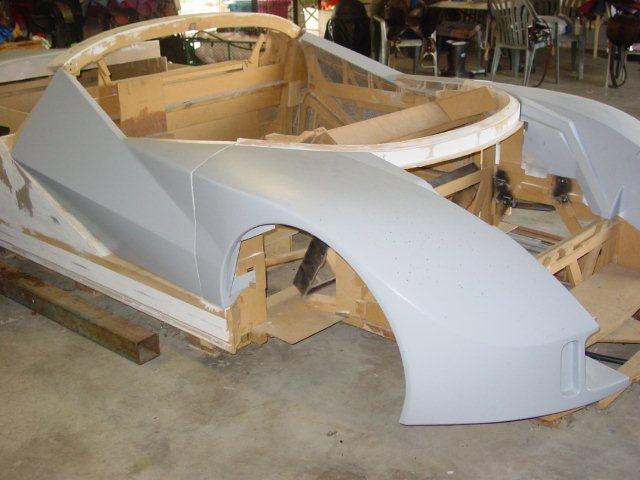

First two are front brake air intakes roughed out and indicator lamp sockets through drilled so they can be located from rear once the surface is finished
Headlights have been interesting to source and sockets will be cut in after the guard surface is finished

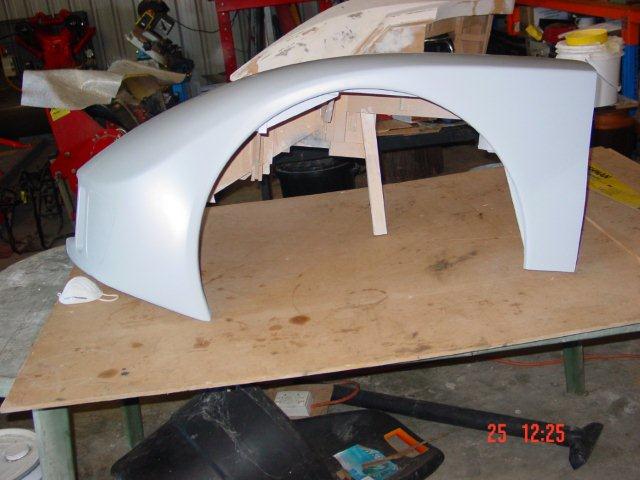

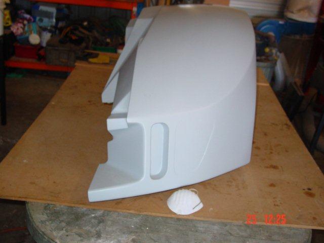

rest are left front guard almost finished

Des, if you had to do it again would you still go with the mesh for a foundation to build it on??
GR-1, yep that could get some more creative juices flowing, we had a bit of a talk about it on Club Cobra a while back... better finish some of the current projects first though... If Donna got to hear of it she would be grabbing the ute for a quick trip into town for some more MDF & a few sheets of mesh etc, its tough havin a missus who likes all this stuff........!!:)
jac mac
yes for one there is no way I can afford the price for a full size 3d router nor can I afford the cost to outsource it
with mdf and mesh I have been able to tweak it as I go which is easy to do at CAD stage before routing but not so easy when you want to sit in it and get the feel and then make changes
I have also been able to construct a model of a large portion of the chassis as it has been done
Des

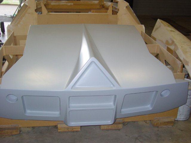

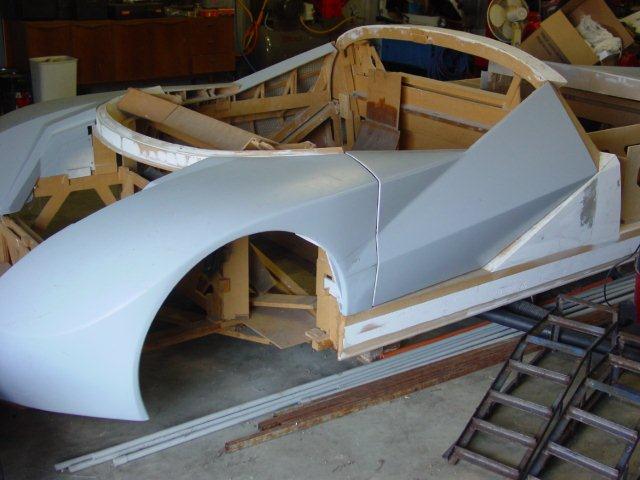

both front guards, the doors and the rear deck are at the next stage
rear guards are next
like the number plate
sorry for slow updates been doing some killer days/weeks with that thing that pays the bills
we were not affected by floods for those that know of the Queensland situation
merely inconvenienced by nearly 6 months of rain and some road closures
we are on a hill and some 985 mtrs above sea level
the mdf in the plug did swell slightly due to all that moisture and the gaps went amiss and things did not fit for a while all good now
