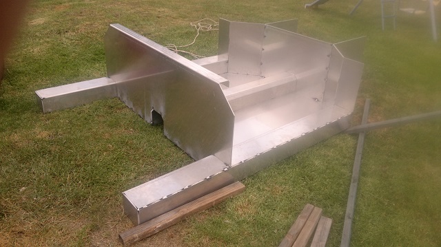

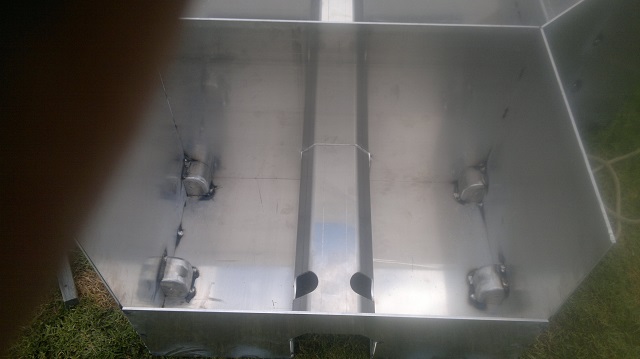

Ok a couple of chassis pics
Center section ie main cabin and both firewalls
second pic is lower front A arm mounts
NB this is the prototype tack welded chassis and subject to mods as it progresses

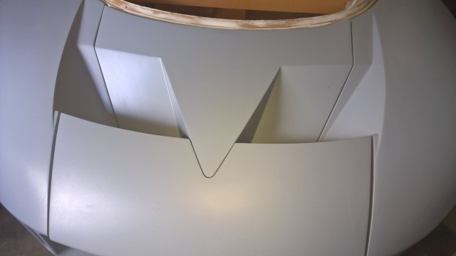

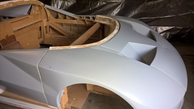

meantime a couple of pics for you
Building a website as well and will advise details once it is up
