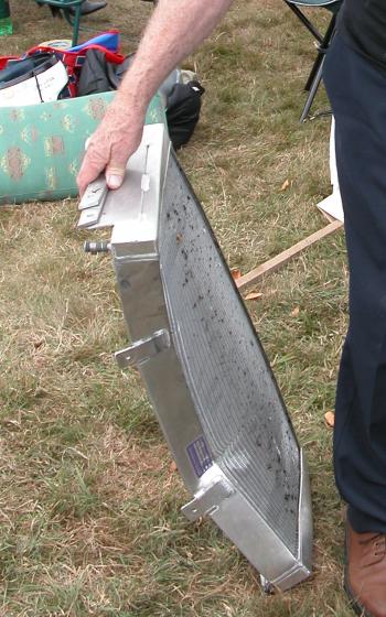

ps - there's a pic of a rad below - that still did'nt leak! despite a minor mishap! (see video on club website) /ubbthreads/images/graemlins/blush.gif

Malcolm

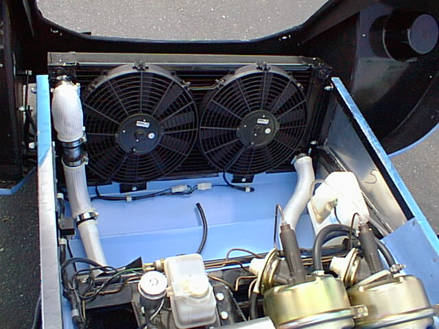

I have drawings, but it will not work for you because I moved the inlet to the radiator up on top. Yours like most GTDs are both on the bottom. Below is the pic of how my old radiator was rewoked

I will see if I can get you a copy of the drawing. I may have one or at least I know who does so I will ask for you. Heck, it won't weigh too much, will it?
Fali, I too moved my inlet to the upper corner from teh bottom thinking it would be an improvement. On a back to back test, it made no difference on my car. I didn't have much of an ovverheating problem to begin with, it just looked wrong to me but turned out not to be the case. Did you find an improvement with your conversion? When I fitted another standard GTD rad after a competition moment involving a sodding great rock, I left it at the original design. My new ali rad to be fitted this coming winter is also with inlets low down.
