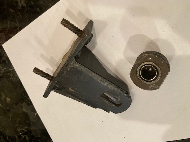

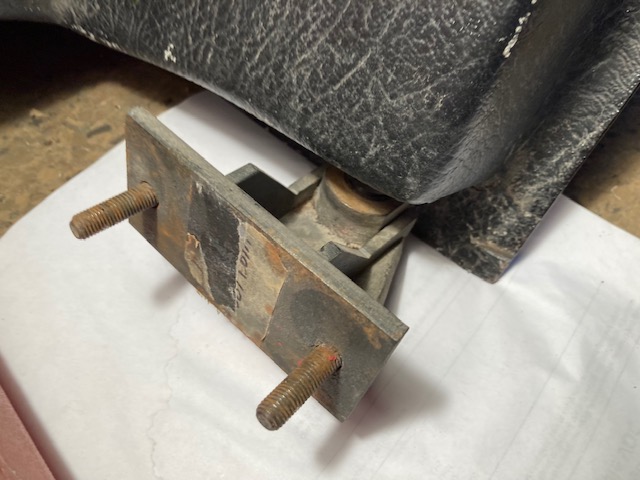

Here are a couple pics of the hinge. This is the lower left.

Hi Morten-
Your hinge looks a little different, may talk to my fabricator to see about duplicating the original.

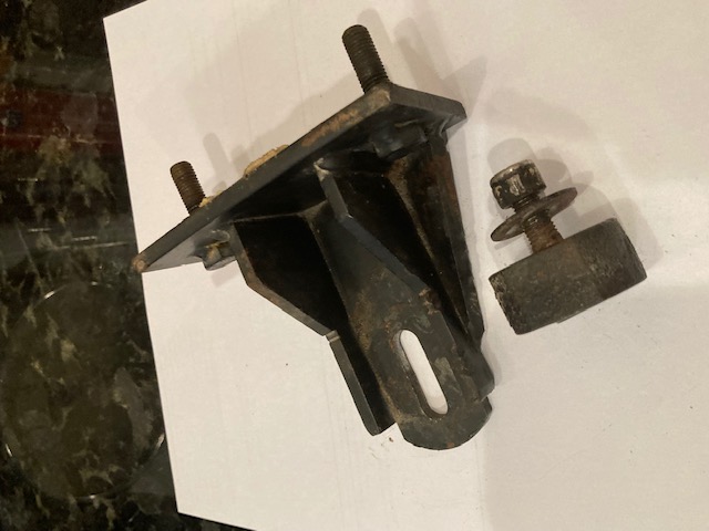

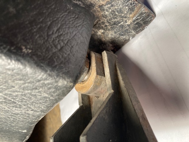

I pulled the left lower hinge off, on closer examination it does look very similar to the SGT.
Will check with them.

Something like this?
spherical bearing ID 0.500in
These hinges are exactly the same as I have on my SGTs. Easy to make a new one.
Regards
Morten
I see these spherical bearings are available at bearing supply houses, also see similar bear used on shock absorber ends.
It looks like Southern uses a large nut (?) probably bored out to 1.00 inch with bearing pressed in.
Thanks again,
Paul
Morten
Mortified GT
All machined inhouse, bearing pressed in yes. Also need an m8 or 5/16 bolt in the casing nut to secure it to the steel hinge. Or replicate the one you have. Good luck:)
