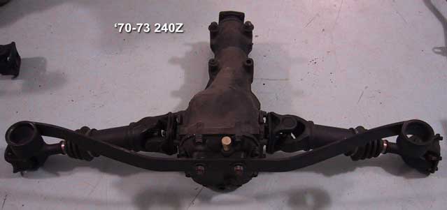

The Z I race operates at about a 7-10 degree angle, but it uses these extremely heavy half shafts that have U joints on each end with a shaft that plunges into the body of the other. I've got a bunch of them under the house as a racer gave them to me saying "these break all the time, you'll need them" but I don't believe it. These things weigh a lot and look extremely beefy. Might could be a possibility to use something like them on a rear engine build. Below is a good picture of them in position at about their operating angle.
So the main reasons to use CV joints over a U joint are smoothness of operation and greater angles of use? As Wanni says, looks like it might be fairly easy to get specs on different CV joints and know for certain what can and cannot be done with them. I've got 930 CV joints in the garage, but just messing around with them you can't tell a whole lot.
