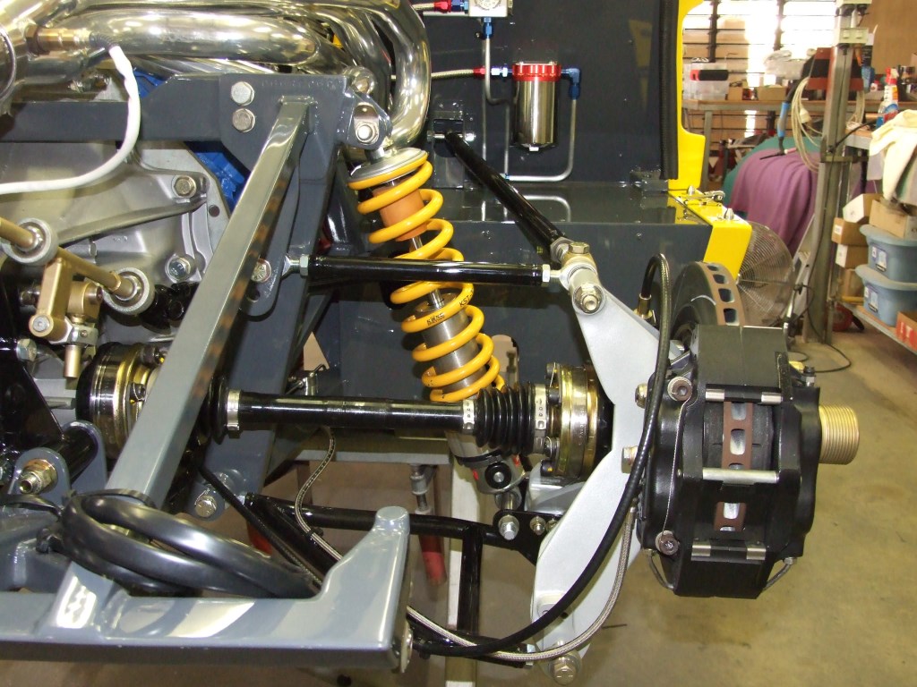

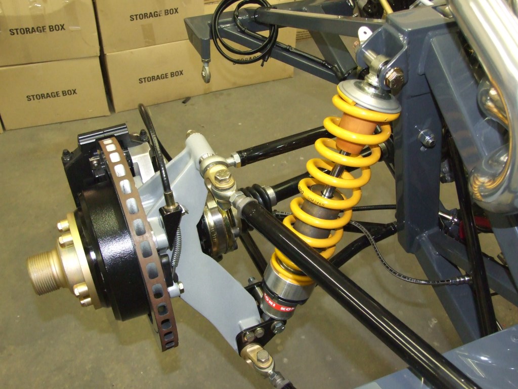

I can see the pulley and clevis but it looks like no more adjustment, hopefully you see from the photo.
[/IMG
Its a internal drum on disc set up
Stuart
I can't see from the photo, need to be higher res.
Have you adjusted the shoe so the lever is fully returned ??
I have a similar setup and have to run the cables a little loose for it to release completely. Lots of bends in my cables that cause friction and sticking.
