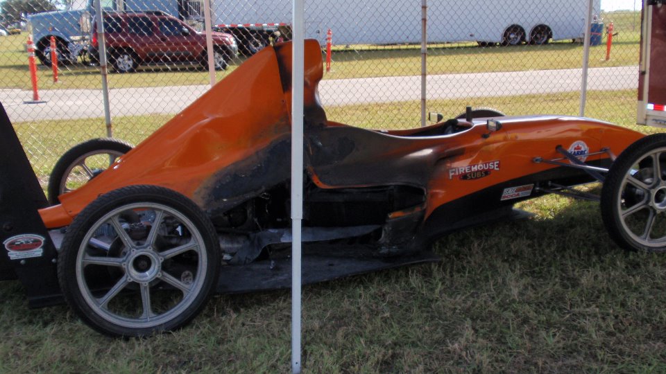

Perhaps I'm a little more sensitized after Sebring as the attached picture was a fellow in my group. When I went by on the track, it was a complete fireball. Fortunately, he (and his HANS) were able to get out OK.
By the way, note the sponsor decal.
