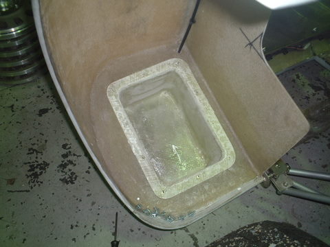

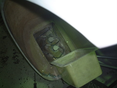

I made these tool boxes to put compressor and tools in for long trips.
Jim
