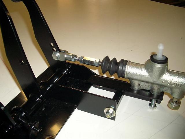

On my car the clutch pedal force was also higher than I liked. It also had a very short range of movement from fully engaged to fully disengaged. And, because the pedal took a lot of force and only moved about 1/2 inch at the engaged/disengaged sweet spot, it was very hard to modulate the position of the pedals to always get a smooth shift.
I added addition attachment holes closer to the pivot point on the clutch pedal for the push rod going to the master cylinder. This changed the overall mechanical advantage of the system.
The pedal now operates with less force. The critical engage/disengage sweet spot is wider and as a result is easier to modulate. Total pedal travel is more than before but still feels perfectly normal. Here is a picture.
