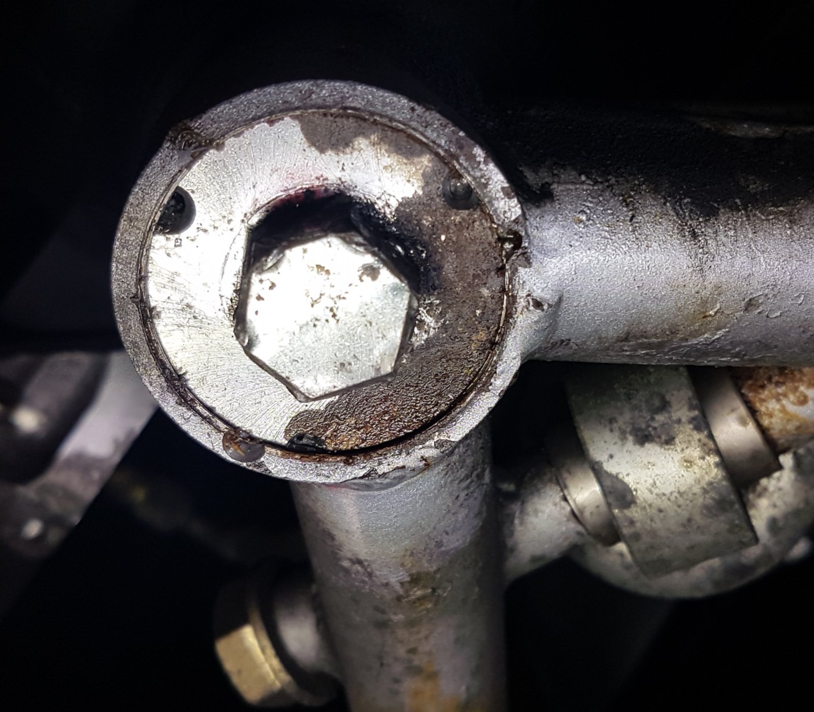

Hello folks,
I hope somebody can help. I discovered wear / play in my lower front a-arm ball Joint. I thought that this can be adjusted by turning the bottom cap!?
Now the cap is secured by center punch marks (see pic) – what is the best method to remove those punch marks? Using a drill / center drill?
Please advise. Or do I miss something?
Markus
Hi Markus,
I would use a Dremel tool with a small round bit. Just turning the hex in the cap should break most of the punch marks anyway. You might be able to tighten the cap to reduce play in the joint, but more likely you need to replace the nylon cups inside the joint. SPF sells this and it's not too expensive. I would not punch the steel cap when you finish. I've never had mine loosen.

Hi Dave,
Thanks for your quick response.
I tried to break the cap free but with normal force (torque) I was not able to move the cap. How much force did you use?
I used a regular 1/2" socket wrench - should I use an extension?

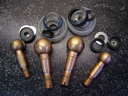

Not familiar with the SPF setup, but are you trying to remove/replace nylon cups 'in situ', ?? Load is carried on upper cup . Is that nylon or coated steel like originals. What Im suggesting is that a small amount of vertical play in the extended 'no load' position may be quite acceptable.
Damn, this forum wont edit after 5 minutes! PIc is from Jimmy Macs thread & shows black upper nylon seats, I would imagine the lower ball joint would need to be removed from upright in order to replace without splitting or modification of the black nylon seats. ( 2 inners are lower ball joints ) Rather than center punch you could drill the hex head for lockwire, Dave M suggestion of Dremel rotary burr to remove center punch material will work. Once the hex nut is free you may be able to simply adjust/tighten. Use a single hex impact socket on the breaker bare to loosen/remove, in fact a socket placed on the hex & given a sharp clout with hammer may help break threads free for removal.

I would agree with JacMac that the actual ball of the joint has to be removed from the upright to replace the nylon cups. However don't do that until you have loosened the cap. I used a 16" extension to loosen my caps and a hammer blow may be necessary.

Jac,
Those plastic cups of mine are made from graphite impregnated Nylon 66.6 which is pretty tough stuff but machines quite easily.

Here we go:
I'm done :)
The first side had heavy punch marks so I used a center drill to remove them - with a medium size extension I was able to adjust the cap (more than one turn necessary) - I did thigten them right away and did not try to get them out.

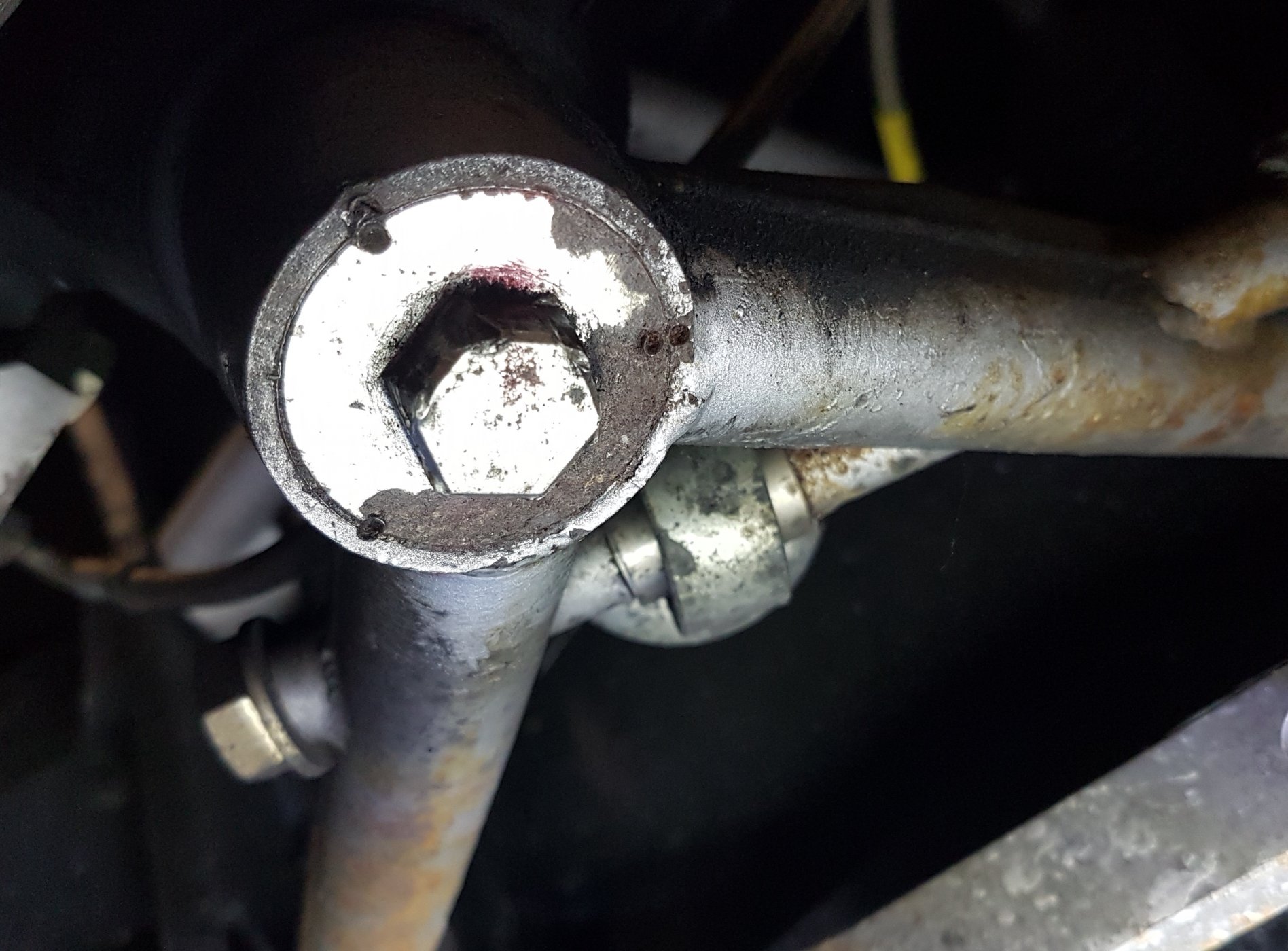

On the second side the punch marks have not been too big (no Actions taken here) - with a similar force I was able to adjust as well.
