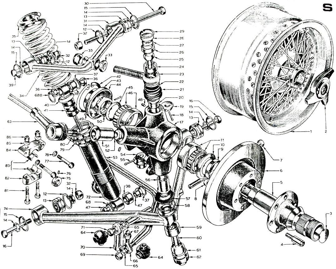

In the FAV parts book the components of the front lower control arm outer ball joint are listed as follows. I'm curious to know what the "74..." designations mean (if anything), and more generally were these parts sourced from some contemporaneous mass production vehicle, and if so which? Also, what method was considered to be proper for securing the "ball stud adjusting cap" in it's adjusted preloading position?
57 GT40P/4/40562 Gaiter, rubber 7R 6815
58 GT40P/4/40542 Clip, sprig 7R 7419
59 GT40P/4/40582 Cup, retaining
60 GT40P/4/40632 Stud, ball 7R 7334
61 GT40P/4/40602 Cup, retaining 7R 4197
62 GT40P/4/40012 Cap, ball stud adjusting
