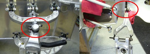

Does anyone have the specs and part numbers for the following RCR40 suspension components:
Front Upper control arm ball joint (mine have 4098 on ball joint case)
Rear lower control arm inner rod end (heim joint)
I had a search around the site but was unable to find any definitive specs. I would like to source replacements before I remove existing parts from the car.
Parts required circled on attached image.
(Fran hope you don't mind me borrowing your images)
Thanks very much for any information.
Regards
Dave

I have done a bit of measuring of what I could get to and assume that the rear ball joints are:
Bore dia 5/8" Thread size 5/8 UNF
Readily available joint in this size have a thread length of 1.562" and an overall length of 2.625" from ball centre to end. This is the one dimension unable to confirm without removing joints.
Thus I guess Aurora AM10T and AB10T or equivalents would be the right joints.
Dave
Dave Collins
Bit more research based on a comment that they are from a Chevy truck has led me to
Moog ES800883/ES800882 parts that fit a Chevy C6500. These look right but will wait for confirmation before ordering.
1-1/8 - 12 UNF-2A 5.44" Length
Dave
Dave Collins
Dave
Scrap that. Much too large. Reviewing Chevy parts lists again comes up with ES800743/ES800744 (Chevy W3500) however appears to be only joint that there are no quoted dimensions for! Probably safer to wait and see what RCR says.
