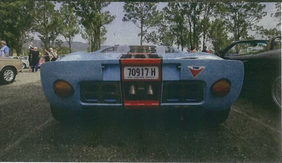

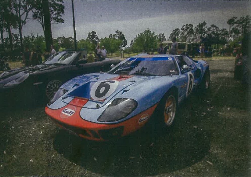

Here's a couple of pics I was sent which may jog someones memory. The car was imported into Australia so I'd guess wasn't built there. The chassis number ends in 89 so a 1989 build?

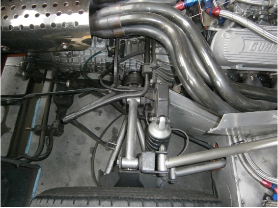

Another angle may be to get pics of parts of the car which are recognisably GTD such as the rear uprights, front wishbones and the rear chassis frame. The square cutouts in the rear clip in the second pic look odd.
The opening for the exhaust pipes and the two panels with the oval cutouts are not GTD style. Based on those I would say that it is not a GTD. More better quality photos might help in making an ID.
Mike Pass

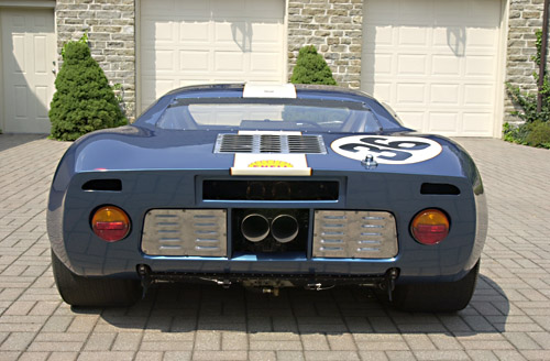

The cutouts in the rear panel for the exhausts (central) and the two cooling openings at each side look very rectangular and not like the more rounded GTD style openings with slanted outer edges. See attached pic for comparison.

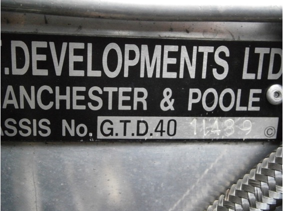

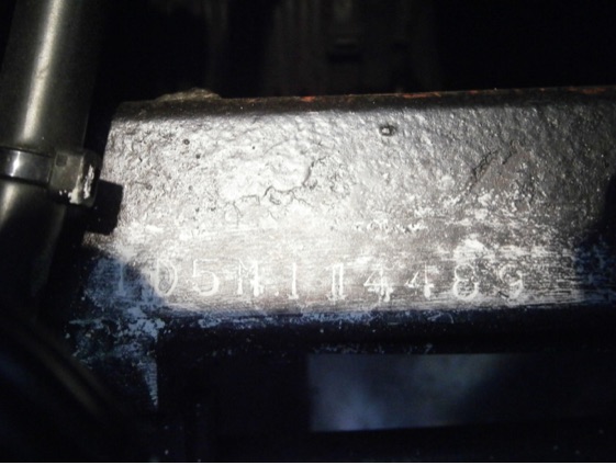

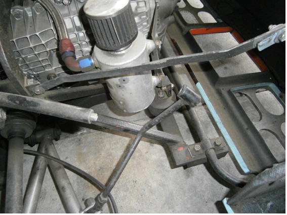

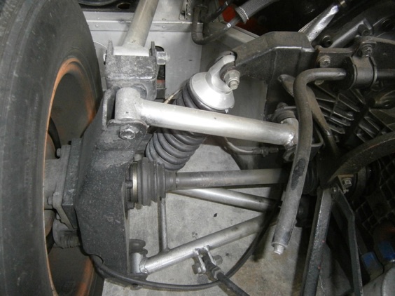

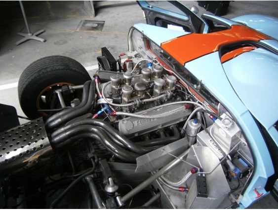

Here's a few more pics that might jog someones memory.

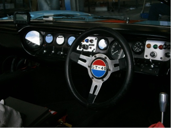

a few more...

Looking at the chassis number pictures it gets a bit confusing.
The non factory chassis plate has 11489 on it. Chassis numbers for 1989 went from 13989 to 19889. 114 should fall into 1988 so this is odd. And chassis no 11488 was possibly used for making moulds.
But then if you look closely at the picture of what appears to be the genuine GTD chassis stamps there are numbers that would appear to have been added. The effect of the number stamps varies. And critically, is there an extra 4 between the clearly stamped 4 and the 89? It would make sense if there is an extra 4 there as there is a GTD chassis record for 14489. Snag is what info I have then says it was used for a crash test!
But from the pictures posted there are many many features of GTD showing that you would not expect to see on a non GTD car and some items are non GTD but these could easily be items self built to save buying the expensive GTD parts. Not everyone bought the entire GTD kit.

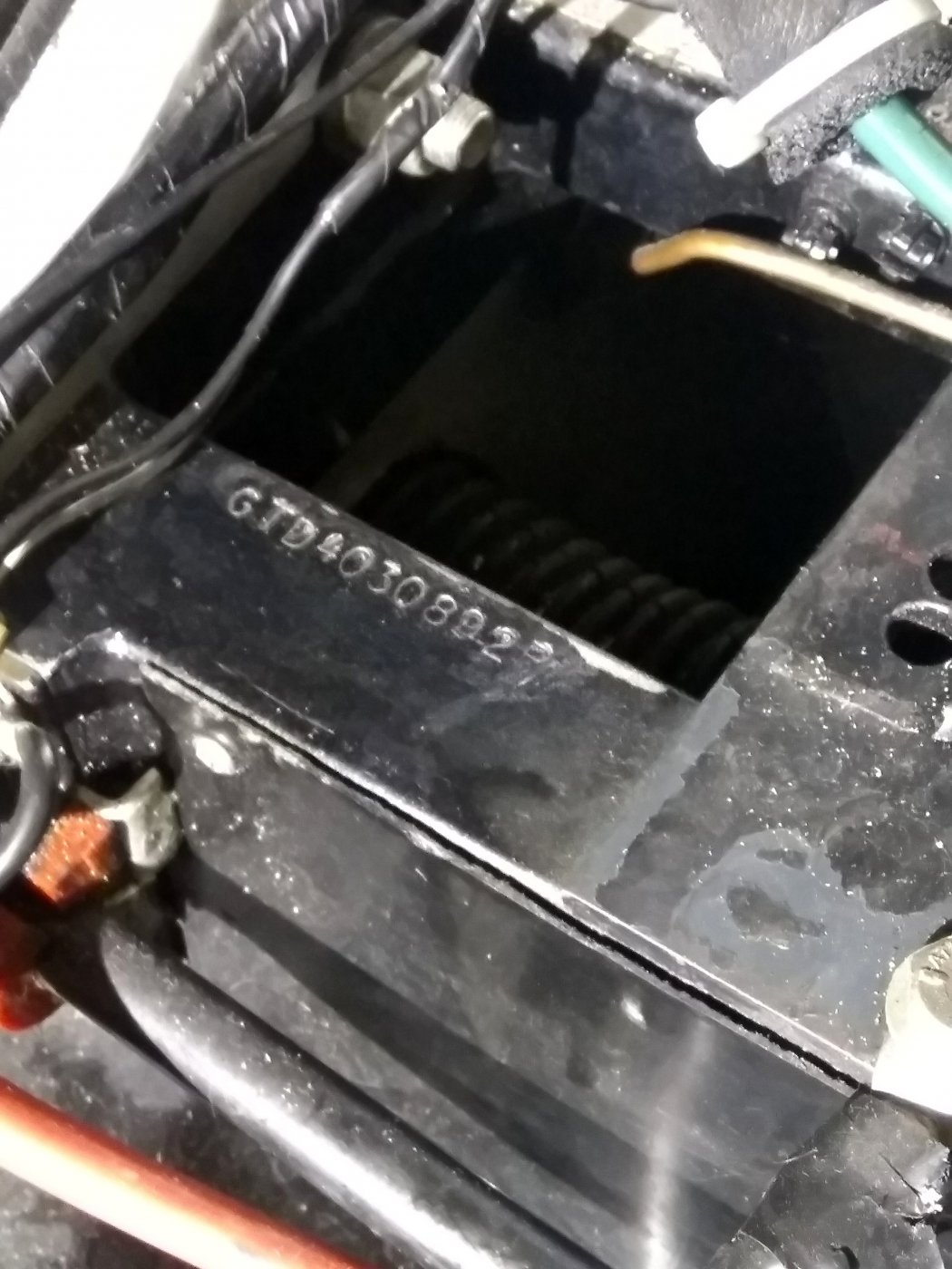

I have a late GTD with all paper from ordering exchanges. My chassis number is GTD 4030892 R
The number is cold stamped on the chassis front right side (see pic)
if GTD 40 is obvious and 92 is the building year, R probably stands for Race as it was a special lightweight model order
Question :
What means 308 code ?
