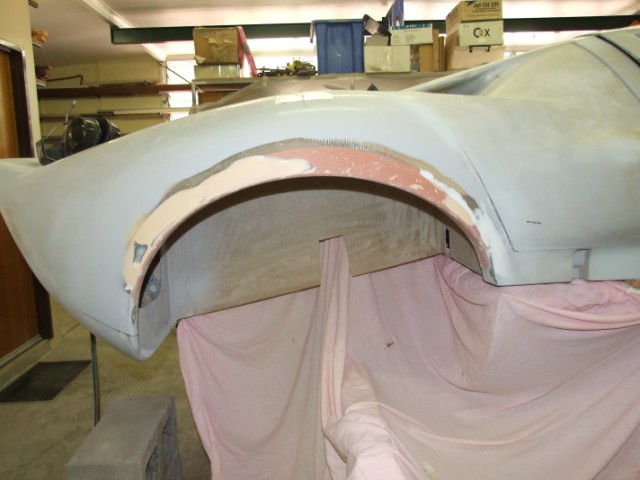

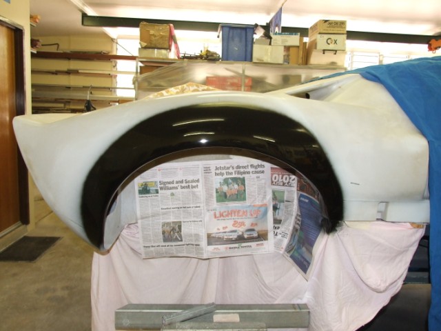

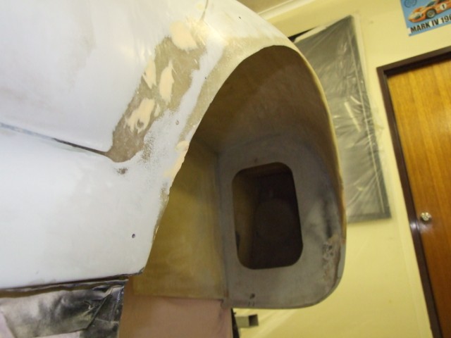

Here's a few pics of the progress.
Clayton
I'd be worried about durabilty with only filler (that thick) over foam, and that it's going to eventually show a crack along the line of the original wheel arch. I would suggest you put a layer of glass fibre matt /resin over the foam, then once it is hard get it roughly right with 36/80 grit, then put the filler over the top of the GRP to get the final finish.
Grind the surface of the original materail just above the arch back a little, so that the mat you add laps onto the original material and is far enough back so that you can restore the original contour with filler.
When sanding back a black guide coat from a rattle can helps a lot to find the lows.
Fred W B

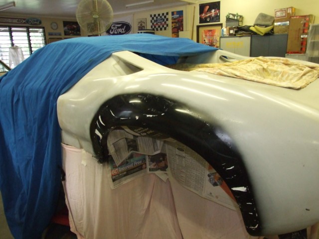

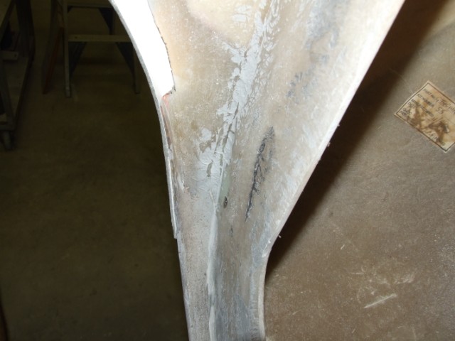

I've stuck with it and tried the suggestions above. Got it to a point that I'm happy enough to start glassing.
Clayton
Thanks Randy

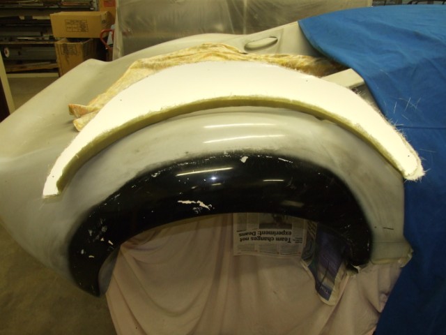

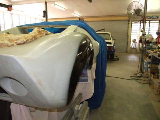

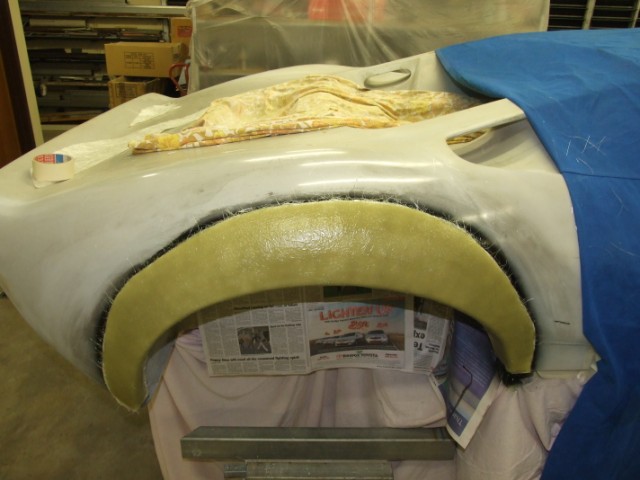

Added gel coat and mat over the last few days.
Cant wait to see if it worked .
Clayton

Looks good Clayton!
What a lot of people forget with bodywork and tidying up filler patches is that initially one should use an agressive sandpaper (80 grit, or even 40 grit in extreme circumstances) as these heavy grades don't tend to follow existing contours, which means that you will avoid just following flats and peaks, as these heavy grades will eliminate them.
If you are then heading down the route of using a high build primer, then you can finish with a 120 or 180 grit paper and the primer will easily cover the scratches.
Cheers,
Graham.

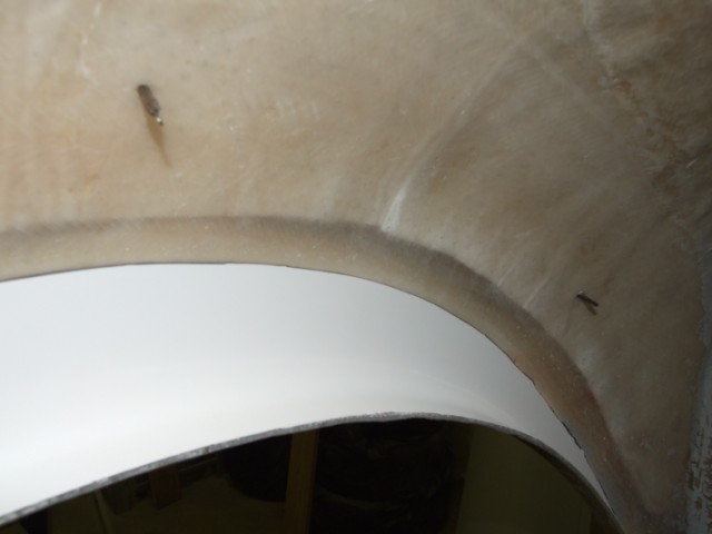

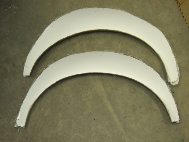

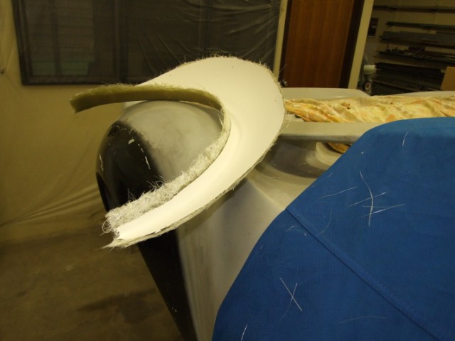

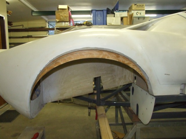

Removed the molds today, which was fun.......
Didn't turn out too bad, only had a bit of paint transfer which cleaned up easily.
Now to cut the extension off and glass in a new piece.
Clayton

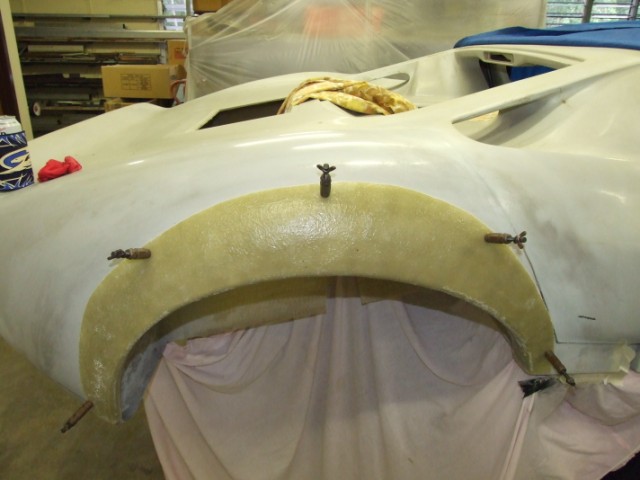

Thanks Graham

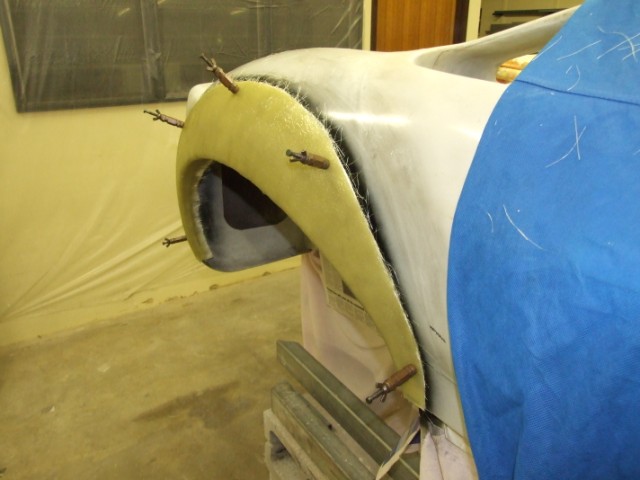

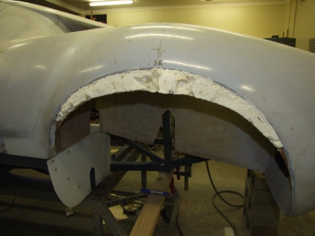

Removed the bogged section and original lip return from the clip. Ground the inside to a taper. The plan is to skin pin the mold back on the clip and lay up the glass one time.
Clayton
